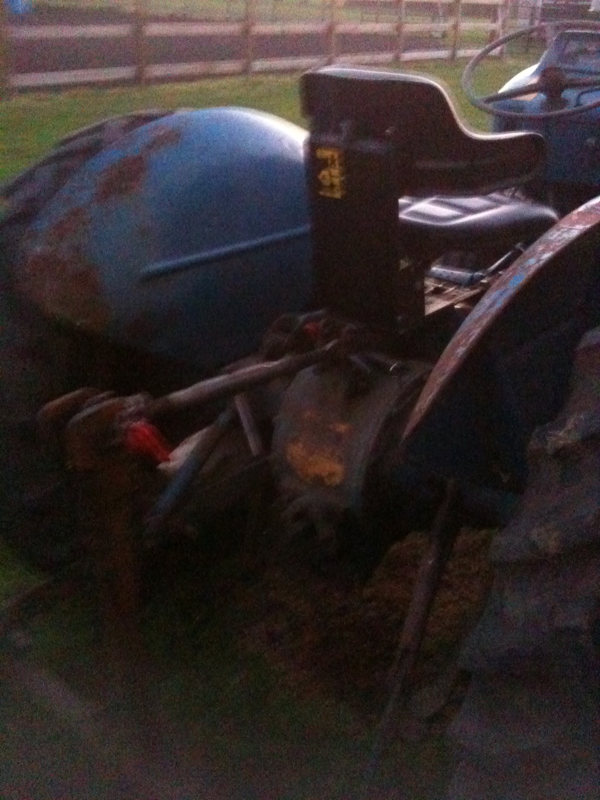

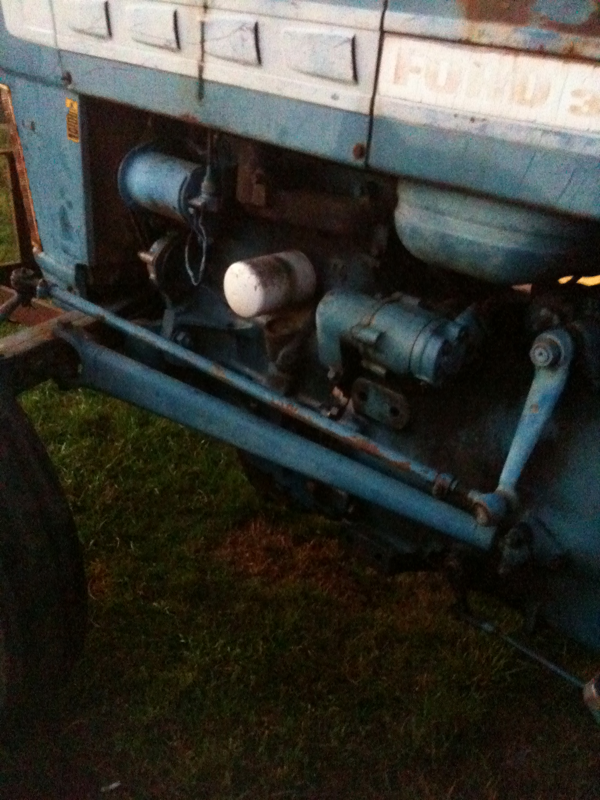

My grandfather purchased a ford 3000 new and gave it to me this year. I'm looking to rebuild the motor due to burning oil and throwing it out the muffler. And also wanting to put a power steering kit on it. Plain on using this tractor to turn a 8' vicon and haul round bales around the farm. My question is the PRODUCTION CODES, SERIAL & MODEL NUMBERS on the
Right Hand Side don't match nothing I'm seeing on the net this tractor is in good shape never sleep outside in the weather the numbers or very readable unless someone didn't stamp them all this is what they or in this order if any one can tell me what they or so I can order what I need and know a little more about this tractor.

/ Ford 3000 #19
i believe you are confusing model and serial number.
sn on the trans bellhousing will begin with an A for antwerp belgium, B for basildon england, or C for a US made one.
the Model ID number for a 3000 series will begin with a 3 if it is before a 4-1968 model, and C if it is a 4-68 or later model.
soundguy
/ Ford 3000
#20
This is a couple of pictures
