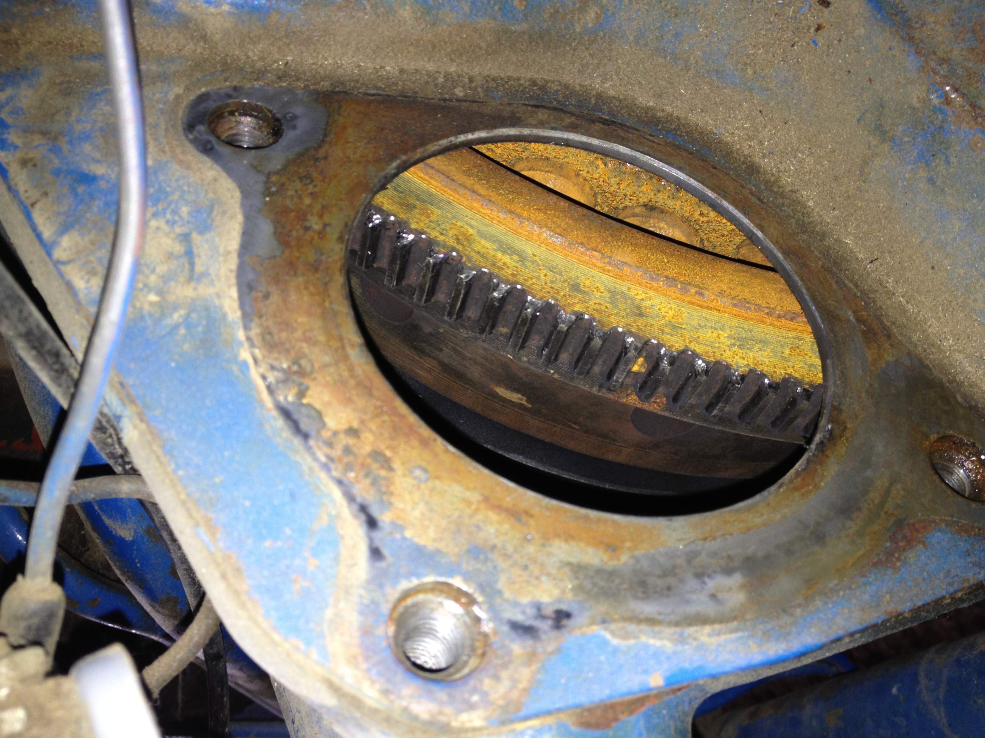

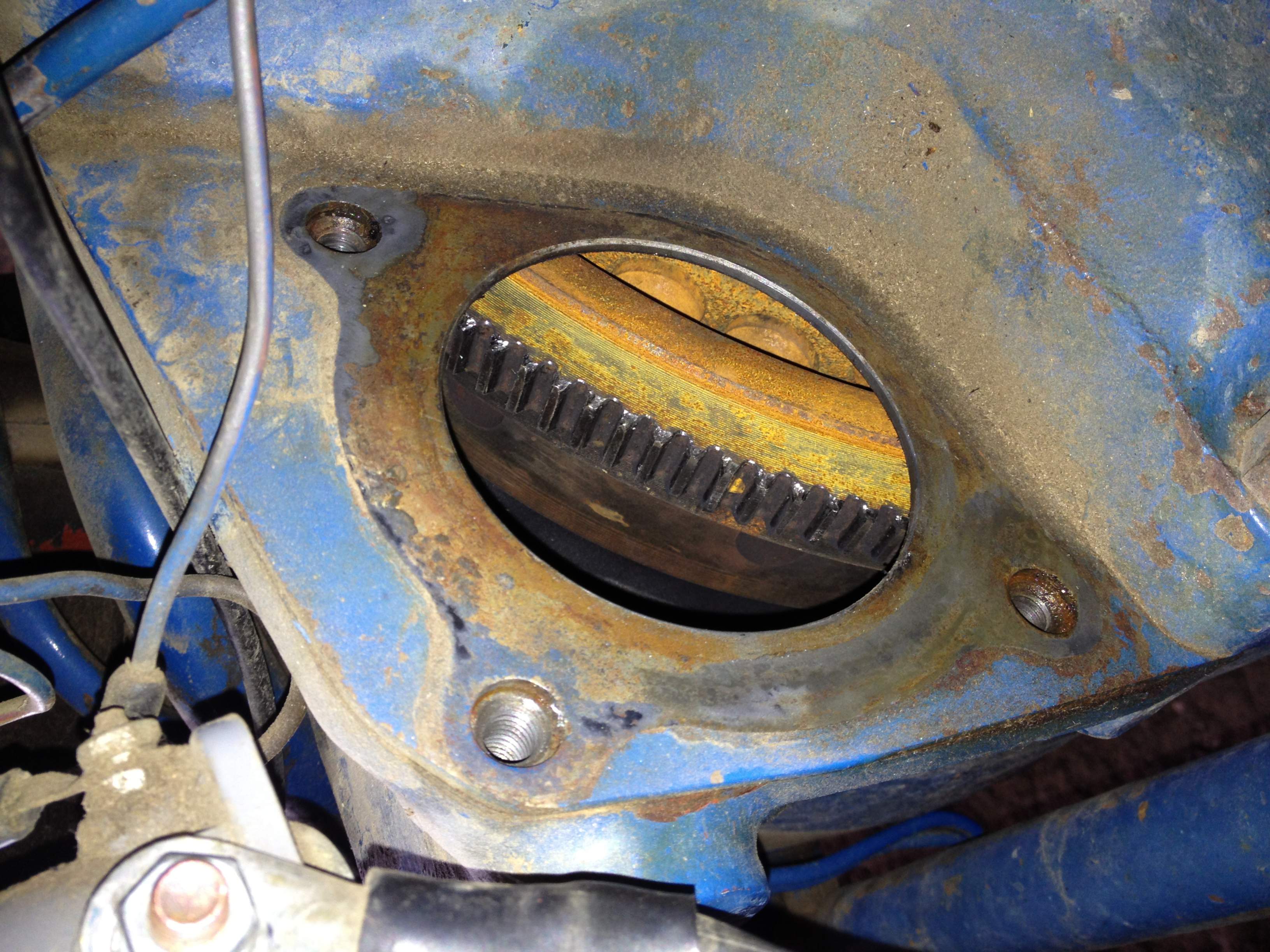

We have a '65 Ford 3000 diesel that seems to go through a starter motor about once a year.
It is used to pull the manure spreader through a stable, stopping in front of each stall to clean the stall, so the starter does get a lot of use.
However, I pulled the cover off he solenoid on the starter and it appears to be fully extending without the starter gear meshing with the ring gear.
The edges of the ring gear teeth are pretty banged up, but no other wear patter is visible on the teeth.
Could the starter "nose" be too short?
Pictures doesn't upload correctly. Seems to be upside down and distorted. Oh well.

Those teeth don't look too bad. Did you have the starter out to check the throw?
