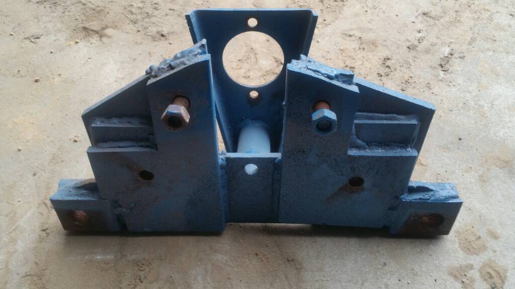

I don't have rops on the tractor nor did any come with loader.
This is pice that has me confused there are six bolt holes. The two large bolts outside left and right. Do they attach to front of axle support bracket? The other four seem to big to mount to the front.
   / Ford 3000 Loader Install #42
Looks lil that piece is for the bolster, pump in front
At least for a 2" picture it does!
   / Ford 3000 Loader Install #43

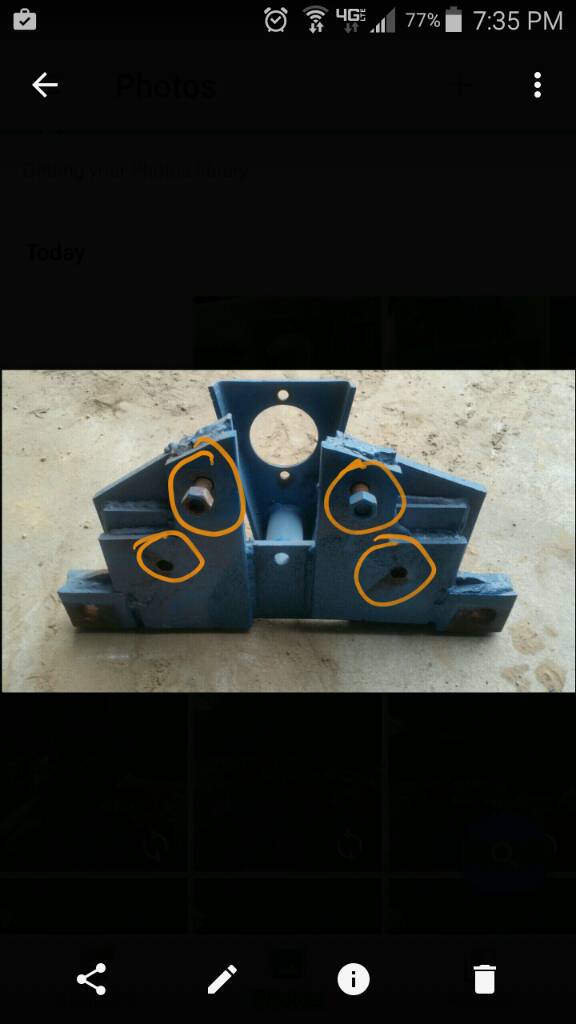

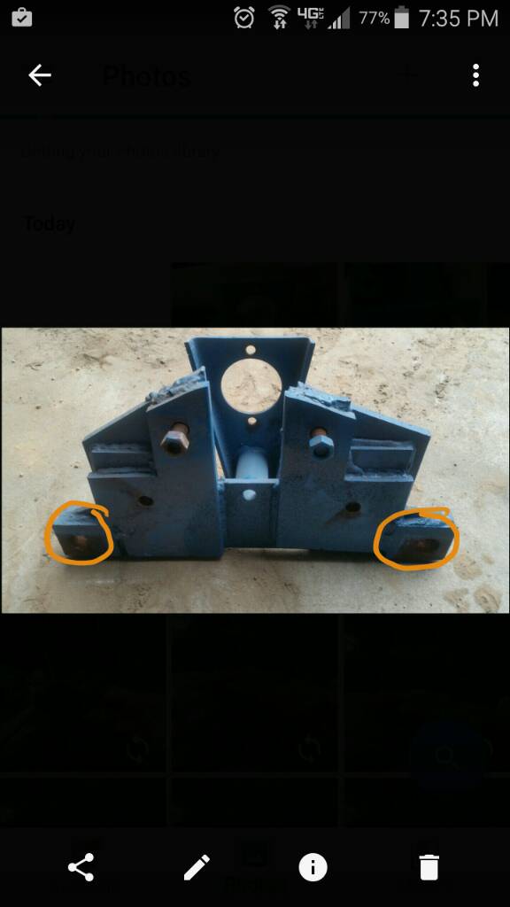

These two bolt holes do they mount on tractor somewhere, or are they just for the loader?
   / Ford 3000 Loader Install #44
The two bolts fasten the bracket to the tractor front bolster. the pump mount is in alignment with the crankshaft. The two holes with no bolts in them are where the loader attaches.
   / Ford 3000 Loader Install #45
OK that helps me a lot the bolts that came with it are too big. Can I drill and tap them?
   / Ford 3000 Loader Install #46
he bolt that came with the 720 loader are 3/4" the front axle support bracket lines up but holes are to small.
Question can I drill them to fit or will that weaken axle support bracket?
Thanks for your help and time.
   / Ford 3000 Loader Install #47
If the holes in the bracket are larger, cut son pipe or make /find bushings, and big flat washers, not wimpy 1/16" ones either
