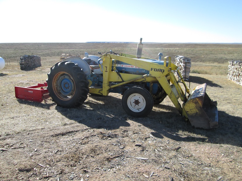

   / Ford 3000 Loader Install #27
This is a 72 ford 2000 gas with a loader on it from a 3400. I do not know if it is the 720 you are referring to. But what I have here works pretty good.
464368d1460435007-ford-3000-loader-install-img_0781-jpg
   / Ford 3000 Loader Install #28
1000# will be low for a loader, even with no subframe. I use 1-arm ford loaders and even those, with only 1 trans support, and 1 front support are rated for 1200#
