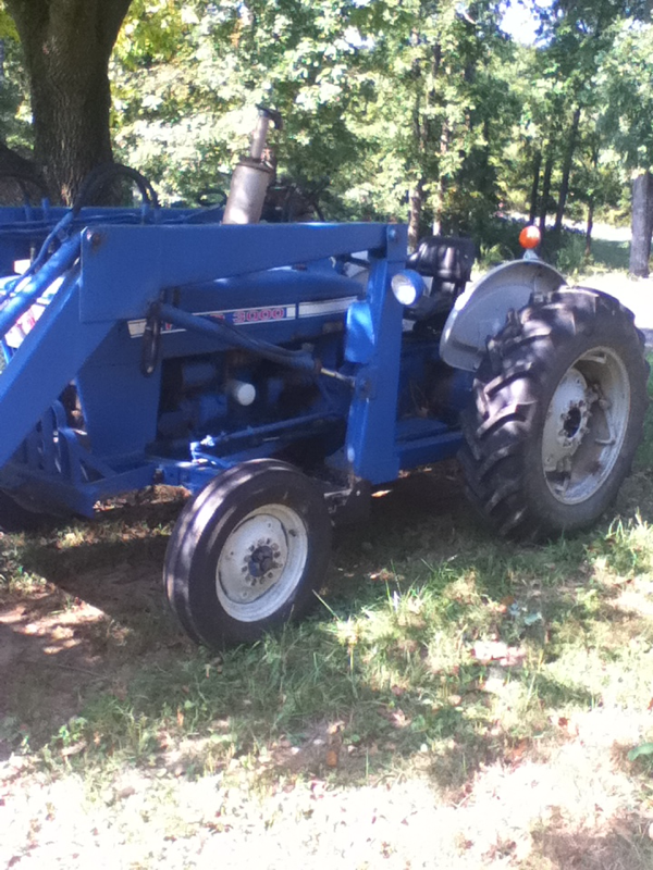

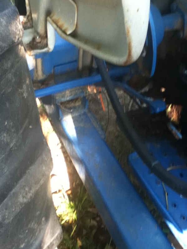

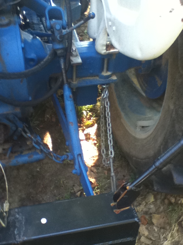

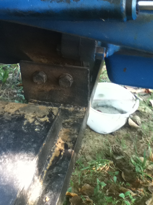

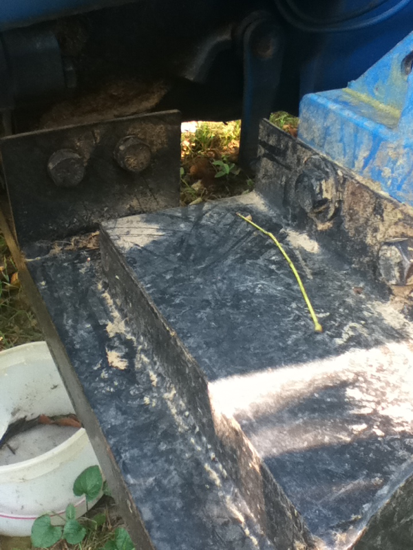

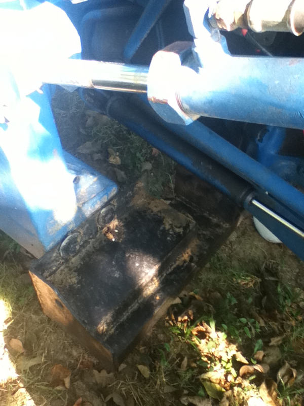

i would never put a loader of off a 5000 on a 3000 to heavy you need a arm arm bandit or a 3400 tractor and loader a 3000 front end is to light and a 3600 never had wet brakes all drum
   / Ford 3000 Loader Install #12
Not sure what model loader but it is a case. I got it from a friend who was going to take it to scape. Didn't cost much to rebuild. Never had front problems, but not making a living off this tractor either.

Oh, one more thing. I got a extra set of wheels with wider tires. Keeps the front end from rutting in the wet winters here.
