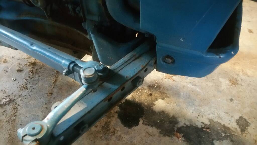

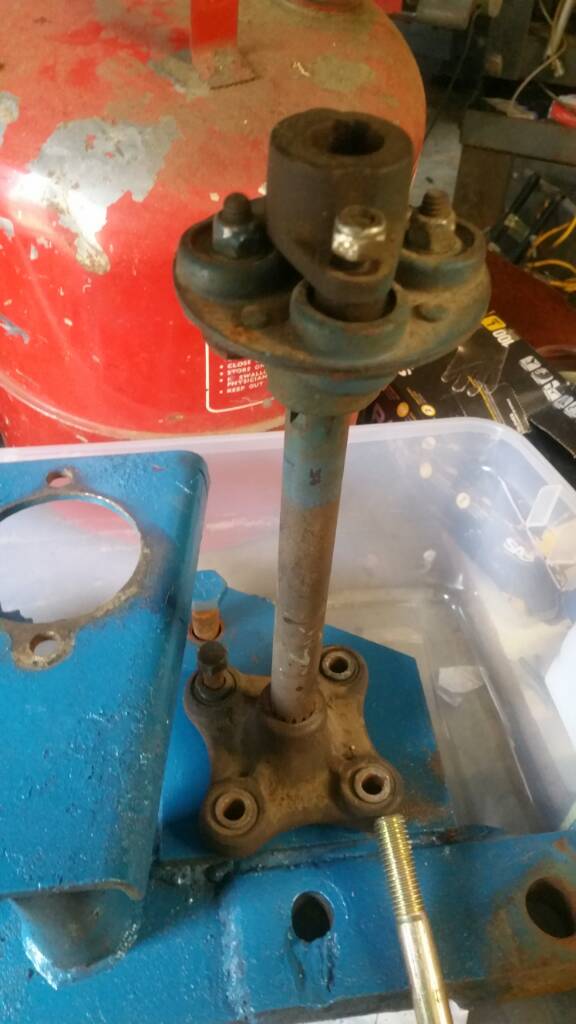

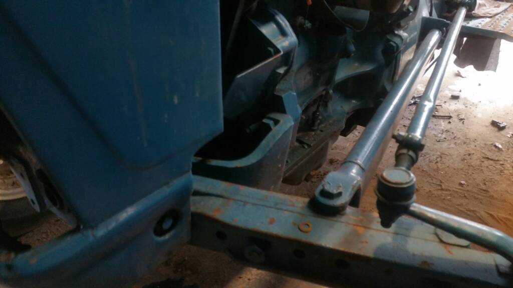

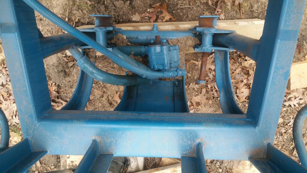

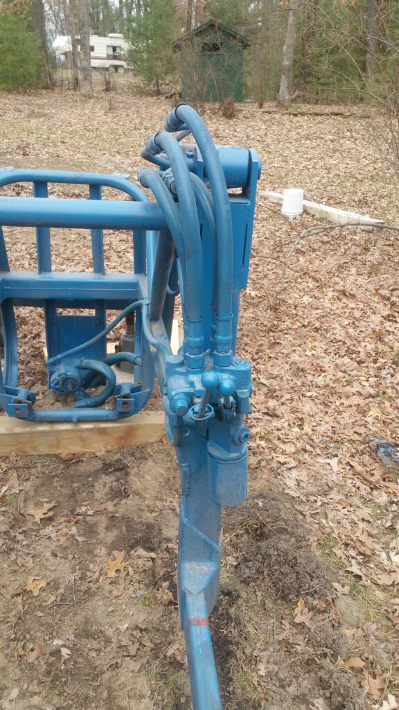

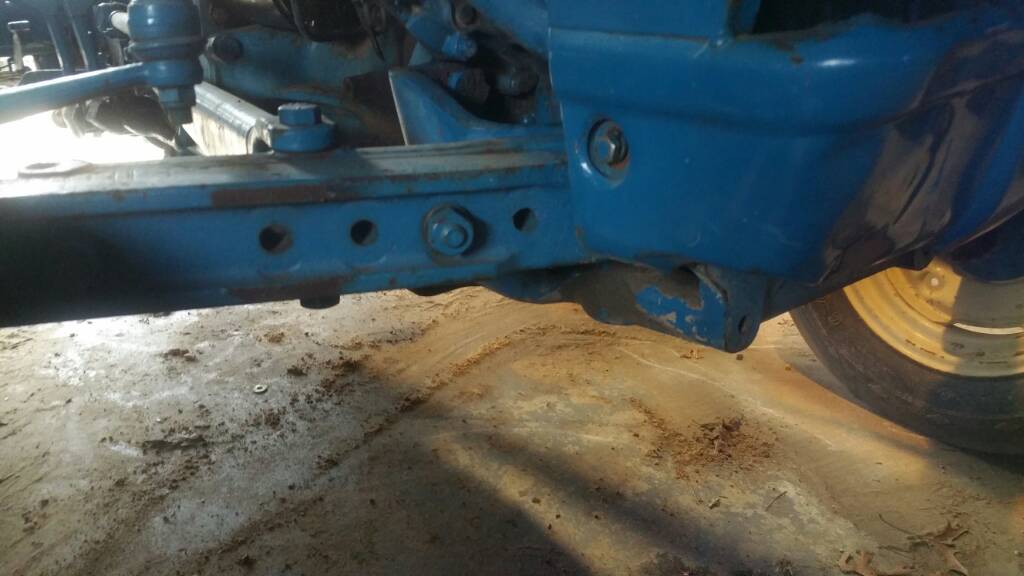

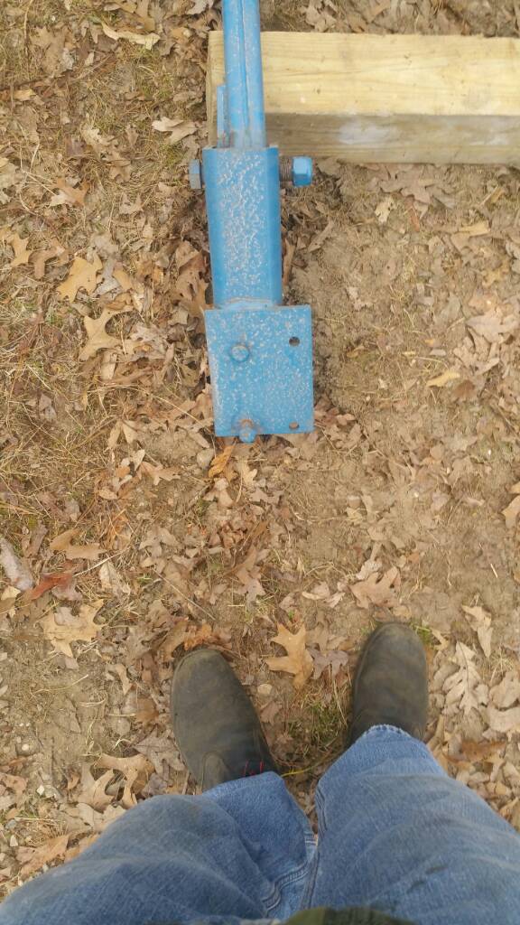

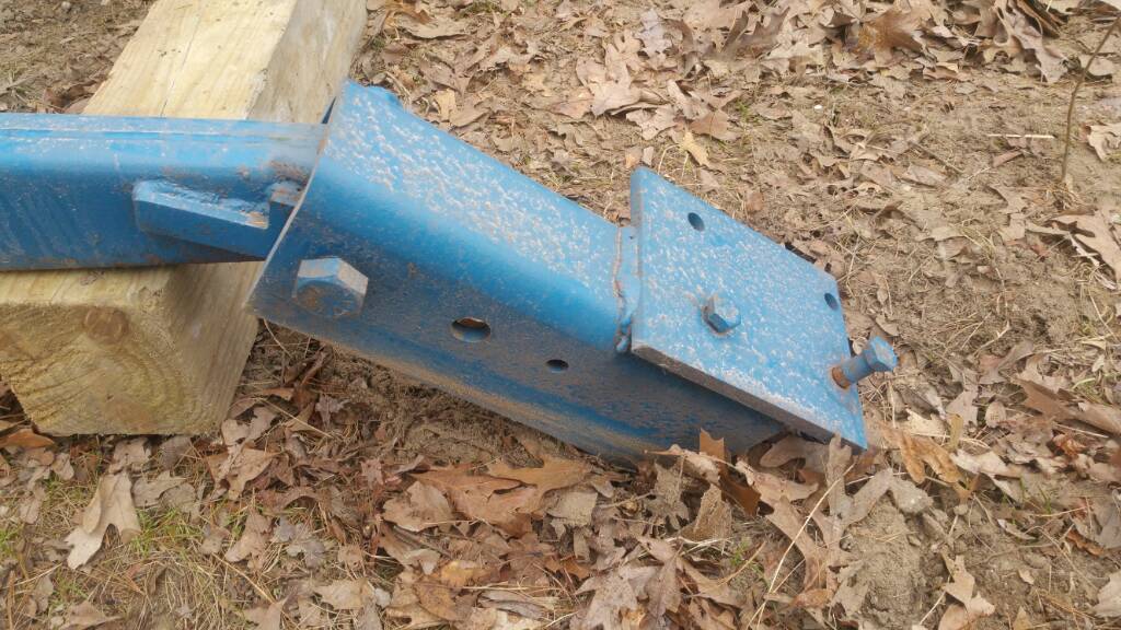

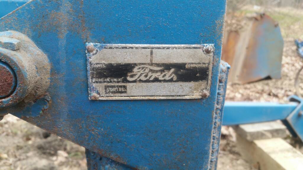

Any ideas hot to make this
work . Ford 3000 720 loader. Bolt right up but where and how. Please help
   / Ford 3000 Loader Install #34

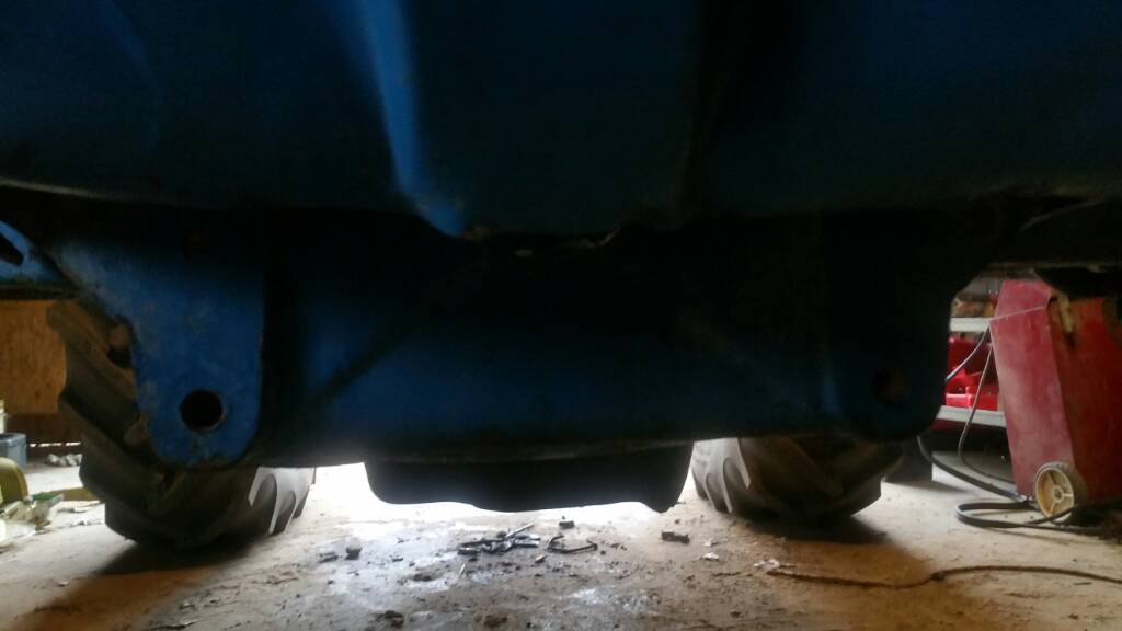

i see the front bolster mount plate.
i don't see any rear brackets
   / Ford 3000 Loader Install #36
pull back some. I browse on a phone. taking a pic of a small part with nothing around it is hard for me to see
   / Ford 3000 Loader Install #37
Does this help I am not home right now. Can you describe what part should look like?
   / Ford 3000 Loader Install #38
if it is a rear bracket that bolts to the axle, it will usually have a tie plate, though if the machine had rops, the top of the rops is the tie plate.
if that part is inline to bolt with the rear axle and you have a tie plate or rops, then it's just a matter of bolts.
   / Ford 3000 Loader Install #39
Got you I don't belive I have the tie plates. I thought the rear brackets mount under axle through fender bolts holes. Could I make tie plates? My biggest issue is the front end. I have looked but can't figure out how it bolts up or mounts.
   / Ford 3000 Loader Install #40
tie plates are nothing... if it has rops.. those are the plates.
