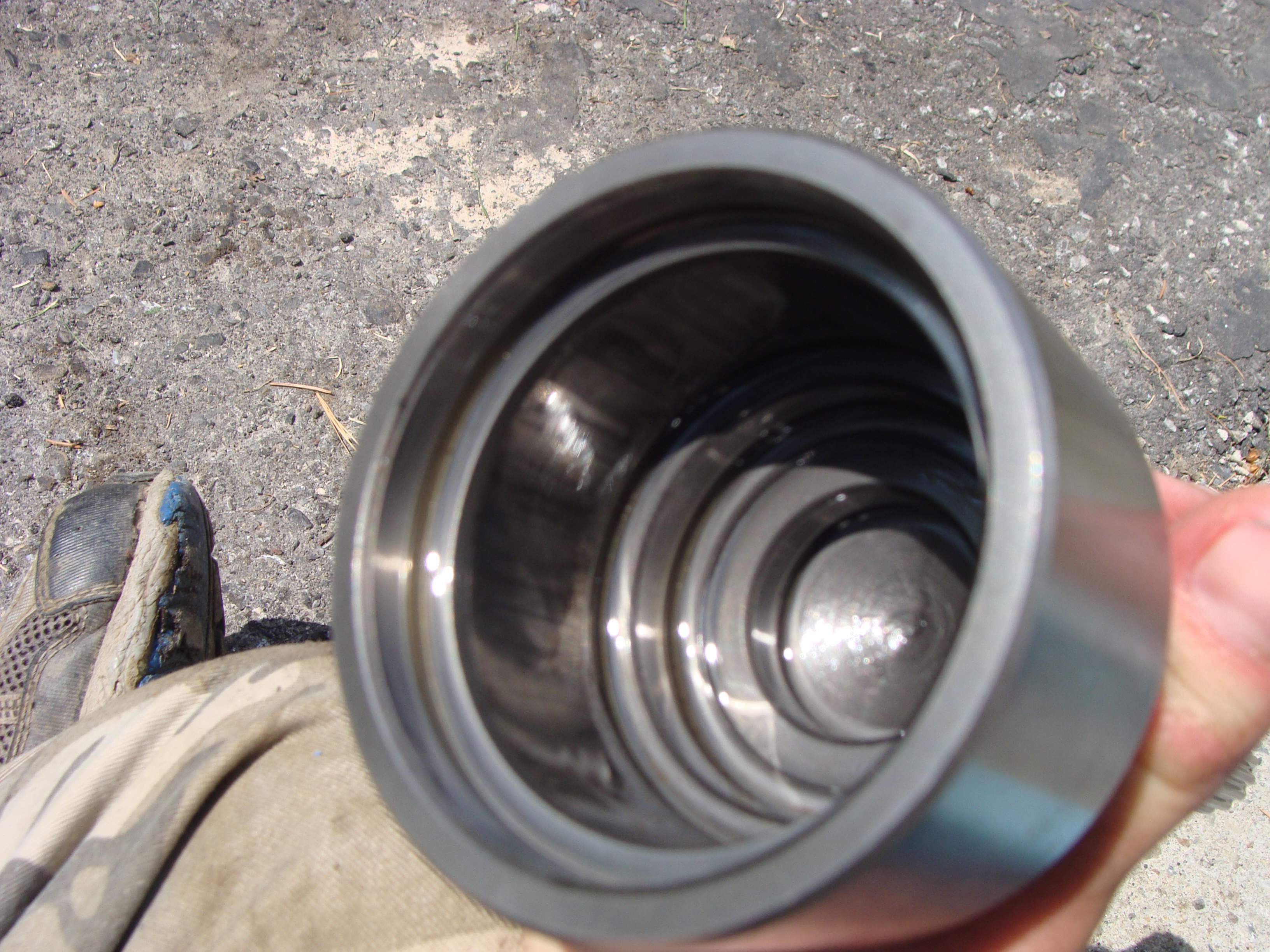

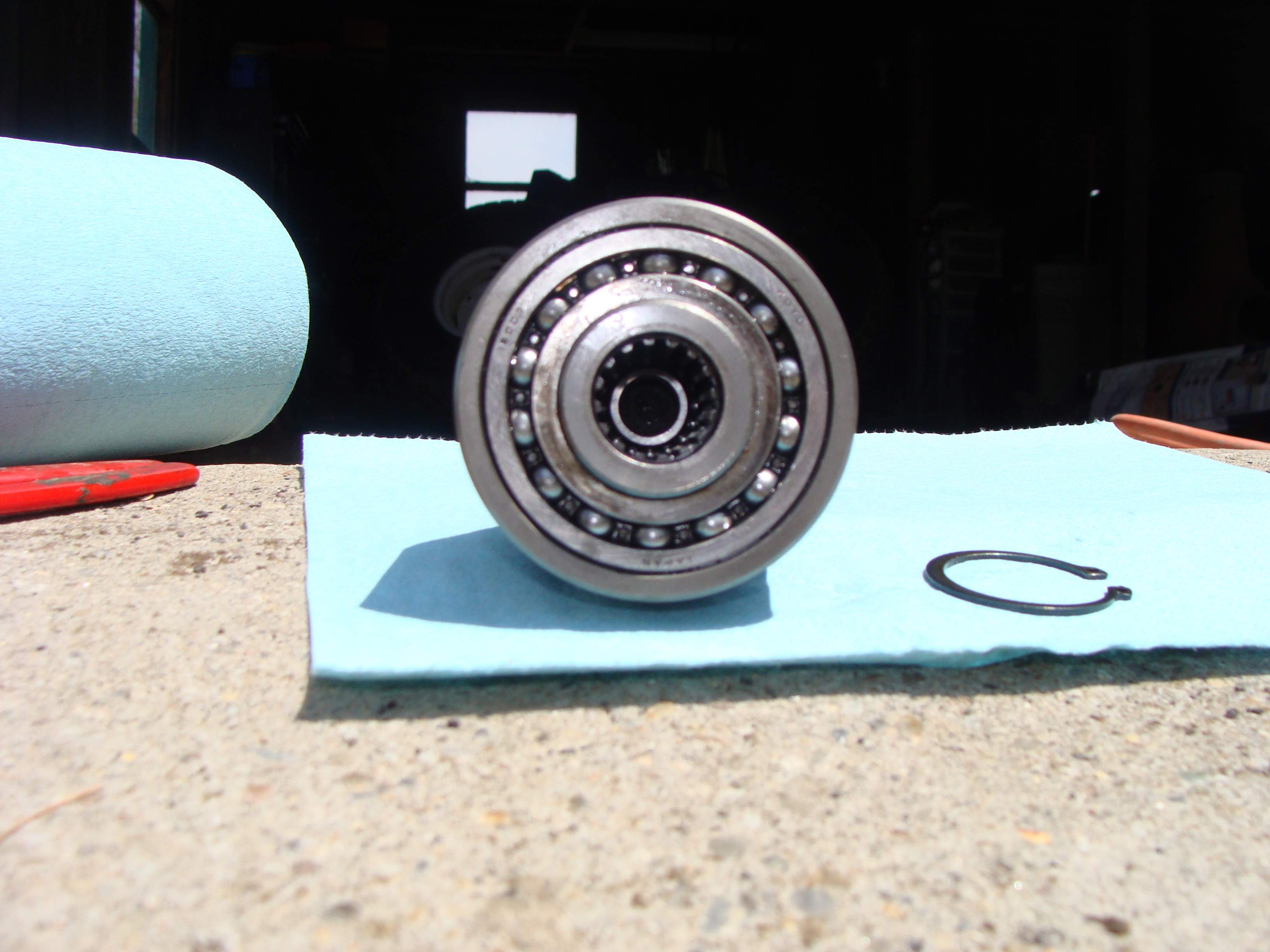

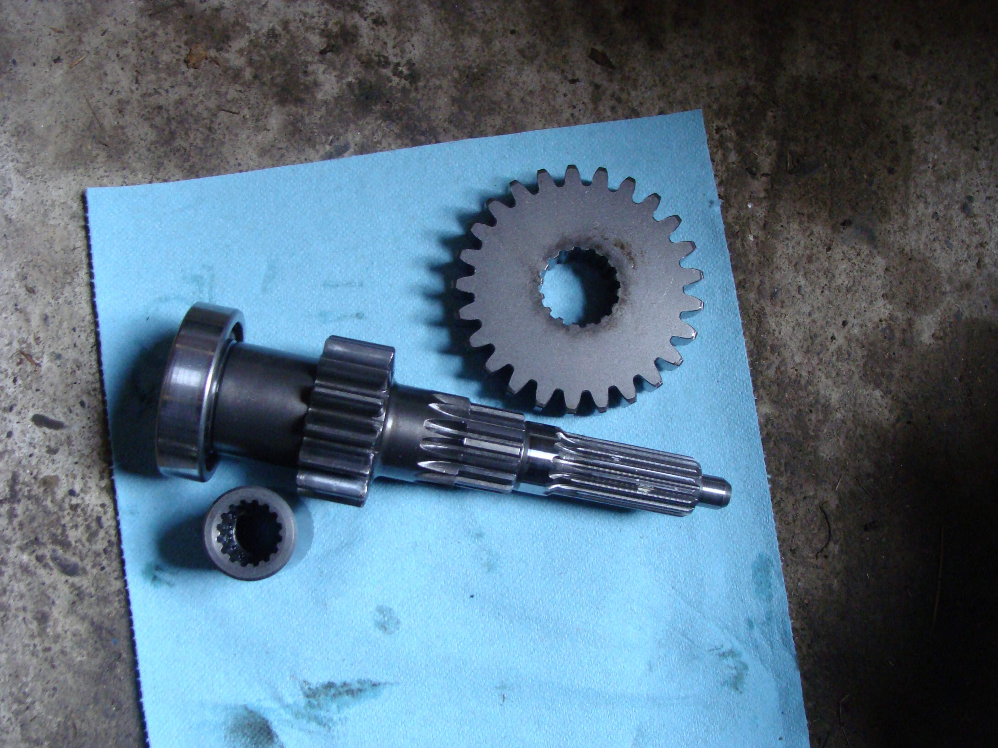

Got the orc out, this is a picture of the orc and the updated shaft that is driven by it. The updated shaft goes through the inner race and is supported by two bearings inside the outer race.

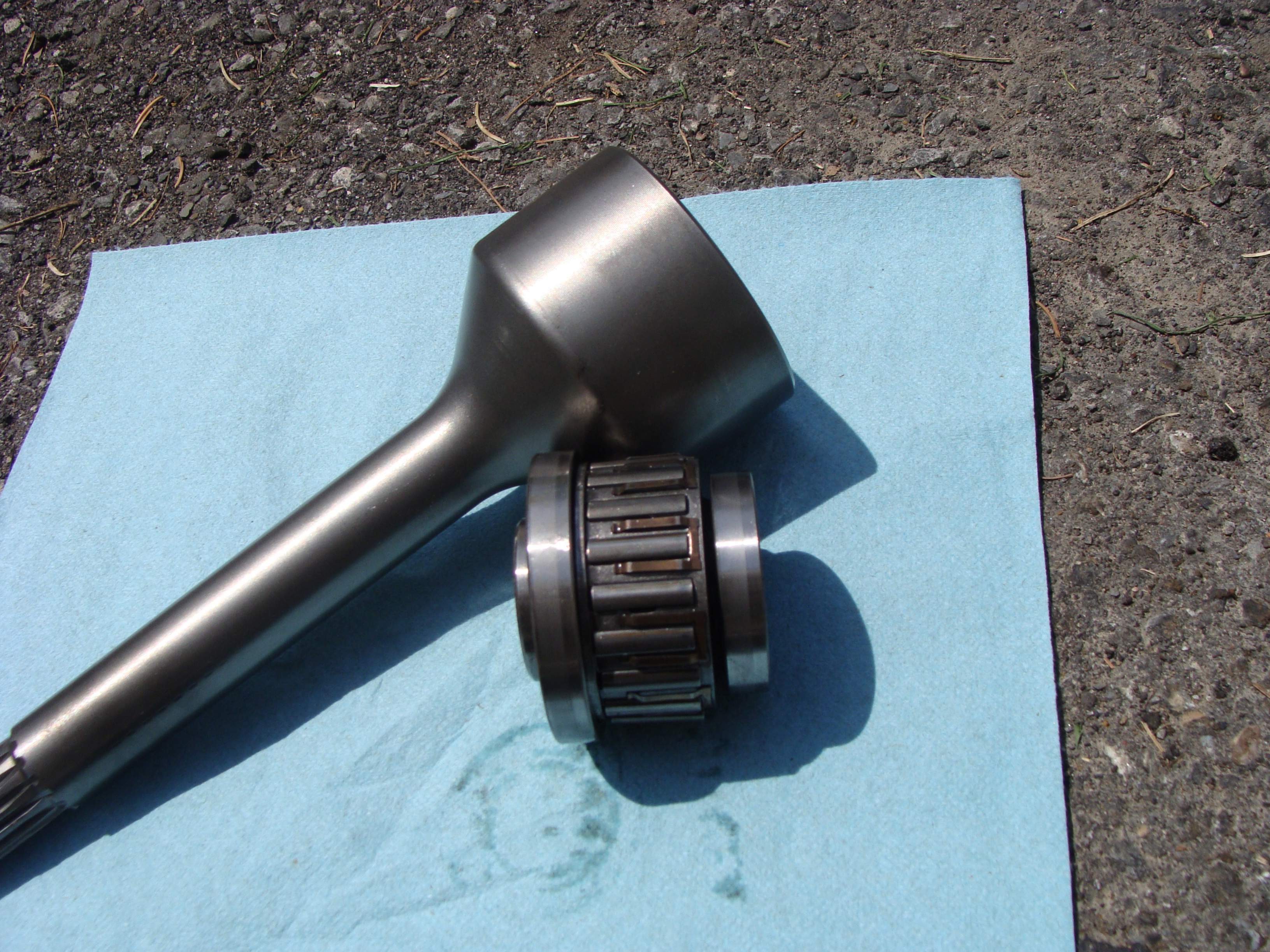

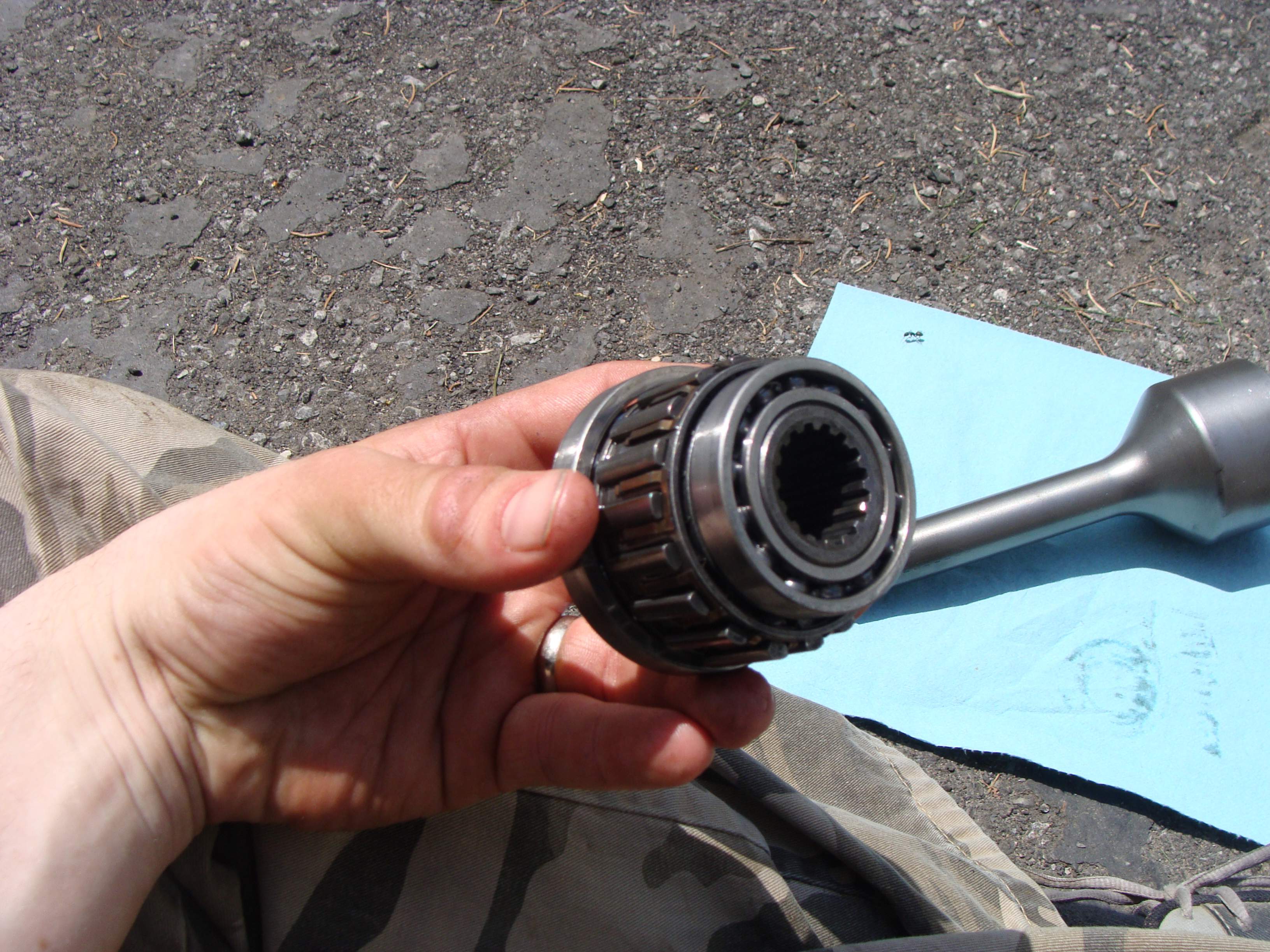

This is a picture of the orc disassembled, there is some discoloration on the sprags, looks to me like rust? In the third picture you can see the inside of the outer race, and the places where the additional bearings go.
