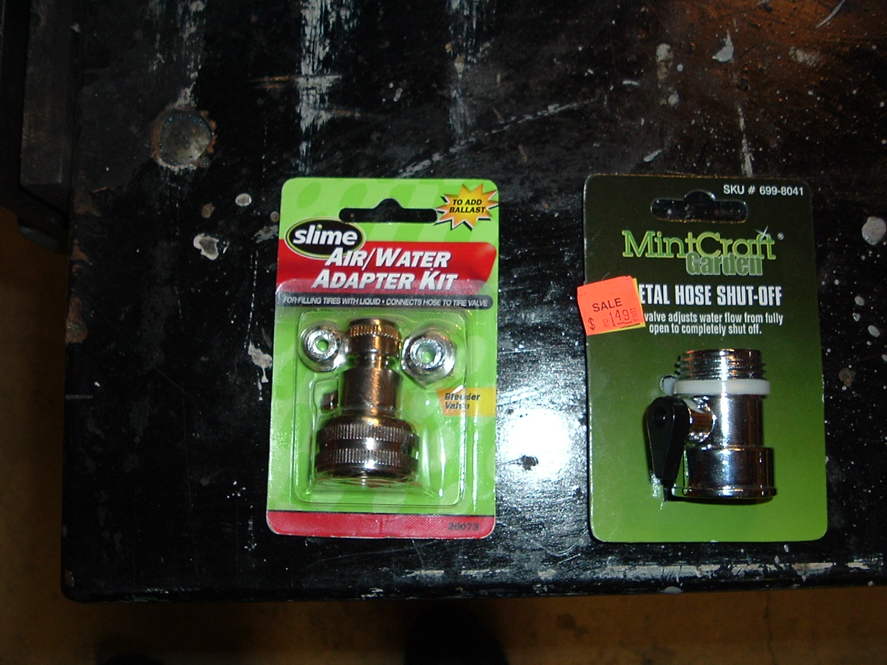

I filled mine with RV anti-freeze.. here is the valve..it has a "burp" button so as the pressure in the tire increases as you pump in the fluid you can lower the air pressure about every 3 gallons or so by burping the tire. I used one of those cheap junky drill pumps from home depot.. It is junk but it lasted enough to do my tires. So you need some hose pieces, a bucket to draw from, a pump and this fill valve. I used the hose shut off valve in line too, as I was worried about losing the prime on the drill pump as I burped the tire, I was afraid the liquid already in the hose would run backward into the bucket thru the drill pump so I closed the hose valve first, then burped the tire and reopened the hose valve and started pumping again.
