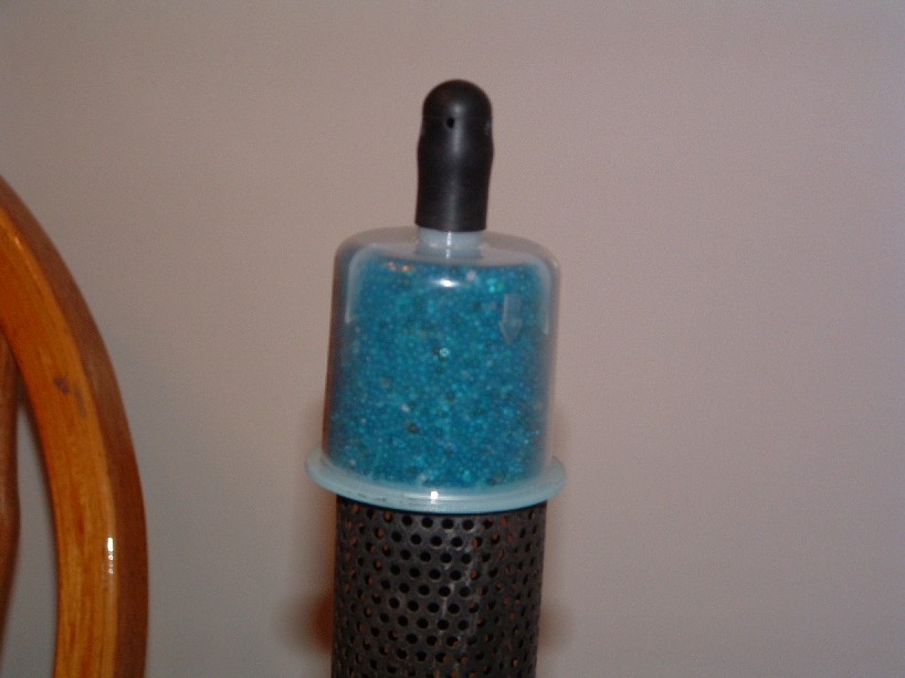

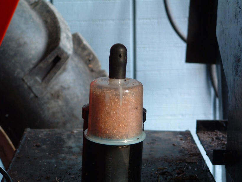

Red55 said:
Thanks Ronmar- Too early for me to switch to synthetic hydraulic but is that any better with moisture being absorbed. I do remember about someone posting about using a gas filter to keep dirt out of the system. Did you post about your filter? Thanks Ed
I probably did a long time ago. I originally used an inline airline dessicant filter. Painters sometimes use them between compressor and spray gun to remove moisture from the airline. I got the first one for only a few bucks, but these turned out to be fairly expensive to replace and not easy to renew the dessicant.
In addition to the filter element keeping the dirt out, the ones I make cost about $3(I already had the dessicant) and are quite easy to renew the dessicant in. Here are before(pink/moisture saturated) and after(blue/dry) pics of one of them
