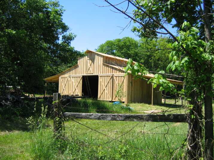

Our new pole barn is just about finished. We had 10' lean-tos added to both sides. Plan to park implements. Should I leave the sod or haul in gravel? If gravel, is there a good size for this application?

I asked the builder and he said that he would remove the sod and put down a gravel mix - all as part of the package. The builder has been great. Should be finished in a week.

ihfarm, looks nice ,yeah gravel would probably be my choice as well....maybe larger than 3/4" though to keep it put.
nice barn /forums/images/graemlins/smile.gif
