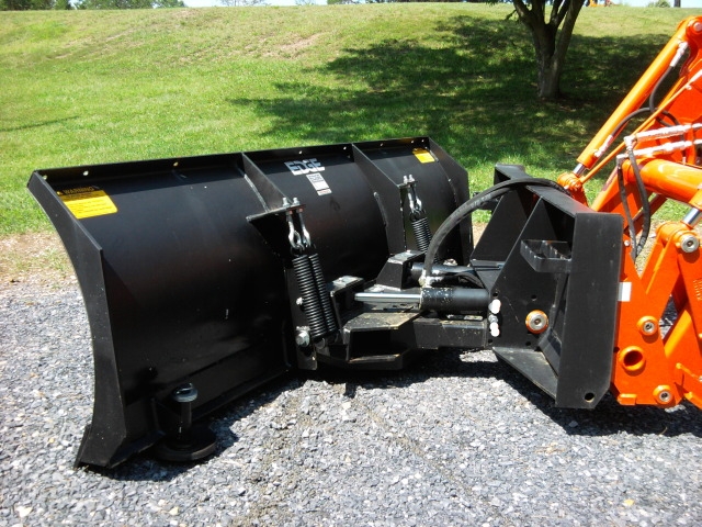

I would still be worried about damaging something.
If you catch something with the plow, and there is no resistance in the curl cylinders, I see it pushing the loader or front of the tractor up in the air, kinda like you driving up over your plow...
I also have my doubts as to its effectiveness. IT seems that when you are plowing and it does "better" when you take it out of float and bump it up a tad, that you have way more than just the weight of the loader arms on the front axle. You are actually lifting a little weight off the plow. And if you make curl float, the only weight you are keeping is the loader arms, which I think would be minimal. But I could be wrong.
And its hard to tell in the picture, but is the a-frame welded to the QA plate?? or is it bolted on with those 4 bolts??
If it is bolted, It dont look like it would be that hard to make it pin on with just one larger bolt (or pin) and make it pivot there, and then use a chain. (like a truck mounted plow)

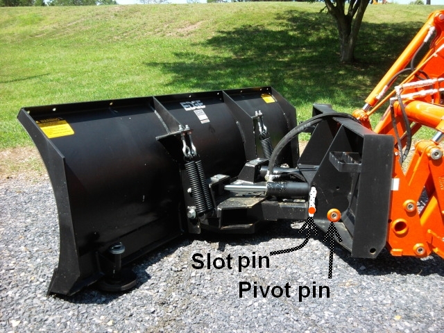

I thought of that also, but Roger said he didn't want to modify it, would sell it and get a truck mount instead.
Cut a slot where the front bolts are and put a big pivot pin at the back, like this.

I got the blade out and cleaned it up to take some pictures to try to sell but now IDK if I want to get rid of it:confused2: I found a truck plow that would be a good candidate for a FEL conversion but this plow is nicer/ more heavy duty.
The plow has a adjustment at the quick attach. I am thinking about moving it down to the bottom set of holes, drilling a hole where the orange circle is and remove the bolts so it will float. Since the pin would only be going through the QA and the plow frame I would need to add a bracket to make a clevis like hook up to keep the pin from having slop and wobbling around. I can add a chain to keep it from falling when I raise it.

Yep, that just may work out.
You'd also have to keep an eye out for those cylinder's,
to ensure they don't hit that 'top' plate when the plow lifts.
I wonder if you could add a "lift" cylinder instead of a chain.
Have a separate control for, with float. Just a thought , if you wanted to go all out.
I think the pivot pin needs to be back as far as possible, like this.

That top plate is not part of the QA so it will move with the cylinders. I could add a cylinder but I would need a divertor to run it. I have a idea how I can quickly make it so I can have down pressure if I need it.
From post #22
Why do you think the pivot needs to be farther back?
I was thinking with this method if it did not work out it would not be modified much to effect the resale value.
/ Float for curl function #40
I build things using the TLAR School of Engineering method. (That Looks About Right) :D
With a longer pivot arm, the vertical blade angle will change less as it floats up and down. But your shorter pivot point would still work okay. You could put it close to the bolt holes and be able to put the bolts back in with the pivot pin still in place.
