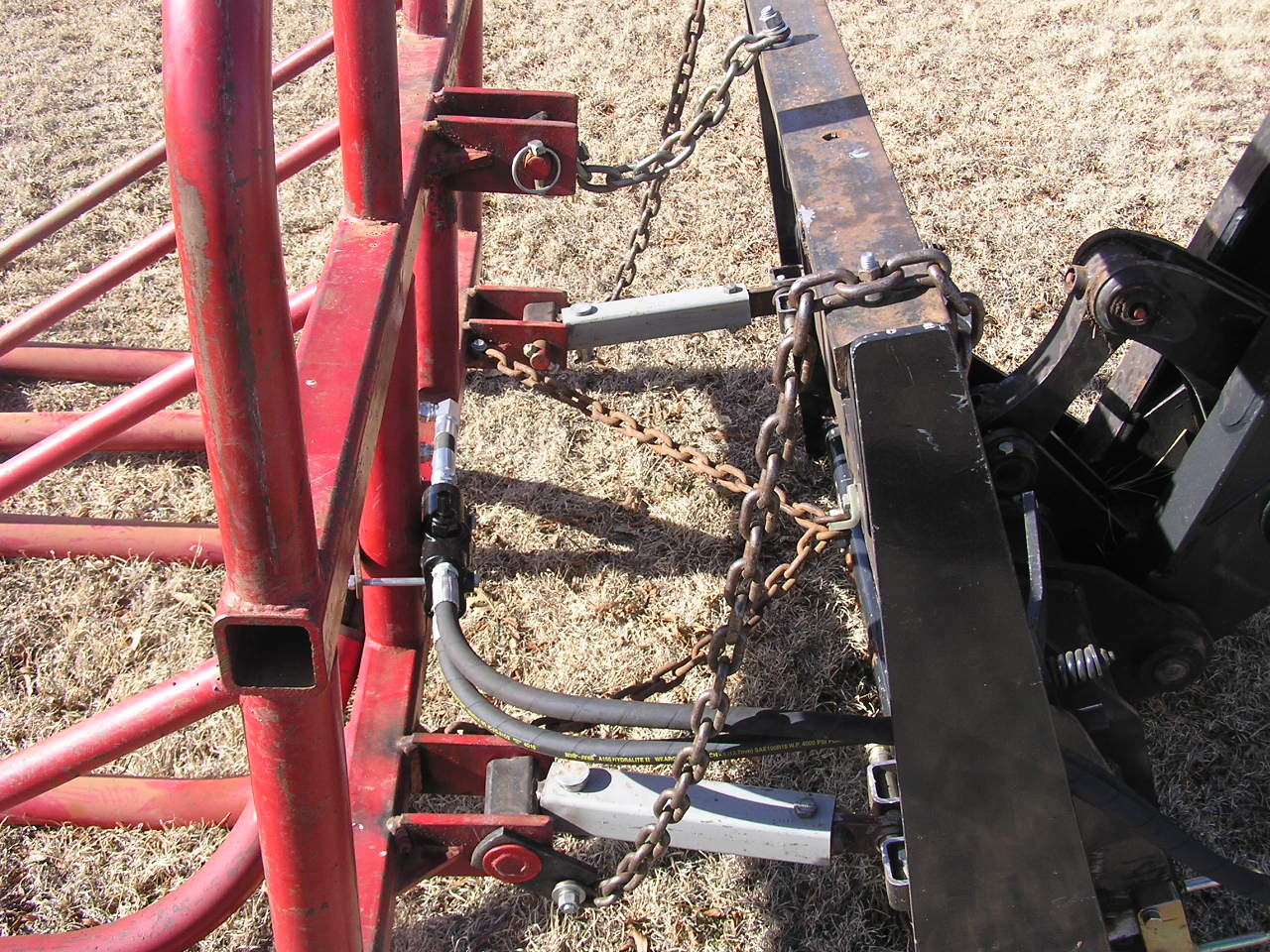

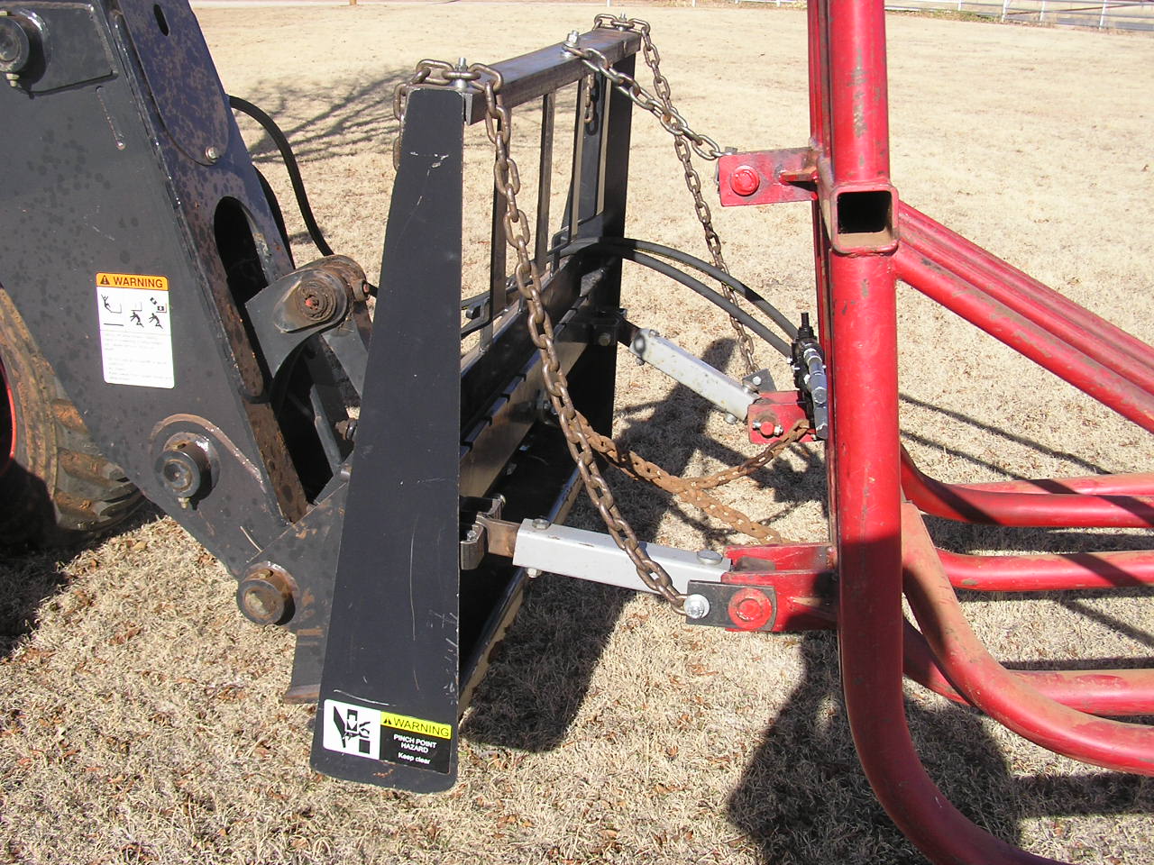

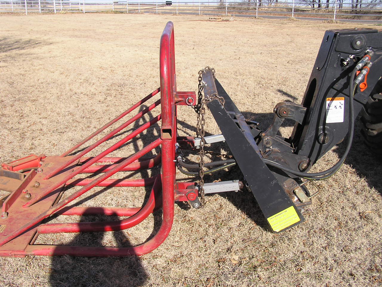

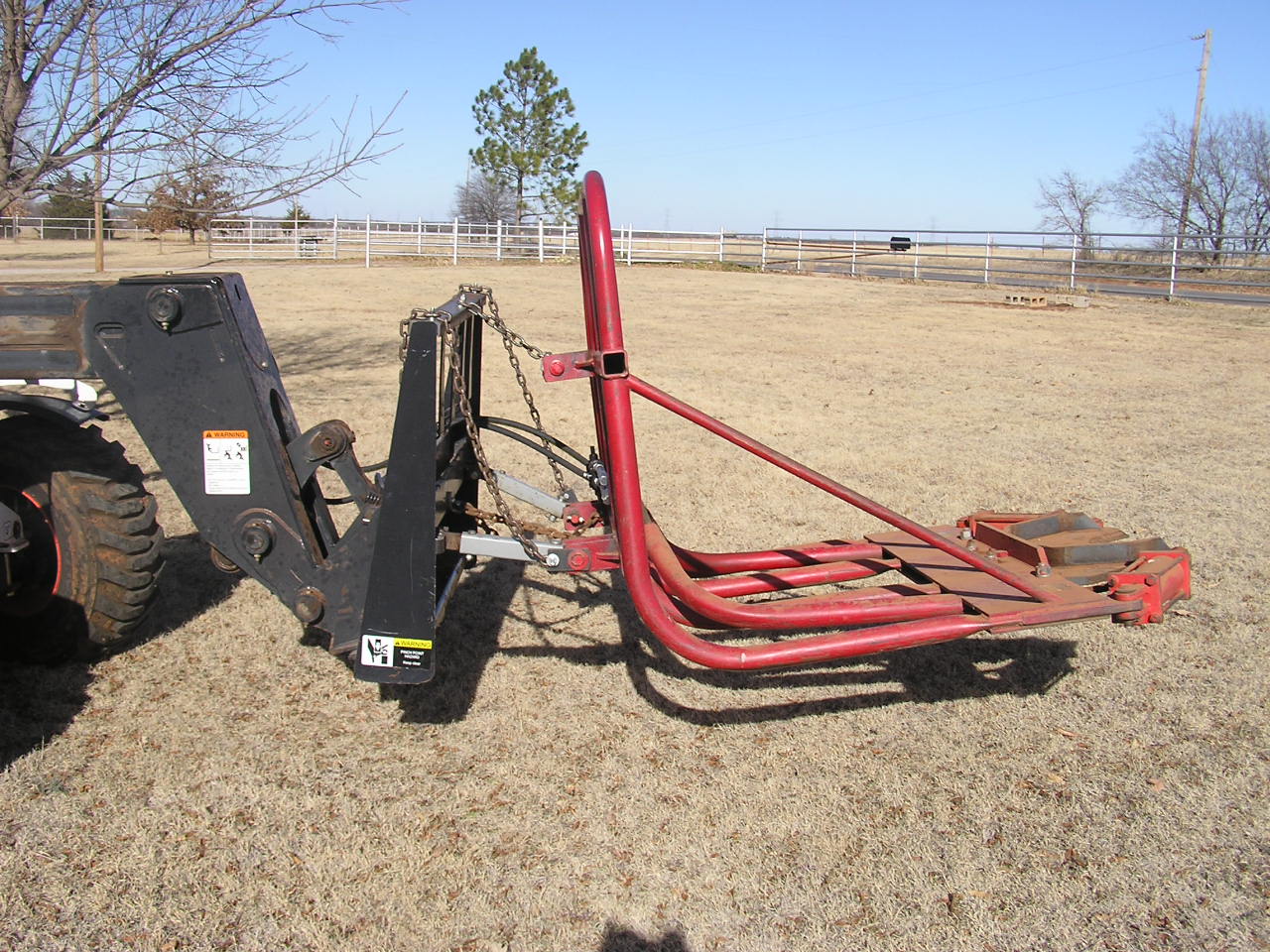

How is it mounted? Is there any way to incorporate a mechanical float with slots where there are holes, or replace a link with a chain?
I made this adapter to use a 3 point cedar tree shear on a SSQA. It can move in all directions to match the contour of the ground no matter what angle the V417 is on. The toplink is a chain.
