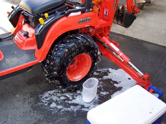

Ok, here goes first flat on the bota, and I took some photos.
here it is flat on the bottom, well almost anyway

So out to the wash area and some soapy water to find the leak. At least the tire is clean now!

At last, so far this is the only leak I can find. Now if I can find one of those valve stem wrenches.............NO luck, small screwdriver and tighten it that way............so far so good.

Danny,
A good auto store that sells tire repair tools, or a bicycle shop. I have a couple that came with a Camel patch kit. What I use is a valve stem cap with the split at the top.Those caps were on old english racer bikes.I put one on all my sets of wheels.Anything that has air tires around here has one of those split tip caps.

Must have been it, tire is still up and holding

Danny...... if you are going to use the impact wrench, it is better to leave the weight on the tire first to loosen them. That way, the impacts are directed at the bolt heads and none is absorbed by the wheel. I have found this to be true many times when trying to get wheels off. I suggest that you consider removing the lug bolts one at a time and painting them with never seize and reinstalling and setting them with a manual torque wrench. My bet is the dealer put them on with a impact wrench with 150 PSI setting. If your impact gun won't touch them, then it is time to break out the 4 way tire wrench and the 2" x 5' iron pipe. Never force it.... get better leverage... /forums/images/graemlins/grin.gif /forums/images/graemlins/grin.gif /forums/images/graemlins/grin.gif

Many times you will need to break out the braker bar, and "cheeter" pipe. You will almost always be able to put more forse on a breaker bar, then an impact will have.
