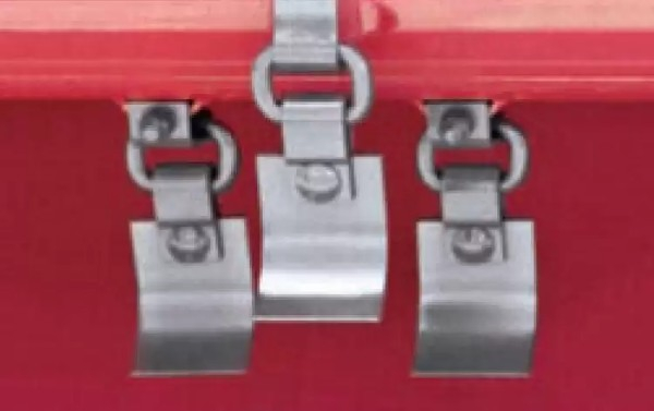

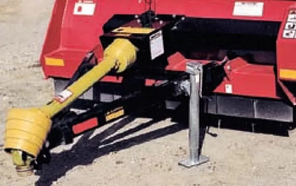

For your mule you should choose the Hiniker model 5700 6-foot flail shredder for your use.
If the tow bar is adjustable to the far left or right the Hiniker flail crop shredder will fill your needs.
It has a CV PTO SHAFT which allows for tight turns, manually adjustable mower height as standard
equipment or hydraulically adjustable mower height as an option, flail cup knives mounted on short
chains which reduce's the chance of damaging the flail mower rotor and it has a parking stand.
