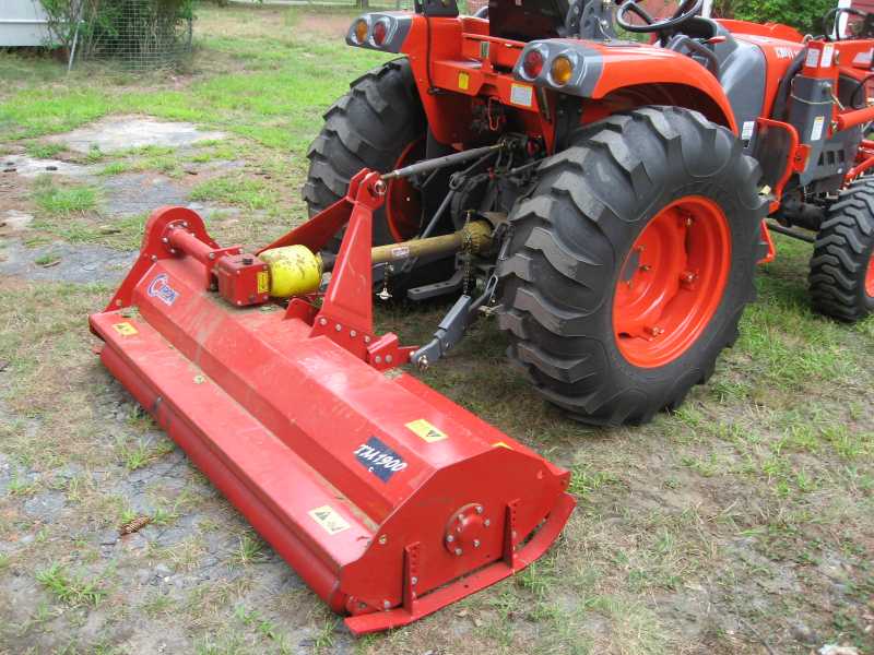

I like my Caroni flail a lot. I'd do it again no question. It cuts well, is tough and as you mentioned is safer around people. You can take it into places you'd never take a finish mower and it cuts much more cleanly than a bush hog. I have the TM1900 which is geared more towards pasture use so I'm sure the TL series will give an even finer cut.
