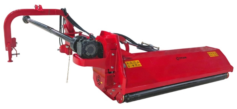

I’ve got the Titan 86” offset flail mower. Parts can be an issue as everything is coming from China, but customer service has been superb. At the time I bought it a few years ago the mower cost 1/6th what my 15’ Bush Hog cost, chopped just as easily thru heavy brush and saplings as the batwing and did so with a much nicer cut. Of course I’m waiting months now for replacement hammers, so there’s that.

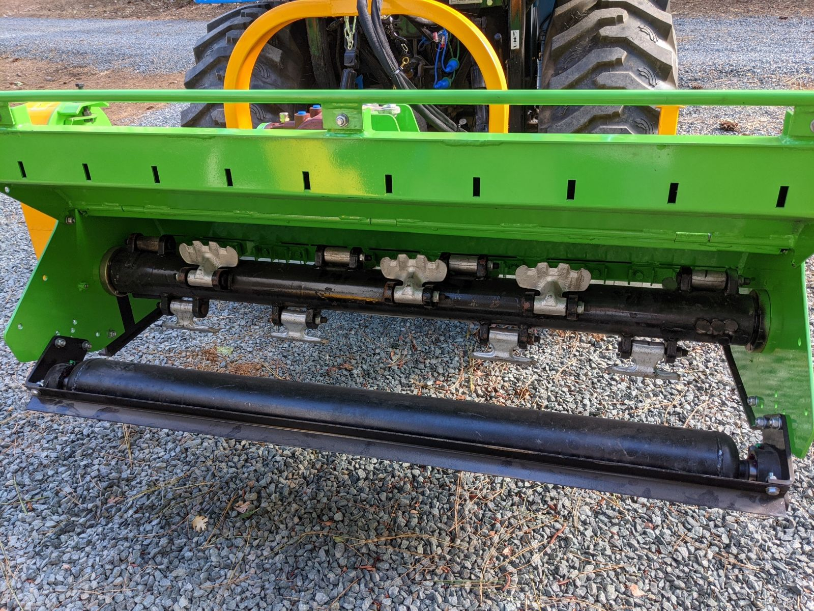

I had some Eucalyptus tree branches 1-3 inches laying down from a big branch a wind storm took down. A couple of passes and there was not much left of them. There is a finish bar behind the roller that keeps coming loose. Not sure how much it is really doing, maybe I'll just take it off or weld it on next year?

Hello and good afternoon scootr,
I want to welcome you as the newest resident member of the "Flail Mower Nations" from the Golden State.
The scraper bar is ment to keep the roller clean of any wet grass or mud. You can keep it tight by investing
in 2 fine thread bolts and fine thread nylock nuts.
/ Flail Mower Recommendations #33
Yes, like leonz says, you need that to keep the roller clean from debris. He's got a good suggestion with the bolts and nuts.
/ Flail Mower Recommendations #34
I had to take mine off. No matter how unadjusted it the wet clay would lock up the roller and the flail would skid along on it, so off it came. When I have to cut in wet stuff now sometimes the roller builds up but at least it keeps rolling
