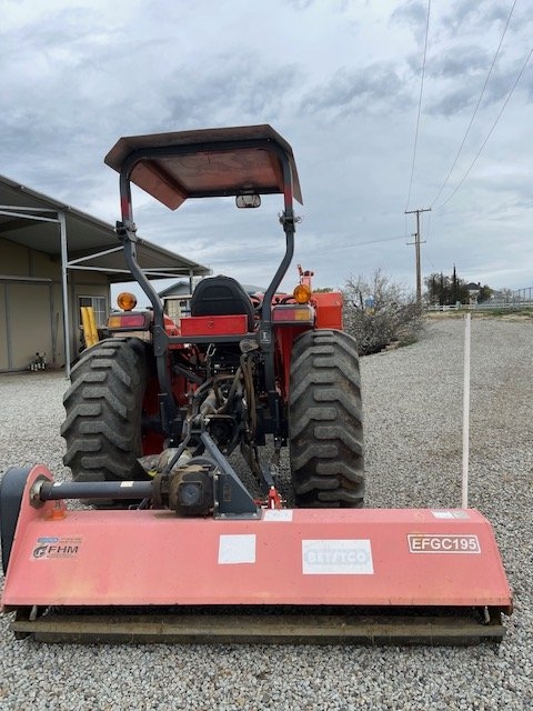

I have a Bestco flail mower # FH-EFGC195 77" for 35 hp tractors. They have smaller models available. This has been a cost effective buy under $3k delivered. There is a flail mower learning curve. I smoked a set of belts (it uses 3 belts $85). And I trashed a set of cutting hammers mowing rocks. I can reclaim the hammers later but it was a paying job so I just put the money into a second set. 32 pieces I believe.
With flail mowers you have a choice of knives or hammer style cutters. Hammers reduce brush to kindling and knives give a better finished cut on weeds and grasses but fail on the big stuff. A well kept set of hammers can give a decent field cut and still take down saplings and mulch downed branches.
