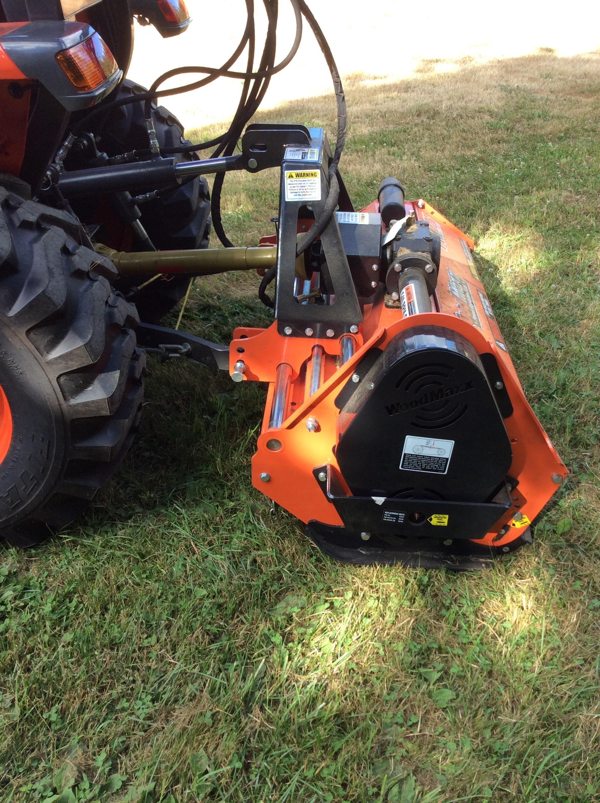

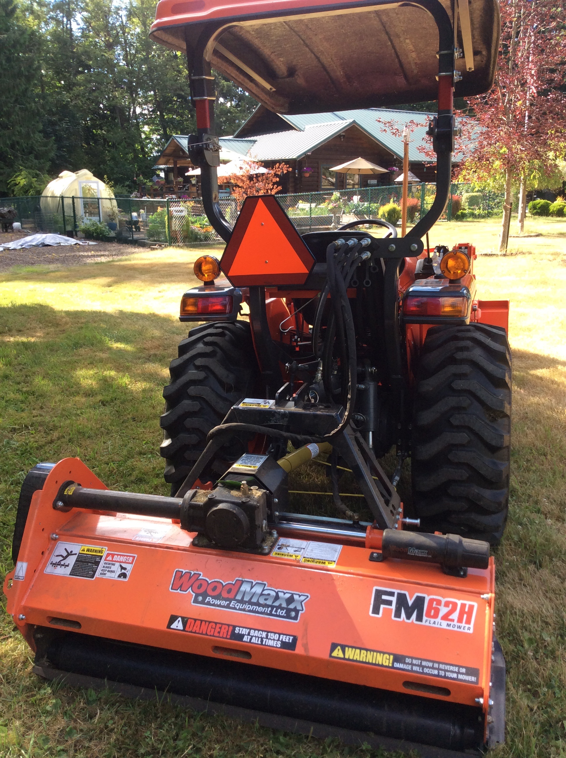

After trying a couple suggestions, looks like all is well with my new Woodmaxx 62H mower. Have changed "top link pin" from slotted hole to straight hole leaving the bottom arm pins in their slotted holes then, after re-adjusting levels on the concrete floor then tipping the mower up in front about one inch or so, made several turns both directions plus up/down some small hills with no scalping on turns, rises or dips. No issues with roller scrapper so far but grass is pretty dry this time of year. Having rear hydraulics sure makes changes easier than the manual link system, not cheap but well worth it! Thanks to everyone who gave suggestions in resolving this, hope I too can one day help others.

Good job. Glad you got it worked out. Now if we only had a picture of the results, all would be right with the world...��
/ Flail mower adjustment #31
I have so much trouble trying to post photos, have done so a couple years back but alas it slips my mind how to do them. Have been trying here for 20 min but no cigar, sorry.
RN
/ Flail mower adjustment #32
try these, may have got it.
RN

Looks nice. That's a nice looking tractor and mower. Makes my old stuff look, well, old. :laughing:

Maybe this is better.

That is a better picture.
/ Flail mower adjustment #36
I am surprised by the rear scraper bar as it is not really something you need in a flail mower.
It also explains why they tell you to not back up with it while mowing as it will bend the
scraper bar.
How thick is the steel plate weldment for the trash ejection/knife service door?
Is there a cross brace weldment/round or square tubing weldment under the rear lip of the trash door or is the rear roller mounting plate and the scraper and the rear roller used to enhance/act as the cross bracing to strengthen the mowers shroud/trash door/knife service door????
I look froward to hearing how well it performs with the trash door open.

/ Flail mower adjustment #38
scraper bar.
The whole body of the mower looks to be 3/16", with 1/4" ends.
The scraper bar acts as a tie bar across the back of the mower and maintains spacing for the roller bearings. I will be modifing the scraper to be a simple 3/8" thick bar 2" wide. This will be much more robust than the formed angle that it came with. It's the only thing on the mower that is sub par.
There is no cross brace under the lower edge of the trash door. When the door is open the whole rear of the mower is open. I've mowed with it open, but for what I mow it's not needed. If I had more stalks and tough material it would be helpful. I may have the chance to try it on corn stalks later this summer. If I do I'll let everyone know.
For now I leave the door closed even when mowing in 4' weeds. It mows to about 4" just fine with only the occasional place where the tire compacts the weeds enough that the don't get vacuumed upright. It's worse when things are wet...
