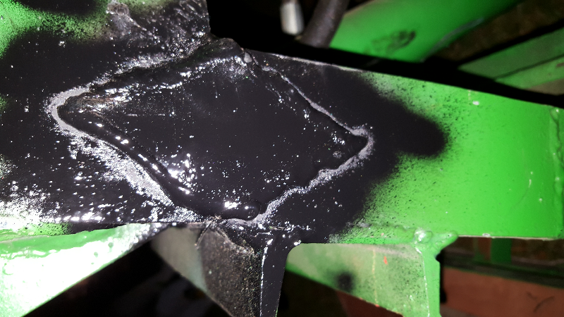

Just bought this tractor a week ago or so. Have been having problems where the guy welded the tractor loader. It is where the loader drops down. This tractor was a custom from a trencher. Looks to be all good designs, but was only made for moving some soil around or some mulch. Why we broke the loader was because the first morning we had the tractor we used it to dig a septic pipe in wet clay ground.
This is after grinding welds down and pulling it back together.

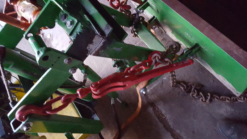

Used chains and chain binders to pull it together. Then used a bottle jack to push it back out from getting twisted (kept using it for a week cleaning a barn and digging out a septic pipe)
Fish plates cut and ready to weld
Dinner break. Little sister watching mickey mouse and caught my dad watching

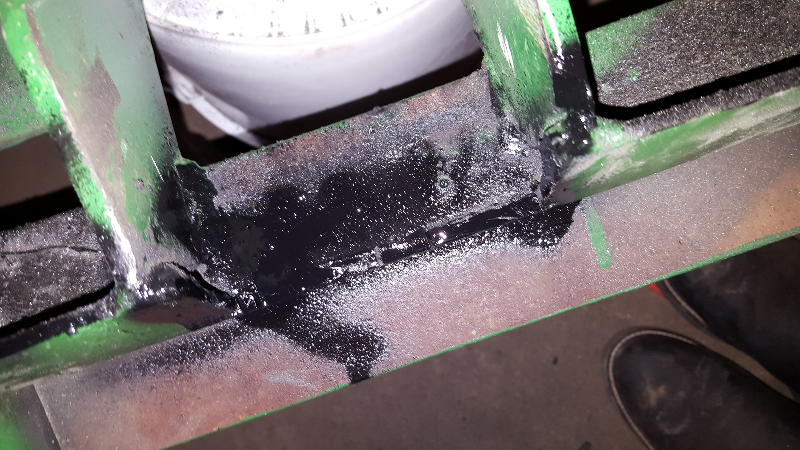

Went out and had him weld it. Didn't get no pictures before adding fish plates
And grinded out a section where my lift cylinder was hitting
Test. Front end was lifted about 6-12 inches off the ground
What you guys think? ? Anything you would have done different? ? Actually tought my dad new thing about fish plates from this forum. He didn't know they were supposed to be like a Dimond.

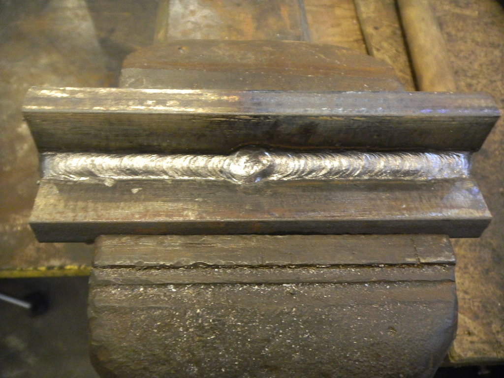

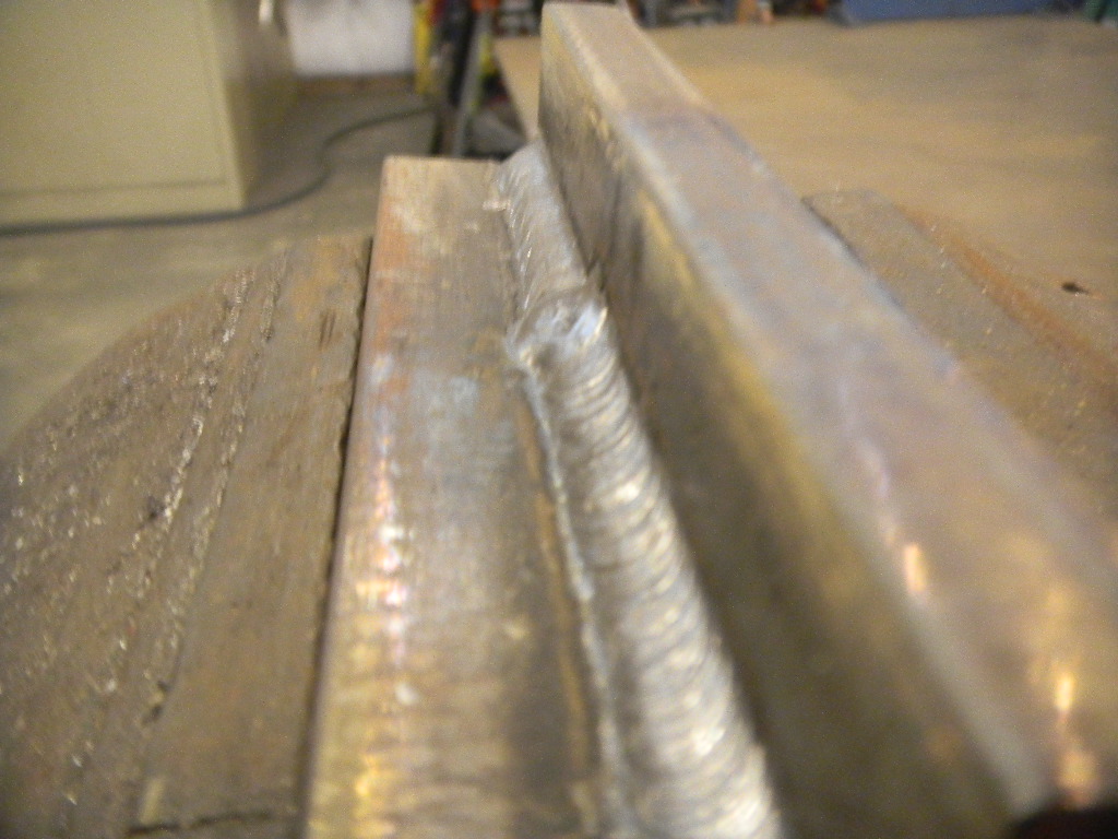

A couple things that can help, especially in high stress areas. Grind back your starts and stops of your welds. If you use 7018, there is a good chance you'll get porosity in the beginning of the weld. Good practice is to grind out about 3/8 of an inch.
Try never to stop on an edge. Try to end your welds in the center of the plate if you can.
The start, and the end of a weld, are generally the weakest parts.

/ fixing tractor loader

Is there a way that you can add a angel brace on a 45 degree angle below repair area both sides? That would really take the stress off of that spot especially when pushing in to a load.

We welded with the wire feed welder (mig right? ?)
Yes, Mig. Mig is notorious for cold starts! So even more so with Mig you should grind out the start. Now some times you just can't do this. But say you're are back stepping your welds, that is the perfect time to grind out the starts and stops of your welds.;)

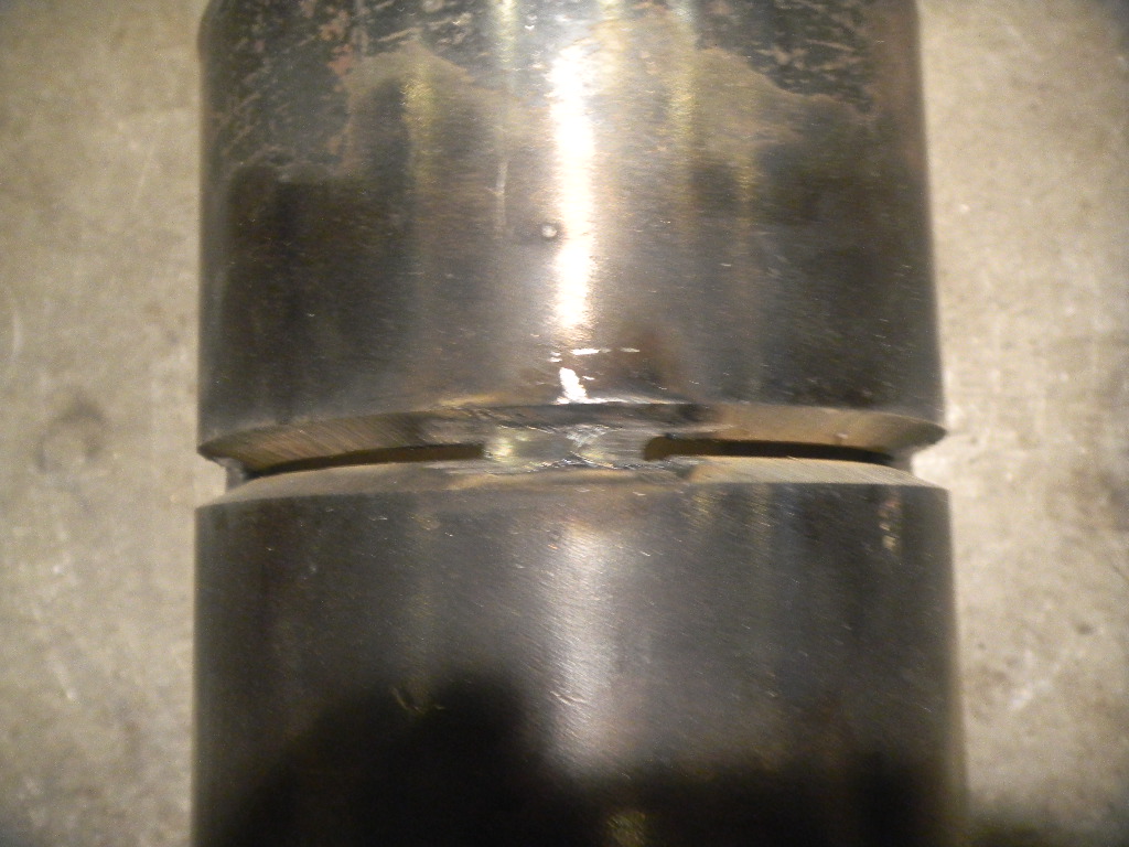

Correct! See how I feather ground each side of this tack? This helps get a good tie in when I start to weld. And when I run up on the tack when making a weld.
Then see how I stopped the weld in the center. You can't always do this, but it is a good practice to get into.

Ran tyne tractor yesterday for about a hr or so leveling and dug up one popul sapling. Then was digging another and ran out of gas.
Main reason that caused the welds breaking was cause the curl cylinder at full curl still had extra room so that it kept pushing. No cracked welds yet.
As for doing a brace we could and will if there is a problem with it again

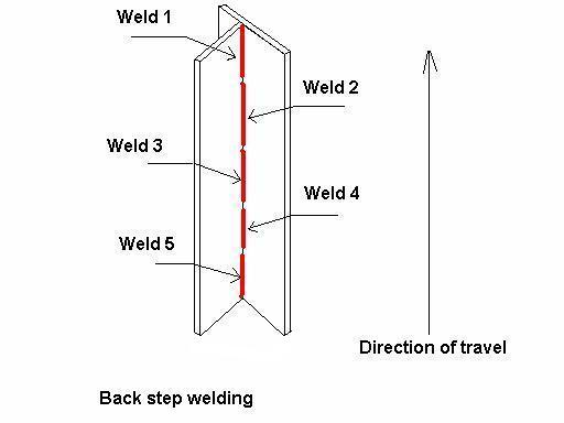

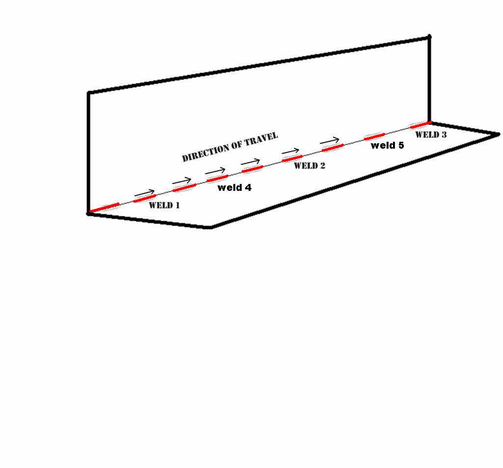

Back stepping your welds, and skipping around a lot really helps keep down distortion.

What do you mean by grinding the start and back stepping on the welds? ?
Sorry but ain't %100 sure what you mean
Grinding the starts/stops is done because that's where the weld is often bad. If you stop welding, then re-start the weld, you have a start and a stop in the same place. Twice as bad. With MIG you may have a cold strart, and when stopping, you may lose gas coverage while the puddle is hot. With stick, you may not have the rod up to tempature right away at the start, and at the end, you might leave an unfilled crater.
Grinding away where the weld stoped gets rid of the bad part, and striking the arc for the re-start ahead of the tie in point will let the rod (stick welding) get up to temperature before you start making the bead. This will reduce the possibility of having defects in the weld.
