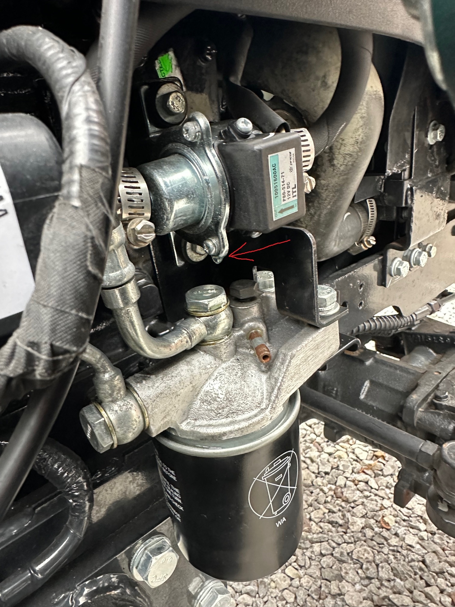

Wow, I haven't posted to these forums in many years! I like your idea, so here it goes. Bought my Summit tractor in May 2025. Today it has 25 hours. So far, replaced the seat headrest due to discoloration. Replaced one of the 3PH links because I needed a 16-inch pipe wrench to turn it. The seat didn't want to adjust when I first got it. Emailed Summit and they said to hose it down with WD40 and keep trying. It did free up, but it is still kinda stiff. I attribute all of these items to the fact that the tractor sat outside at the retailer where I bought it for I'm guessing a year or more. Some time last summer I was checking the tire pressures and the valve stem on one of the rear tires started to leak the beet juice. After getting over the initial panic, I replaced the core in the stem and so far it has been good. Finally, in Nov-Dec I noticed a fuel leak coming from the right side of the engine. Turned out that the fuel pump itself was leaking. Summit sent a replacement pump but with all the cold and snow here in the northeast I haven't replaced it yet. It's on my todo list. I have a pic of that - the red arrow is pointing to a drip ready to fall. So far everything has been covered by warranty.

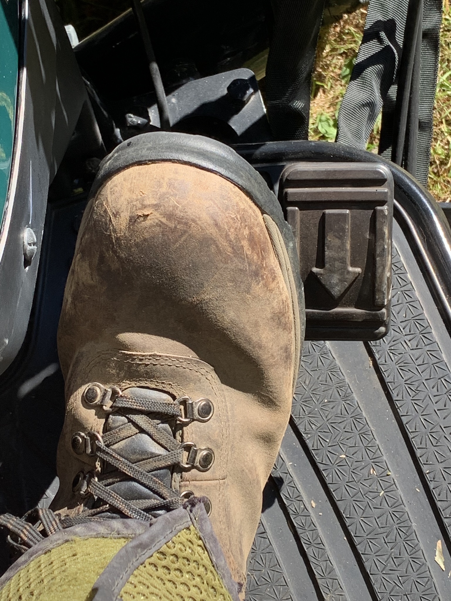

Let me throw in a few pet peeves. I didn't think my foot was excessively large, but I have a hard time not pressing on both pedals when I am doing alot of forward and backward. Maybe if I were barefoot?? Also, I did like wearing the seatbelt on my previous Kubota. The seatbelt on the Summit is just a little too short for me. Guess I have gotten a little too "tall" in my old age!

Oops forgot the pic. Here it goes. Added one for the pedal peeve.
