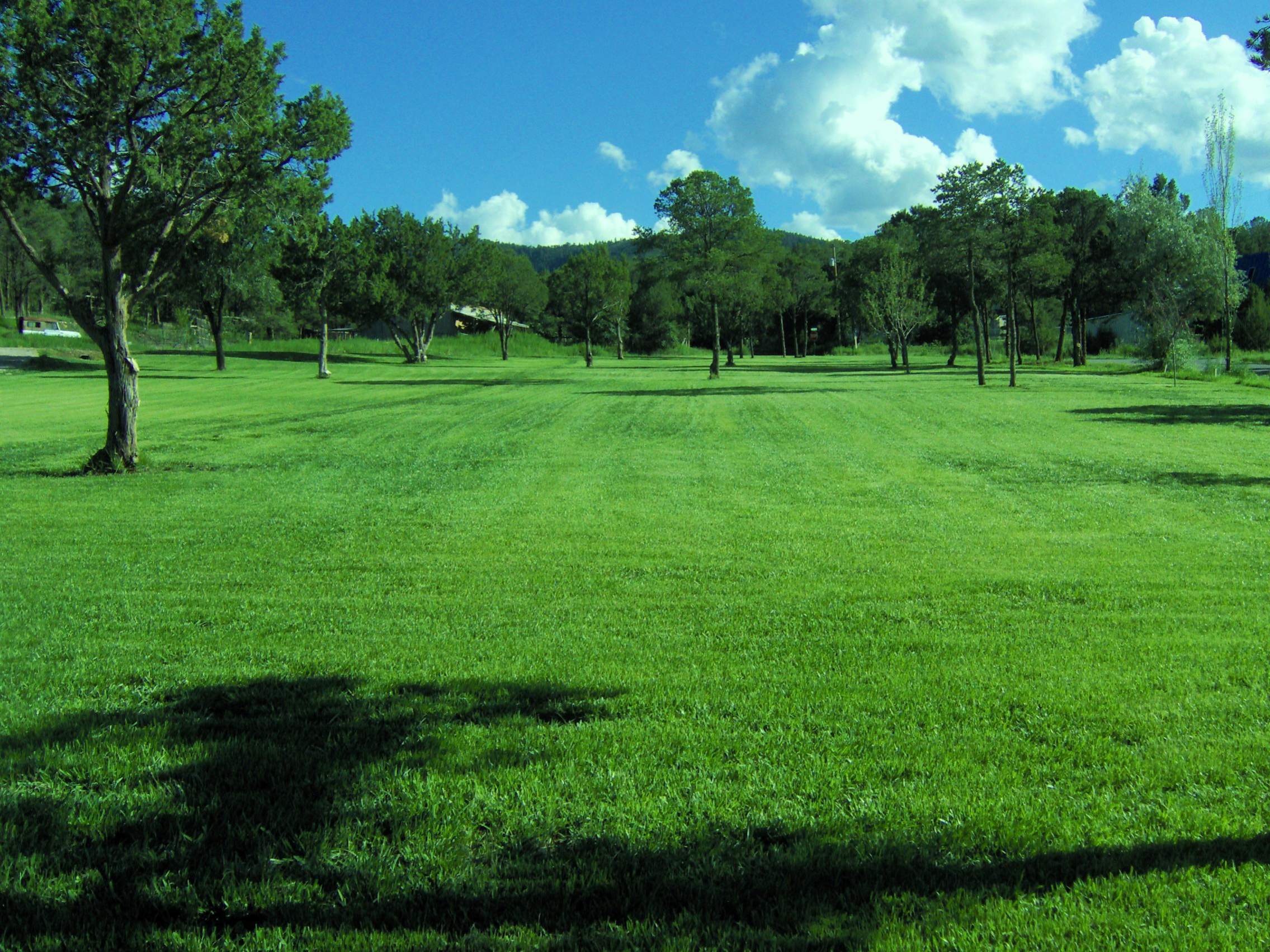

Knowing whether you have a lot of rocks near the surface would help us make the best suggestions. If the rocks are not a big issue then tilling and mixing in the right amendments can really help. If you can till it deep enough it does make it easier to wind up with a smooth lawn since you can move the dirt around as needed.
Tilling and smoothing with a landplane grader blade, harrowing and broadcasting the seed worked well for me in my lawn project.
