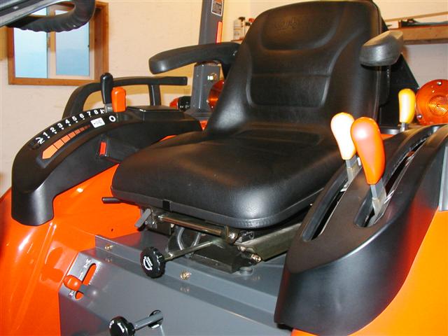

So I've been using the f3680 seat on my b3030 for 20 hours now. Its great. Feels like I'm in a car with good suspension, even while bouncing over rough meadow. It has tilt, lumbar, and suspension adjustments. It is the cure for the b3030 seat, as Neil Messick said.

Has anyone found anything else out about the seat replacements? I have new 3030hsdc, which I now have 8 hours on and the seat is horrible. After two hours of blowing snow I need a handful of Aleve for my back! I did some reading on here and see the seat from michigan seat looks like a replacement.Michigan Seat Company Is this the same seat as on the f3680 ? Sure looks the same.

Guess I would have been even more upset if I'd shelled out the money for the cab and had to put up with the poor seat. I contacted Kubota and asked them if they'd heard of the issue with the B3030 seat. Evidently they have, they responded and said I'd be hearing from my dealer. Sure enough, the dealer contacted me and said they would be replacing the seat but were waiting for word on the specific seat to be used. The dealer came out and replaced the seat with one that is evidently from the Z series mowers. Have 0 seat time in the new seat but it looks less like a recliner and has more padding. I know of at least two sales Kubota has gained because of this excellent customer service. I have been thinking of buying a BX1850 because I'm not happy with my riding mower, however the 1850 appears to have the same seat as the B3030, now I know I'll be getting the 1850. I had let a neighbor try my B3030 but he said he wouldn't be getting one because of the seat, this was after only 1/2 hour of use and I had not told him I was uncomfortable in the seat, I was too proud of the tractor. After I told him how Kubota made the seat a non-issue, he said he'll be buying one.
Kudos to Kubota. They have all my future business.

I replaced my B3030HSDC seat with the B2910 seat. The bolt pattern was identical. Changed the seat in less than 5 minutes. Probably alot less than F3680 seat. Although the F3680 seat is very comfortable since I purchased one this past summer and like it very much.

ussie00, forgot to answer one of your questions. Yes, the seat in the link in your post is the seat on the F series mowers. I confirmed this today at a Kubota dealer. Kubota even leaves the Michigan Seat sticker on the seat. The F series seat is by far the best seat I've tried on a Kubota product. However, though I haven't had the opportunity to do any work with the tractor since the seat was replaced, I can tell the new seat is light years ahead of the stock B3030 seat just by sitting in it for a while and the price was right! If it turns out I don't like the replacement seat, I'll let the moths out of the pocketbook and get the F series seat, that's as comfortable as my recliner.

Part number 6C070-88720 is a good replacement option.
Seat that was used on the B2410,2710,2910.
