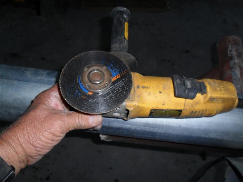

I've made fish mouths with a hole sale in my drill press, and I've cut them out with an angle grinder. I usually keep one grinder with a narrow curf cutting disc in it and another one with a grinding disk. It's fairly quick to cut the V with the cutting disc and then grind out the rest of the profile.

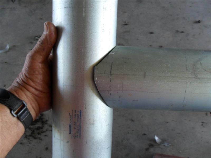

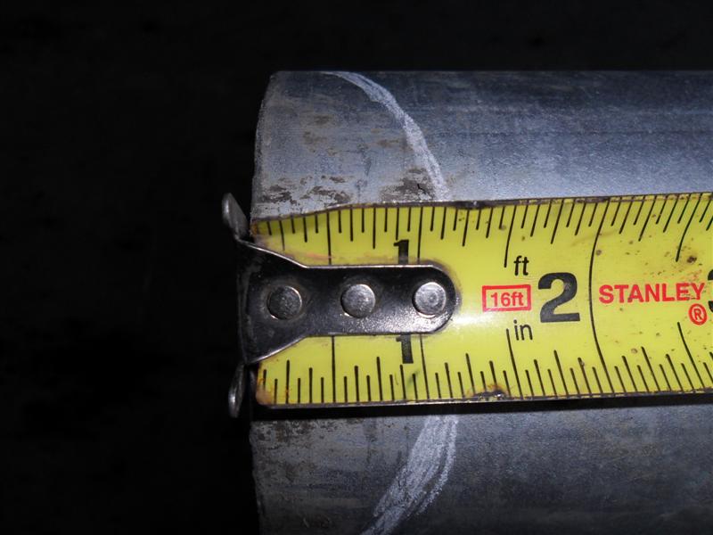

You have to keep in mind that I've been doing this for almost forty years. I have an edge.

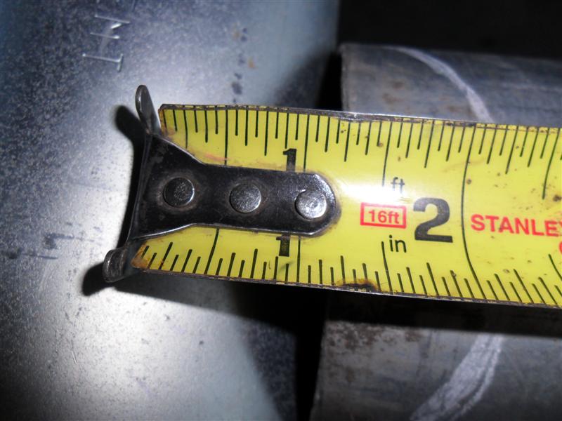

Last weekend I had to finish out an entryway. The material was ten foot sticks of 4 1/2 inch diameter EMT. It's about fourteen gauge. Gap welding isn't any fun with material that thin and galvanized to boot. So a good fit up is critical.
Step 1 is figuring out how deep to cut the notch. the way I figure that is place the pieces together and measure.

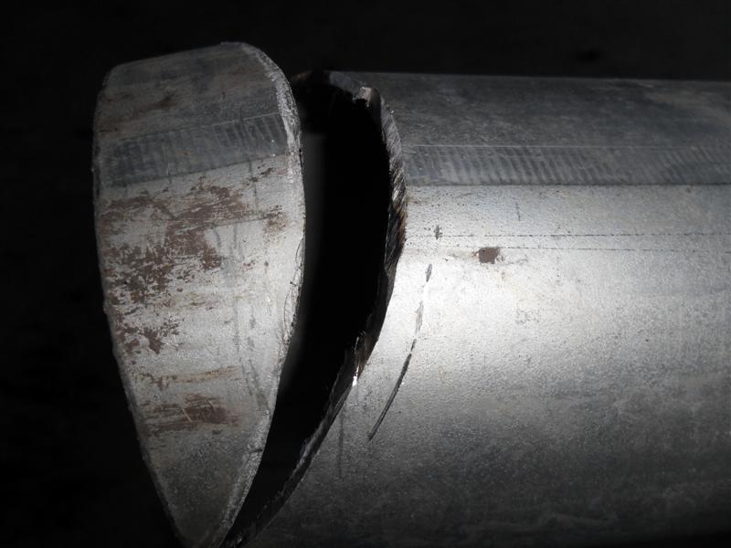

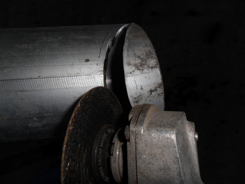

Once I have the depth of cut measurement then I do an arc to each side. That is followed by cutting it out. You can use a torch, plasma, sawsall, grinder, whatever. With this thin stuff I figured the easiest was with a cutter blade on an angle grinder.

I've used this on pipe from half inch to twenty four inch. I get lucky with it just about a hundred percent of the time.
I have a Vogel notcher, just about all the sure-cuts, and a Williams Low Buck. I use the Vogel when I'm doing a lot of one size. I haven't used the sure-cuts in probably eight plus years. The Low Buck is the trickest, but that's just the way Williams' mind works.
But if you are building a gate or cutting in a once every now and then thing, this works slick and doesn't cost much at all. Plus if you're **** about fit up you can touch it up with a grinder and make it so tight that Ray Charles can sew it up, even if he's blind and dead.

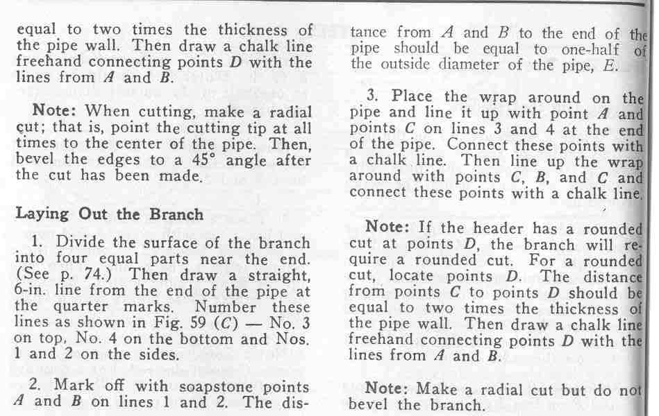

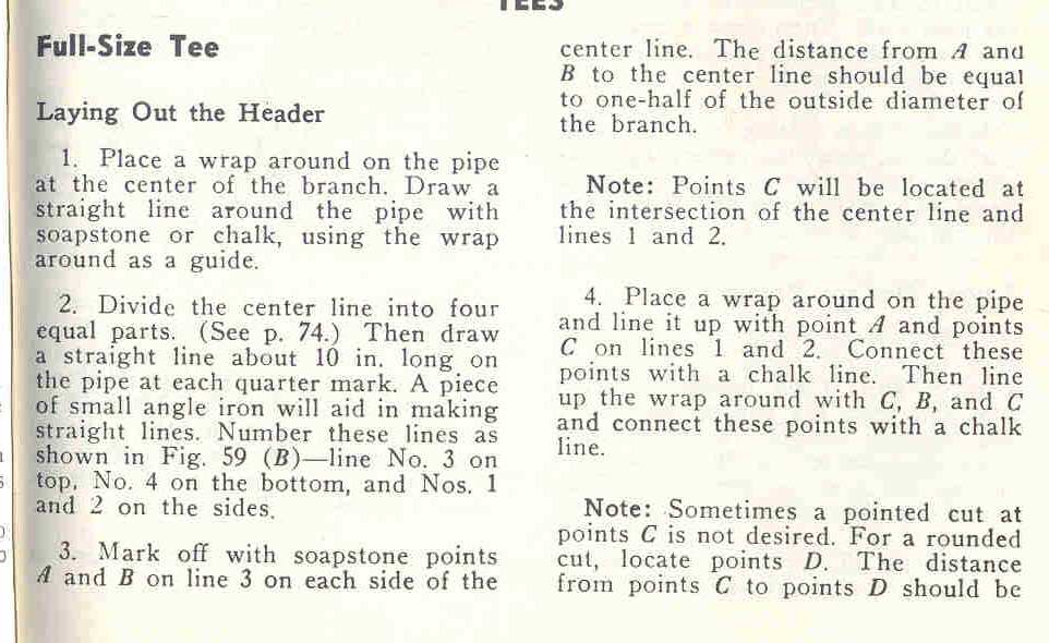

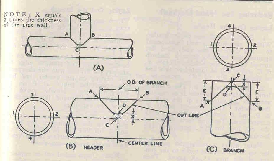

Here is how pipe fitters do it.
