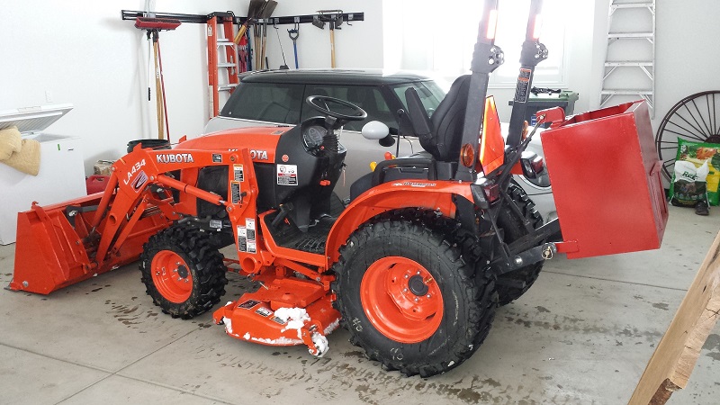

Here is a picture of the titan ballast box. It is nice and sturdy and has some convenient features for the price. The paint quality is marginal at best, and the color doesn't match, but it is functional.
A word of caution. This is only my second 3 pt implement so the first time I encountered it. My top link wasn't adjusted out far enough so when I raised the 3 pt hitch it ran into the metal fender support that goes across the back of the tractor. Oops, another lesson learned. I was able to use a strap and the 3 pt hitch to pull it back into place, but now there is a dimple in it.
