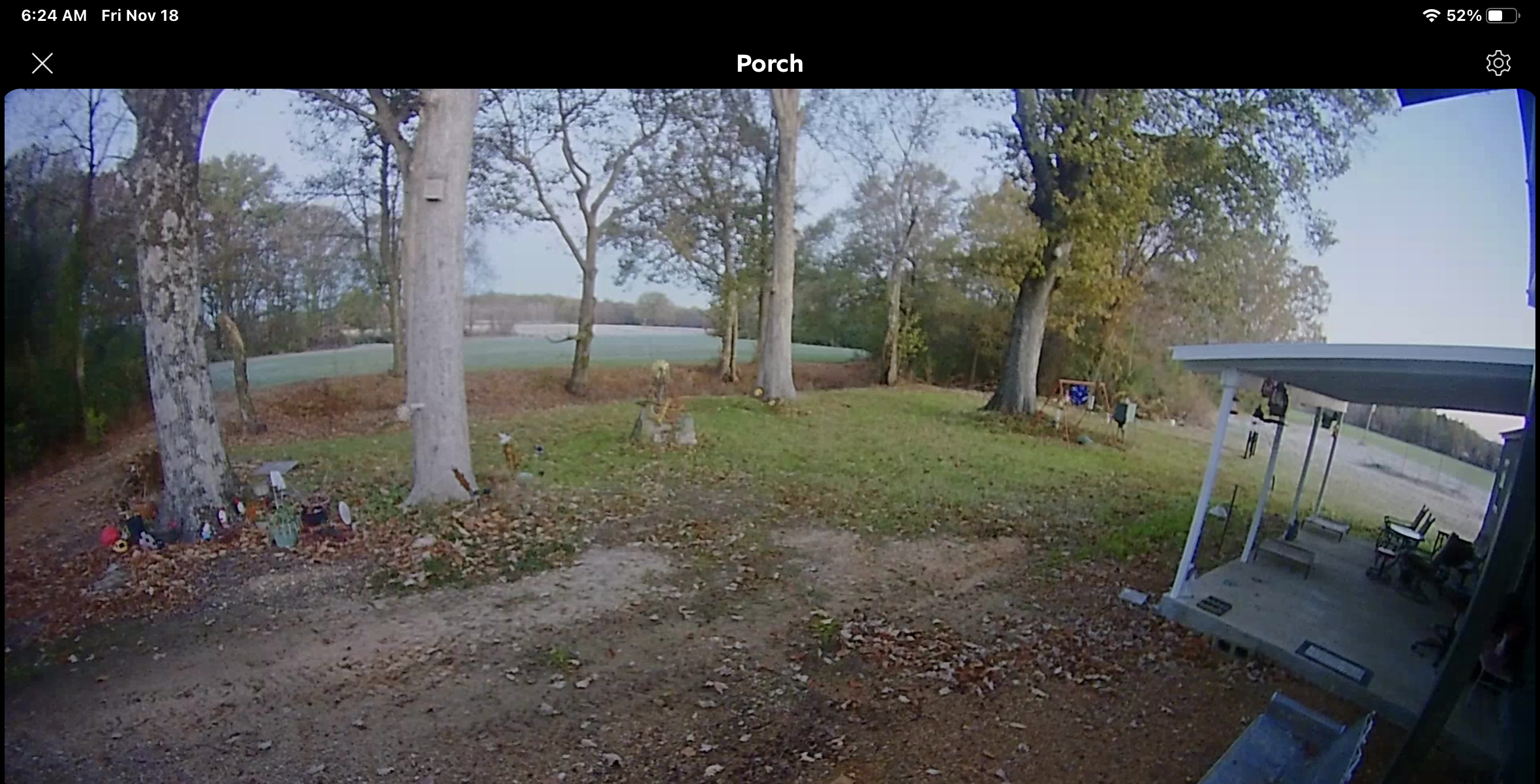

Are you growing Wheat as food source for you or as food plot for animals?
What is growing in this area now?
Tine cultivator will be much faster than tiller but may have trouble with clods if currently grass and weeds.
If grass & weeds and growing as food source for you then getting rid of grass and weeds is more important than food plot.
I believe You can buy hand seed spreaders that are crank operated. Like other have stated getting the seed rate consistent is the challenge.
We used to seed wet spots in fields with hand spreader and then run spring tine drag over to help lightly bury the seed. This was on ground that was tilled.
Thanks for the rply. As a food source! So how would I use the tine cultivator to plant from zero?

Hello friends,
I would like to know the basics of wheat planting. I owe a Massey Ferguson 2615 with a rotary tiller implement as well as a tine cultivator. Are these enough for planting the seed? And how is it done? Not wanting to pay a fortune on new implements if required
