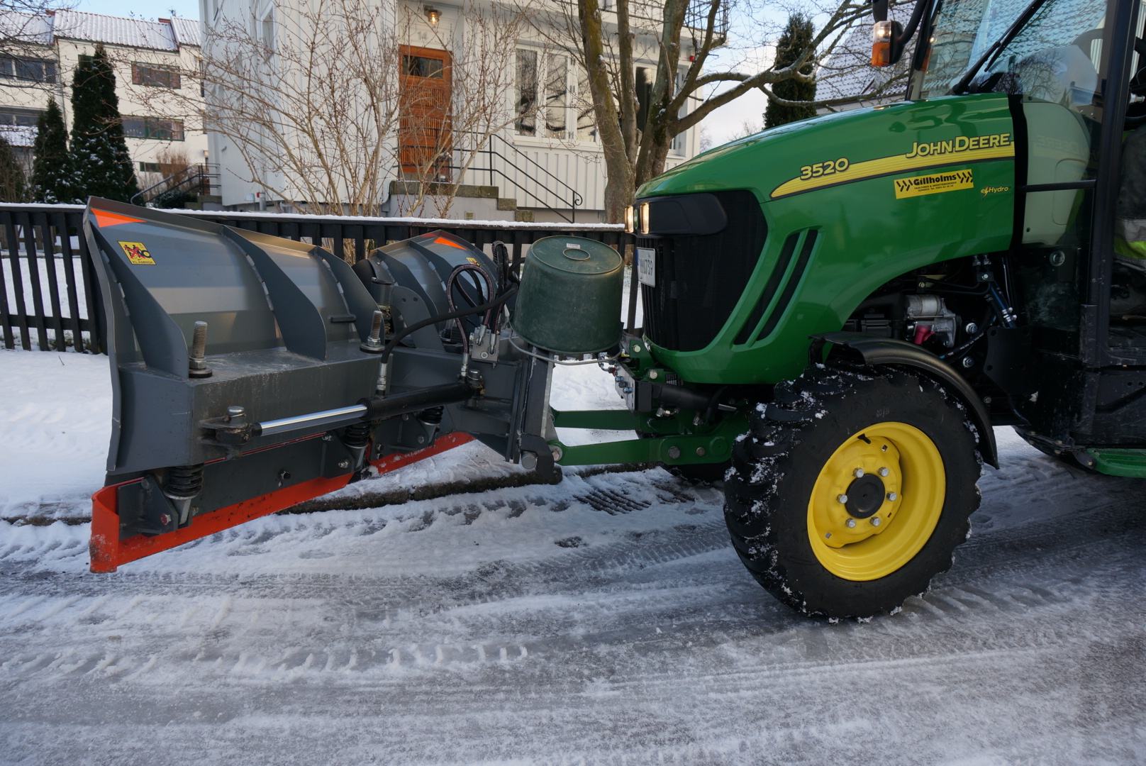

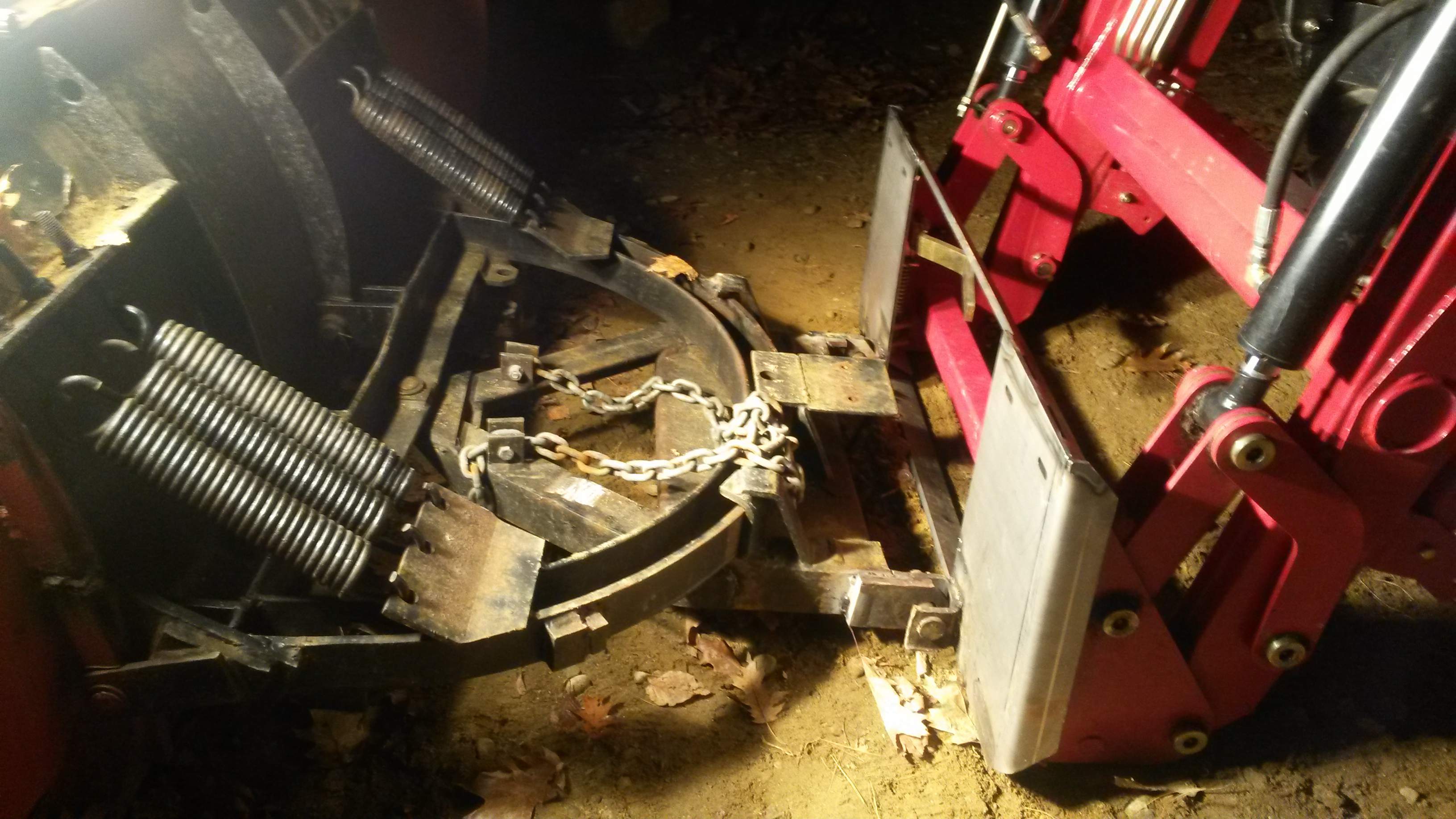

If you have a plow mounted on your "bucket" you should not be using float, IMO....
the bucket should be about 5 to 6 inches "off" the ground, and only the weight of the plow should be on the ground, preferably held by a chain or whatever so the "plow blade" floats.
You can angle your bucket to get the right angle needed for your blade, as suggested.

I have a FEL plow setup from one of the best tractor manufacturers in Canada. It took some serious time to figure out how to get everything setup right, and I seldom use float position, but can if I chose to. Make sure you have a crossover valve in the hydraulics of your plow hydraulic lines to prevent/reduce the chance of racking your loader arms from the forces exerted by the plow against the loader. You're not trying to clear an airport runway, are you? Therefore try as suggested, tilt the plow blade forward enough to keep it from catching on objects in the path, when in float, and the edge will likely trip less than before. Plus as you work the learning curve realize you can make more than one pass to clear an area without damage to the loader, your ego or your wallet. You can run your plow slightly off the ground too and then clean more closely on a subsequent pass. Forget the neighbor; his rig probaby bounces over everything anyway. Remember, learning curve- it takes some time- you'll get the hang of it.:thumbsup:

When I used to plow it in the begining, I used my mighty old HD 1/2T pick up, with a good old mighty fisher snow plow. And men let me tell you that the chain "float" mechanism had quite a rollercoaster ride!! Even the big rigs have the chain mount. It works as intended.
