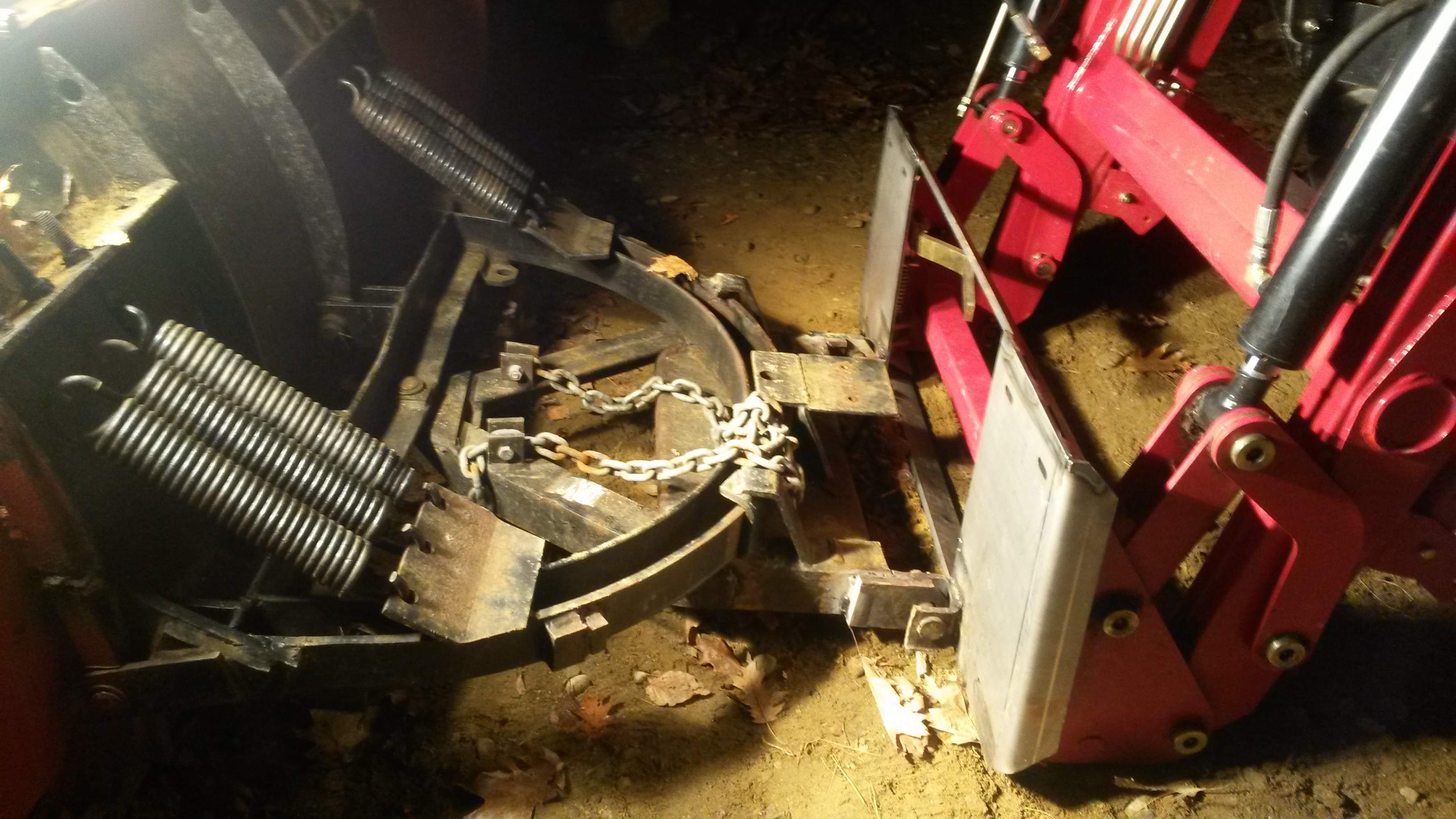

I had a similar experience with rigid mounted snow plows using float. For that reason I prefer the plow to be suspended by a chain, like it is when mounted on a truck. You adjust the loader arms until you have the angle you want, and leave slack in the chain. The plow is free to follow the contour of the ground.
Here is a friends plow rig under construction. When completed the chain was hung on hooks at the top of the SS attachment plate.

This is a common problem for FEL plows on smaller tractors, espesially rigid ones, just not enough weight on the tractors front end to hold it down. The ones suspended on chain seem to work better as described above.

The FEL acts as a lever and wants to raise the front of the tractor. Also, in float all the weight of the FEL is on the plow and not on the tractor, thats why chain setups can work better, then only the plow floats.
That's why plows are better on front mounts (that attaches to a point LOWER than the rear axles) than on FEL arms.
