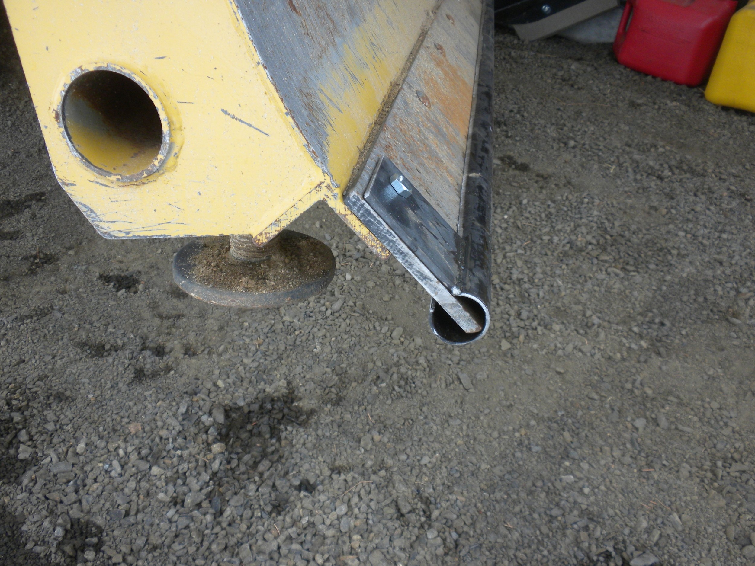

I plow with a skid steer and often use float. It's misery when the ground isn't frozen hard. I had this guard built and keep it on my plow all the time. It helps some.
A friend built some custom plow shoes for his and they look to be helpful. Rather than a simple disc his shoes are rectangular and are probably a foot long with 2/3 of the length behind the pin so they stay oriented correctly. (like a caster wheel works). They have short angled plate on the front to help with digging in.

Try a pipe sliced to accept the cutting edge, might help. Shoes must be very large to help with your rig.

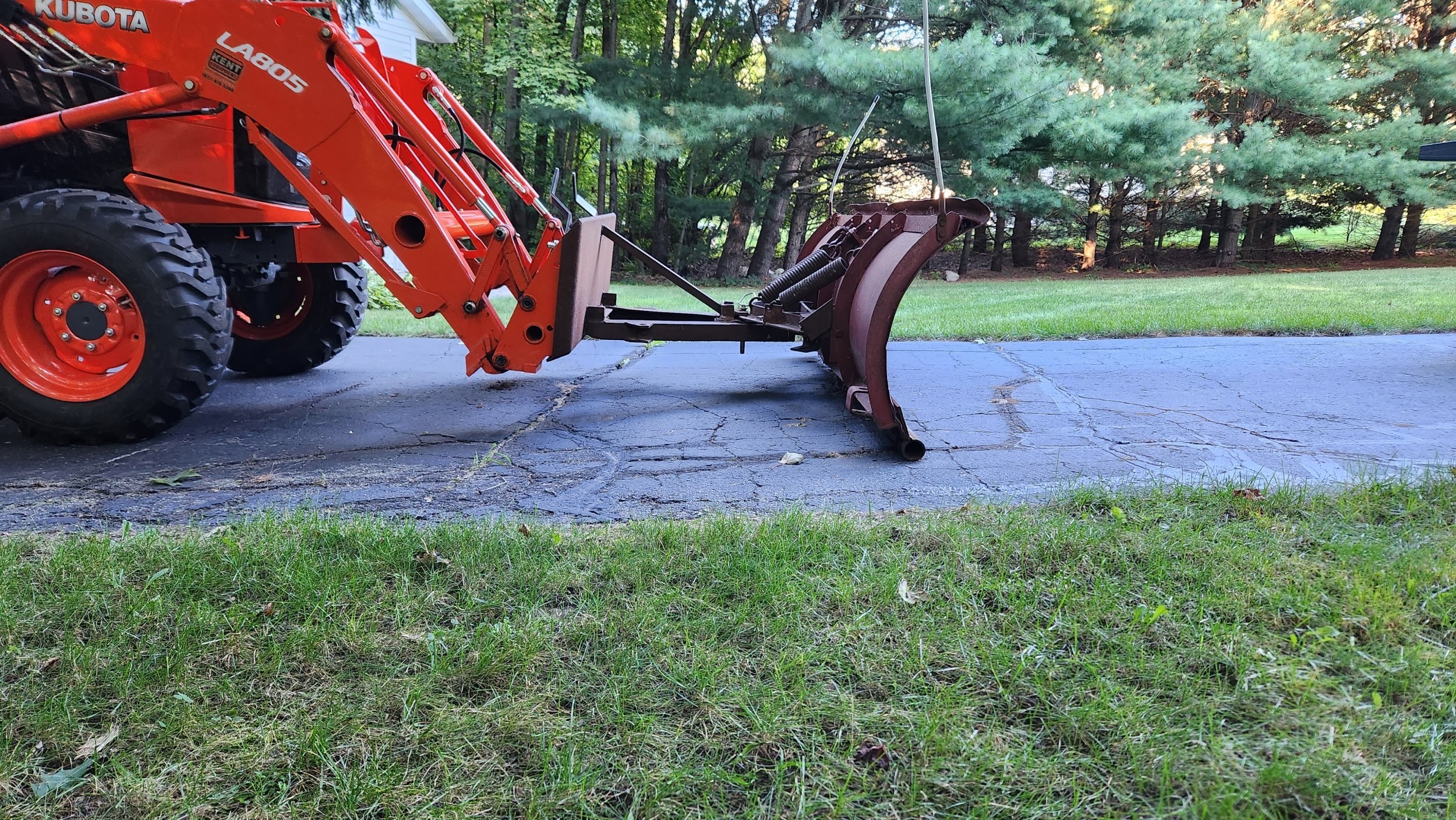

Be gentle, this is my first time plowing with my tractor as well as my first time with a fullsize plow. All noob jokes are expected. :)
I have an L3560HTC that I've added a 7-foot quick-attach plow to. She looks like this:
Yesterday was the first snow and I attempted to use the FEL's "float" mode where the plow is supposed to just glide smoothly over bumps and things like a happy little pillow. Only in my case it just shoved into the driveway and tried to dig up what little asphalt I have left. I have a couple theories as to why but wanted to ask the experts before I do something horribly (yet hilariously) wrong.
My thoughts are that perhaps it's related to the angle of the plow, or the lack of plow shoes, or some combination of the two? I figure that since it has such a large forward protrusion off the SSQA attachment that I just need to angle it more upward than level to make everything happy, but I worry that I'll end up just digging some other part of the plow into my driveway and not notice till it's too late. Does anyone have advice or a tutorial on the proper way to make this all work? So far I've only found generic "how to plow" videos on Youtube.
7’ is a pretty heavy box blade. It is simply more weight than float mode can handle. Maybe (big maybe) you can max out the drag lever to help, but I doubt it. This to the age old problem with 3-point mounted gauge equipment. Most people learn to get good enough with the lift lever or get a wheeled box blade.

I added a 2" steel pipe that a cut a slit in with a plasma torch, tapped it onto cutting edge, and tack welded it every foot. Cut truck mount down and welded to SSQA. I rarely don't plow with my loader in float. L3560 open station. Live in mid michigan so I'm moving plenty of snow and I do just fine. Adjust my roll angle as needed if the plow seems to try to trip, but I also only run 2 springs as I don't want a ton of pressure to suddenly catch on the loader but I go slowish anyways.
