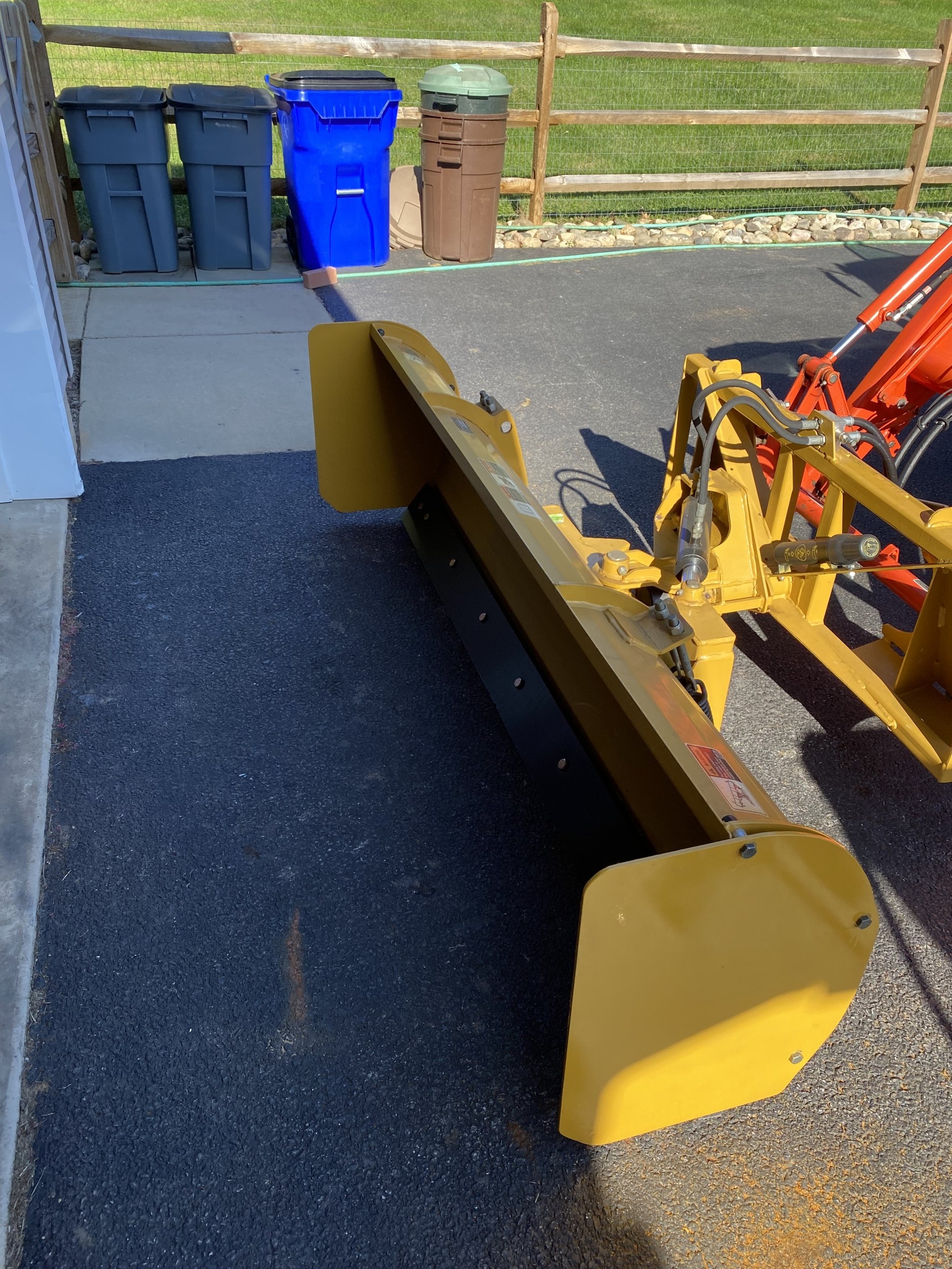

I fabbed some side plates for my ssqa plow to use as a pusher. Doesn't hold as much snow as a full blown pusher, but it's great for smaller snows even on long driveways. It's easy to angle the blade and push off to the side when it's full.
