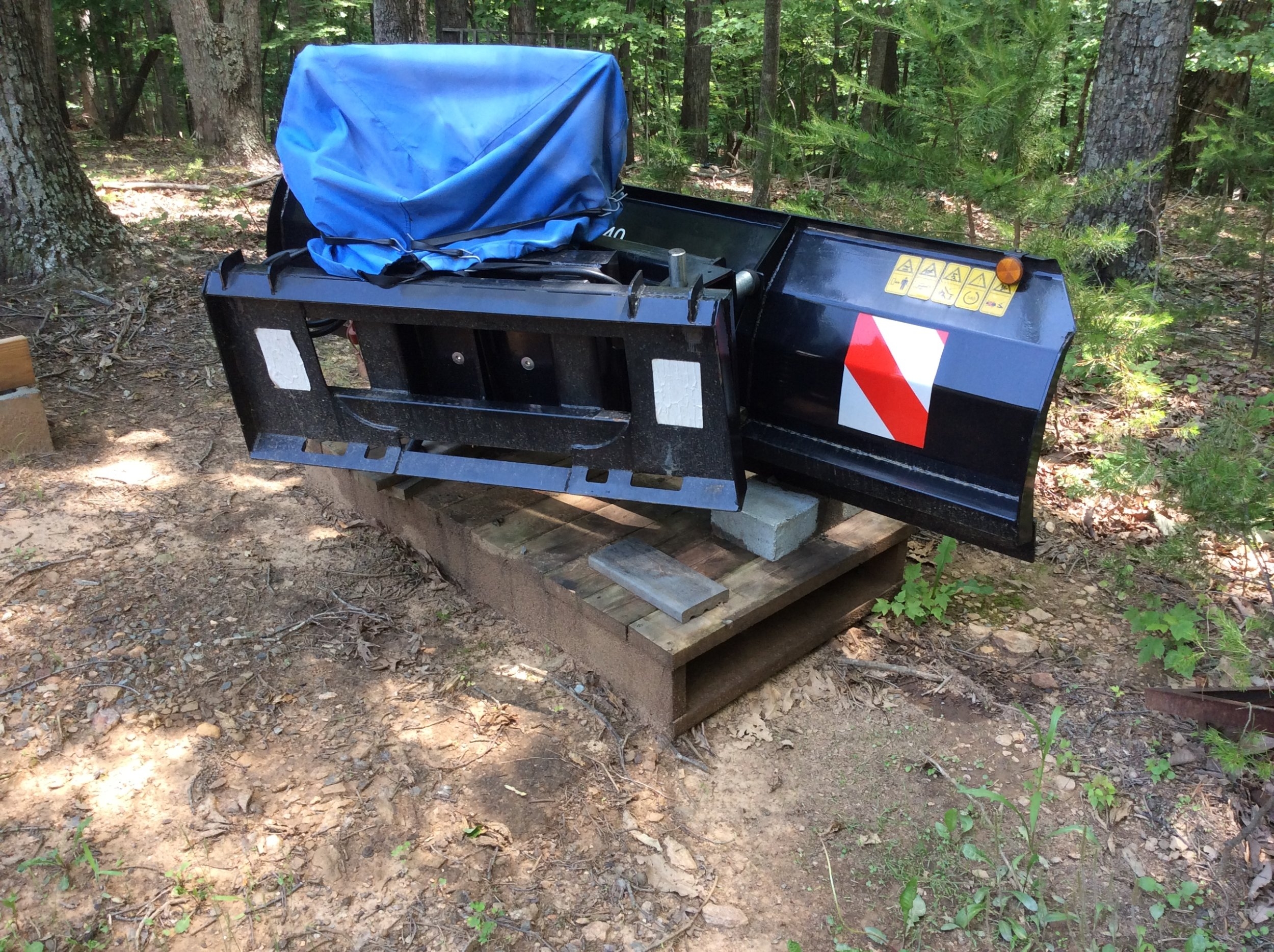

Be gentle, this is my first time plowing with my tractor as well as my first time with a fullsize plow. All noob jokes are expected. :)
I have an L3560HTC that I've added a 7-foot quick-attach plow to. She looks like this:
Yesterday was the first snow and I attempted to use the FEL's "float" mode where the plow is supposed to just glide smoothly over bumps and things like a happy little pillow. Only in my case it just shoved into the driveway and tried to dig up what little asphalt I have left. I have a couple theories as to why but wanted to ask the experts before I do something horribly (yet hilariously) wrong.
My thoughts are that perhaps it's related to the angle of the plow, or the lack of plow shoes, or some combination of the two? I figure that since it has such a large forward protrusion off the SSQA attachment that I just need to angle it more upward than level to make everything happy, but I worry that I'll end up just digging some other part of the plow into my driveway and not notice till it's too late. Does anyone have advice or a tutorial on the proper way to make this all work? So far I've only found generic "how to plow" videos on Youtube.
There is a lot of weight on the front of the tractor, you probably need to add some feet to the bottom of the plow so it slides over the ground instead of diggin in. The float works a lot better with a bucket that has a flat bottom, you can put it flat onto the ground or have the tip of the bucket tipped up slightly and then put it into float and plow. Both of my Jeeps with a snow blade have feet mounted behind the blade to control the depth of the blade. Since my driveway is gravel with a slight hump in the middle between the tire tracks, I usually drop the blade, then pick it up slightly, this adds weight to the front axel for better traction and it also stops me from plowing all of my stone off into the woods
   / First time plowing with SSQA plow, float mode just digs into the driveway #47
I think your logic is right on the money. ".. perhaps it's related to the angle of the plow, or the lack of plow shoes, or some combination of the two?" Yes, that is the primary adjustments you need to make to avoid gouging your pavement.
You also said "... I figure that since it has such a large forward protrusion off the SSQA attachment that I just need to angle it more upward than level to make everything happy, ..." which is true too. Cut and try making small incremental adjustments as you go and you'll find a sweet spot that gets the job done but causes little/no damage. Probably #1 priority is some kind of skids under the blade to keep it from diggins in. Some of those look like round pads with adjustable height and some spring loaded, etc. You might get away with skids that just barely keep the blade tip from pavement contact.
plow shoes.....Required to keep blade edge off of asphalt
Notice the ends of his snowblade. When you scrap you will leave a thin layer of snow plus you will have two skid marks on your asphalt if you are apply any down pressure on your loader mounted scrape blade. Found out on my Workmaster 50 that 3 point hitch has a float mode with no down pressure where loader only has pressure up / down. Weight of my snow-blade (similar to yours) is so heavy it will drift down eventually causing it to gouge
without skids on the snow-blade mounted upfront. I gave up and just went back to using 8 ft three point hitch scrape. I have more control and just use front blade for lightweight dozer work (cleaning honeysuckle, briar patches, etc.).
I have a similar set up and added a 1.5”-2” x 7’ scrap steel pipe with a 1/2” slit length wise
Hammered it on the blade it’s a tight friction fit and now the plow doesn’t dig in
Because of the round edge
Very happy with the results
And it didn’t cost to much but time
