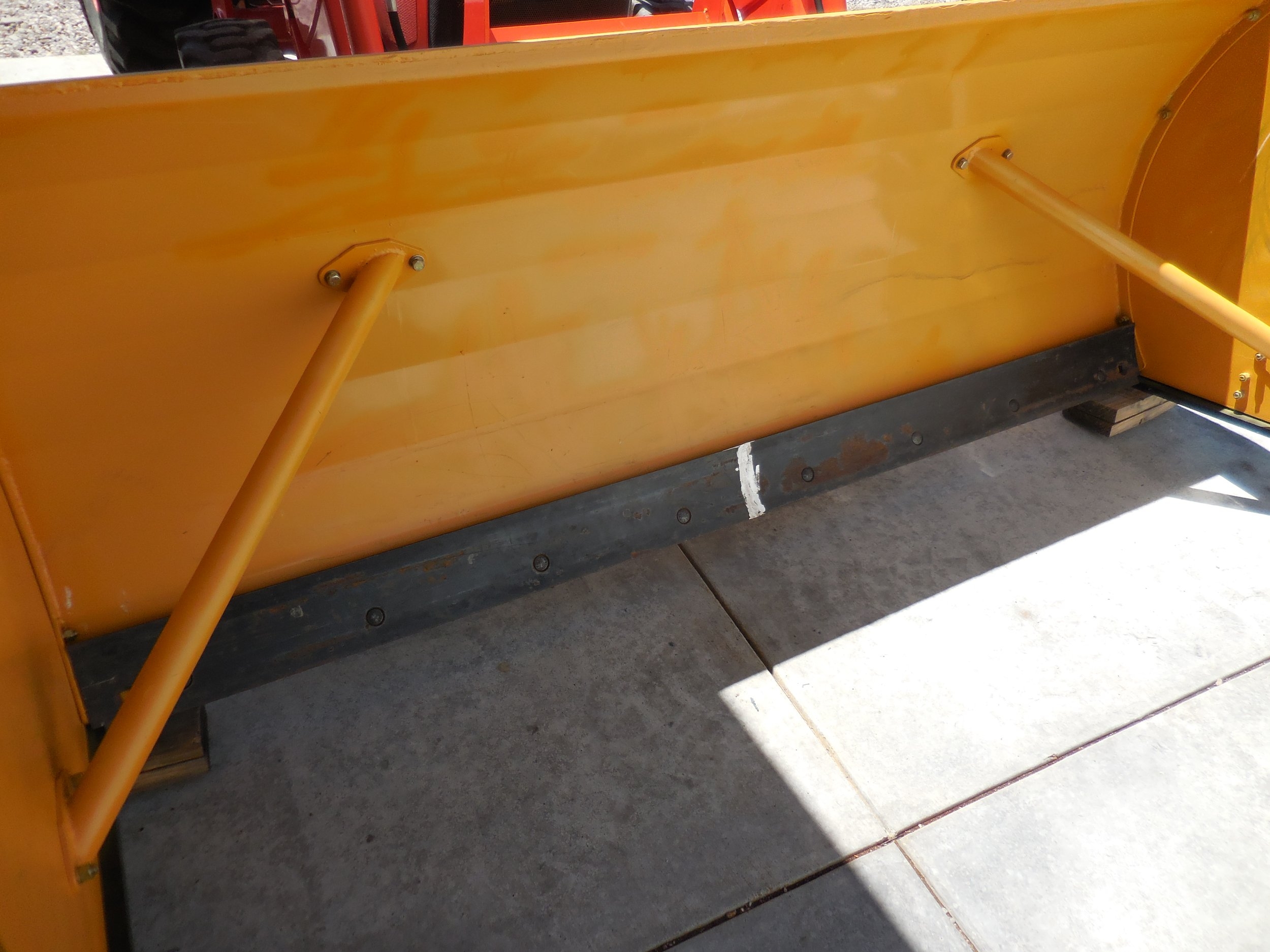

Cut a piece of pvc pipe and mount it on the bottom of the blade. Saves money by not having to buy ski shoes
How long did your piece of PVC last? At about 5 degree air temp, the piece I tried made it about 5 minutes before it shattered. Maybe CPVC, the grey stuff (or Non metallic Electrical tubing) would be a better choice.

Same. I've tried ABS & PVC. Neither lasts minutes. Not sure how people make that work unless they use some steel pipe.

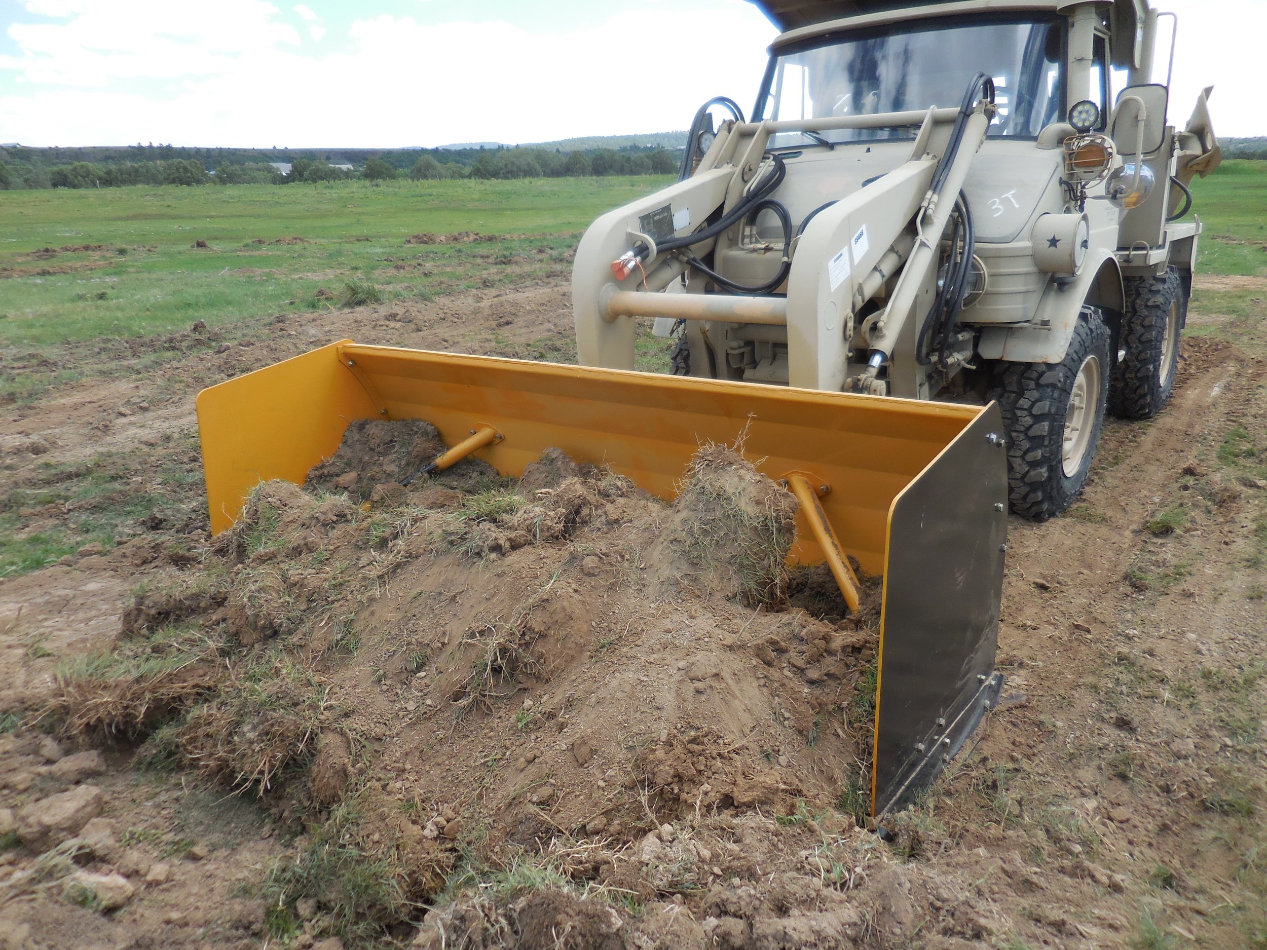

I got an 8-footer, primarily for using with a Unimog, then a 6' one that the L3800 can handle. They're great, I think.
Never used either on the driveway, but they sure are handy in the places where the snow needs to be "transported" for 100 feet or so. Like between buildings.
Also, I put cutting edges on both so they can be used for dirt, too.

I don't know where you live. SO........ if you plan on plowing before the driveway freezes up - rock hard - you will need some type of shoes/skids on the blade. Probably a good idea for any time you plow snow.
I use a rear blade. If my driveway is still soft - reverse the rear blade 180 degrees and plow in a normal, forward direction. I have a heavy Rhino rear blade that works well when reversed.
