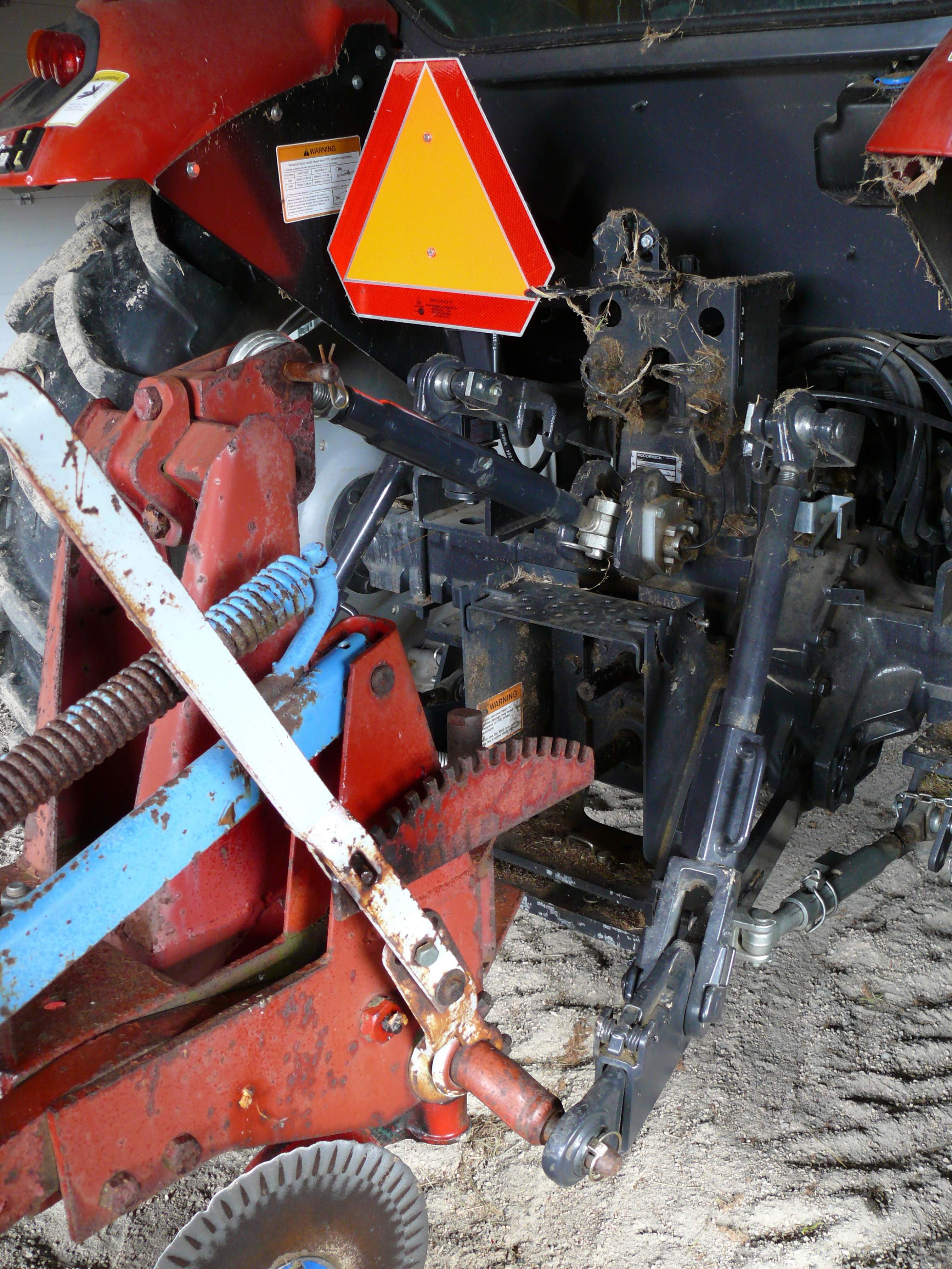

Re: Setting up a moldboard plow
With a mounted plow, the 3-point top link SHOULD be straight in line (front to rear) with the centerline of the tractor. There is SOME leeway with that, but "in a perfect world", it should be straight.
In that same "perfect world", you set the tractor to match the plow, and NOT the other way around. Any plow has what is called the "line of draft". That is essentially the center of the work load.... That lime of draft should be centered behind the tractor, THEN, the furrow side rear wheel of the tractor should be set just to the outside of the front bottom.
Width changes (increases) with a 3-bottom plow (or larger)
With the majority of newer tractors having all sorts of different tire combinations, (ie R4,s turfs, ect) and the lack of adjustability of track width, SOME deviation from "the rules" may be needed to get a plow to track behind any given tractor.
As far as the offset drawbar..... The offset is there to level the plow when furrow side wheels are in the furrow. Rotating that drawbar is NOT to be used to level the plow from side to side..... That's a job for the leveling cranks on the 3-point hitch. Rotating the offset drawbar will skew the rear of the plow left or right depending on which direction the drawbar is rotated. That will put more (or less) pressure against the landslides, which will in turn make the plow want to follow left of center or right of center. (and you DO NOT use stabilizer bars/links on the 3-point hitch to hold the plow where you want it.) Skew the rear towards the furrow and the plowtends to track to the LAND side, as pressure against the landslides decreased.. Skew the rear of the plow towards the land side, and the plow will track towards the furrow side, as pressure against the landslides is increased.
If you have more than enough tractor (weight and hp) for the particular plow you're using, it's possible for a tractor to "manhandle" the plow when it isn't in proper adjustment. If you're operating anywhere near peak draft load, a plow would need to be "by the book" or else it would pull like the proverbial boat anchor.
With a well designed plow, attached to the tractor correctly, and everything in proper adjustment, and the plow glides through the ground ALMOST effortlessly. Deviate from "perfect" very far and you suddenly have a fight on your hands.

Ah...ok so am i right in saying the leveling rules :
1) top link will control the horizontal plane - front to back
2) 3pt leveling cranks will control the horizontal plane - side to side
3) the offset plow bar will swing the rear of the plow one way or the other (left or right) to help ensure it tracks straight
/ First Time PLowing - Maybe this weekend #23
Dave5264: Ah...ok so am i right in saying the leveling rules :
1) top link will control the horizontal plane - front to back YES.
2) 3pt leveling cranks will control the horizontal plane - side to side YES
Only tractors with hydraulic T 'n T have adjustments on both sides, both usually Lifting Rods, not cranks.
Right Lifting Rod raises and lowers right side of mounted implement; left side of implement is slave.
3) the offset plow bar will swing the rear of the plow one way or the other (left or right) to help ensure it tracks straight.
Adjusted properly the plow will pull CENTERED, probably straight.

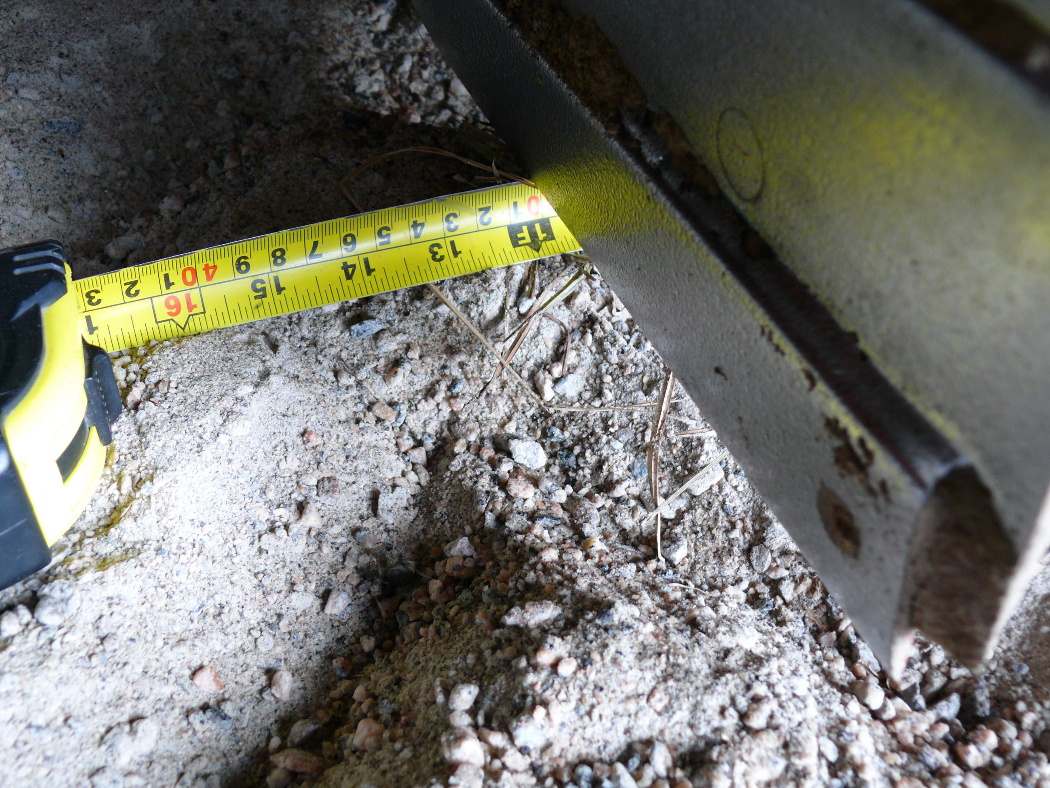

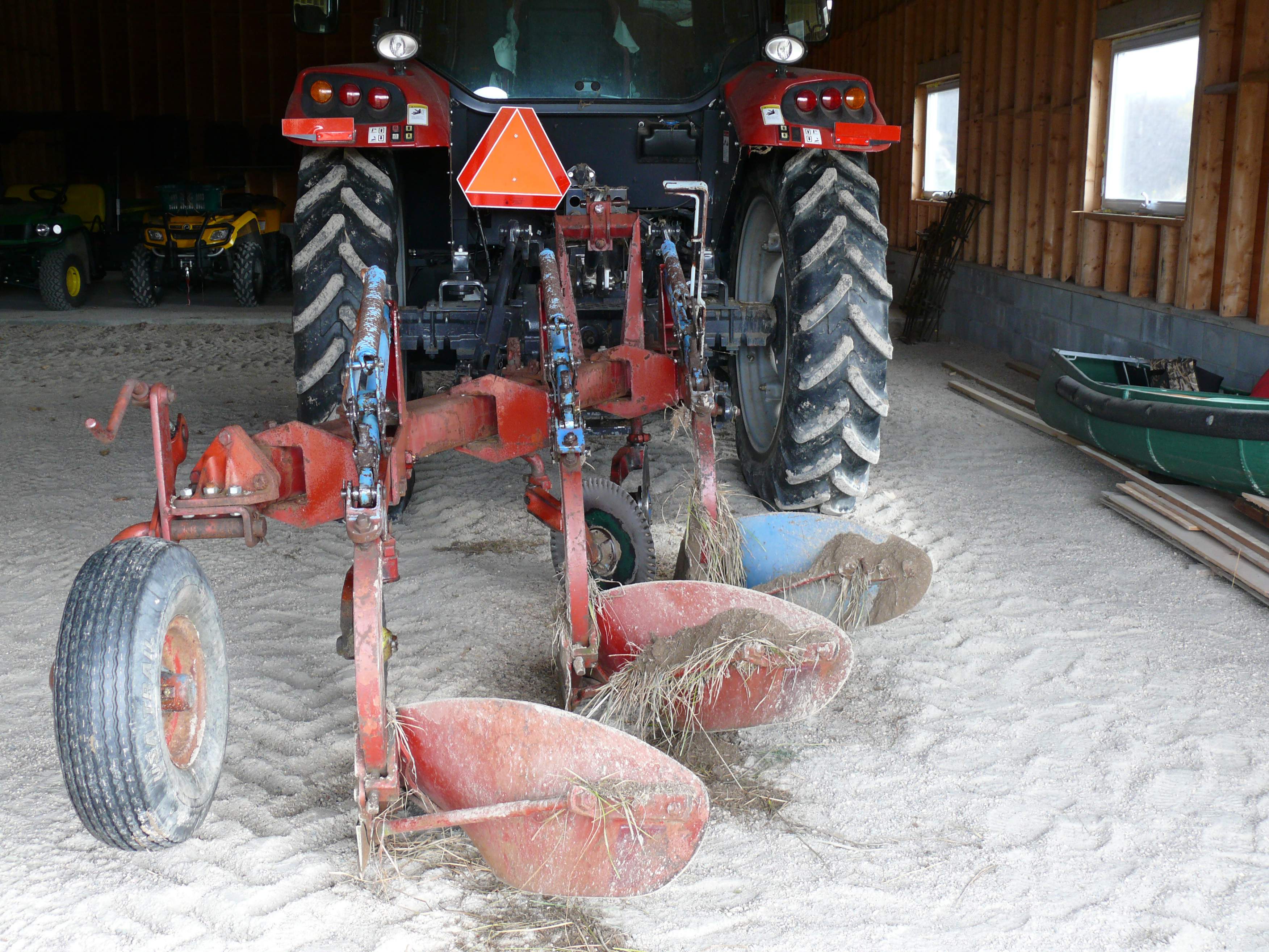

It appears to me in the picture from the rear, in post #13, there is quite a bit of gap between the end of the share, and the inside wall of the tire. It looks like it's taking too large of a cut on the first bottom, and possibly the reason the plow is skewing left. Hard to eyeball when your not there, or not the right camera angle.
You may need to remove the tire, then flip the center dish in to get the tractor adjusted to the plow.
I'm using the terms appears, possibly, and may, simply because from the angle of the pic, the brace bolt on the moldboard looks to be beyond the end of the share, but yet still 4"-6" from the inside of the tire. That would leave a lot of uncut dirt on the furrow floor, and cause a lot of crowd to the left. I'd think it would show some sort of gap/space between the last pass made, and the next pass. And, if there was sod flopping back down, I'd have to guess it would be on the first bottom because of the excess width it's trying to cut, not cutting the furrow floor clean, and not flipping it over.

Making progress, just plowed more field. Went much much better this time, Im at the correct depth, the tractor isnt man-handling the plow (cant even tell the plow is on the back). Far fewer roll backs on the sod.
my only adjustment at this point is to get the plow to track straighter, it still pushes to the let a bit, so Im getting a distinct 3 furows, 3 furrows, 3 furrows, 3 furrows look to my work vs just a sea of furrows.
#34
Any tips as to how to get rid of the 6" strips of un-plowed sod, with my setup ?.
Aside from taking off my Right side wheels and flipping them around to move the wheel closer to the first Share.
As i plow, the plow pushes left leaving me with a 6" strip of un plowed sod on every pass. so I get this 3 furrows, 3 furrows effect. Disking this in the spring is a pain in the butt.
I know Im not supposed tighten up the right side of the 3pt to allow less movement, maybe im not using the lever that controls the offset draw bar properly and thats causing my plow to track incorrectly
