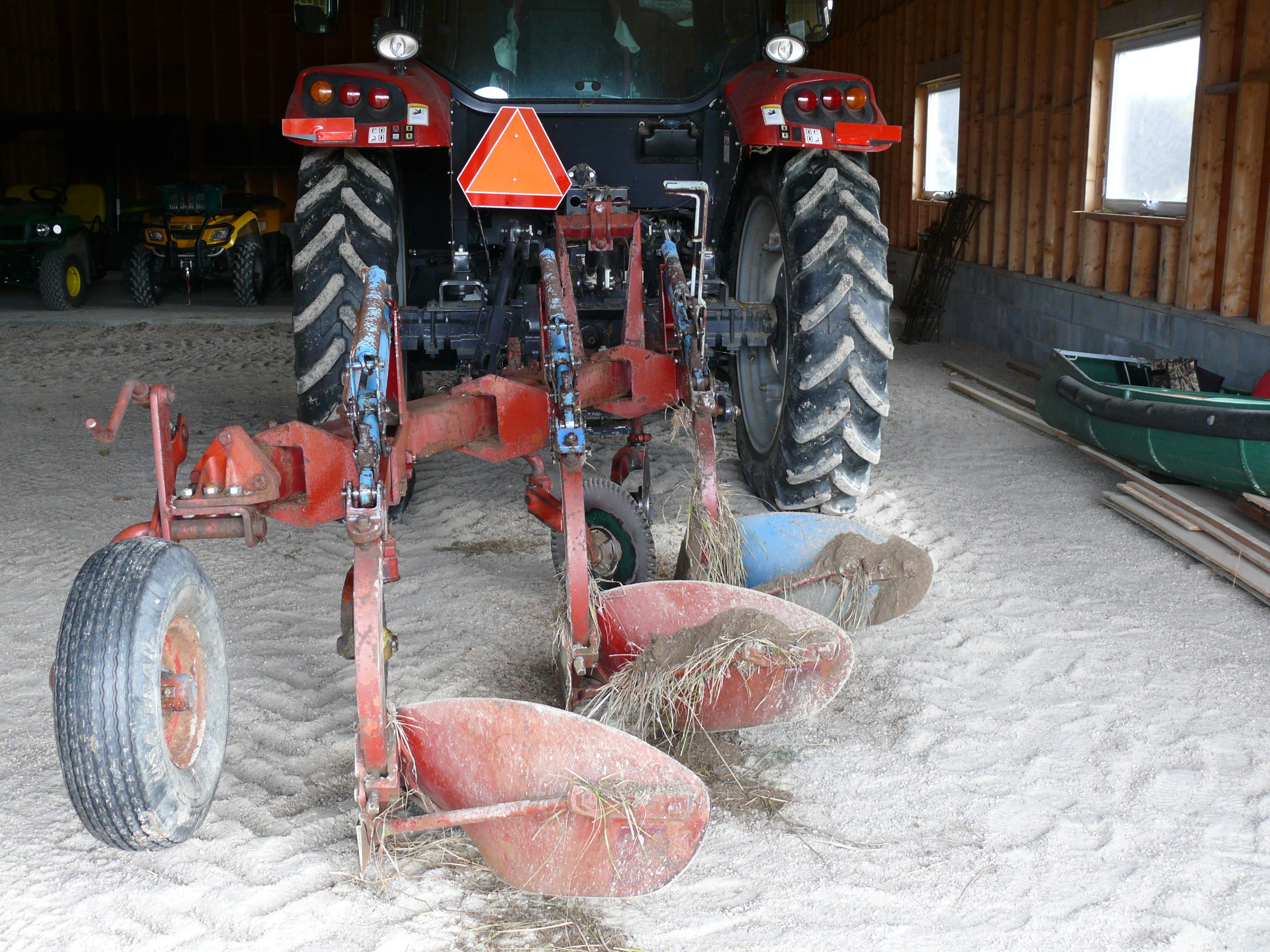

Hi All, Im goingto try plowing for the first time this weekend. I got a used 3 furrow plow in the summer (Swiss or swedish I think, cant recall the name, starts with an "o"), supposed to be an excellent plow.
Im using a 2011 McCormic CX100 Xtra Speed (build by Case) Tractor.
Ground is generally very heavy pure blue clay below the top soil, so ground is typically very hard in summer and awfully soft in spring after the thaw. Ive read its best to plow such ground in the fall.
We have had enough rain in the past few weeks to soften the ground up, so as long as its not wet this weekend I will give it a go.
Im going to do a 5 acre field to begin with, Ill start in the center and work out.
the plow has a depth wheel, So for setup i guess its a case of settign the right depth, leveling via the top link and knowing how far the drop the 3pt arms ?
I believe I have to make sure the side to side stablizers are not rigid but has slack to allow the plow to move a bit as well.
sounds simple enough but Im sure its easy to make a mess of it , any other tips ?

The bottom of the plough needs to be flat/level both fore and aft as well as side to side. If you have a firm flat area, try putting a block under the left wheel (as you're seated) so it mimics the Right wheel in the furrow. Now adjust the Right hand lift arm (it will have at least a turn buckle) shorter so that the three furrows all meet the ground at the same time.
Once you have your opening furrow you can adjust the length of the top link so that the plough frame and hence the bottom of the plough blade is level front to back.
Getting this correct can take some practice, but results in the tractor struggling less and the plough cutting neatly. If the ground is hard and the plough won't dig in, try adding weight to the back of the frame. Set the overall plough depth with the wheel so that once dropped in the hydraulics play no part unless a ferguson sensor is set to lift the plough when it struggles.
There are several youtube videos of how to setup a plough, it's a great skill to acquire and very satisfying when the plough runs true.

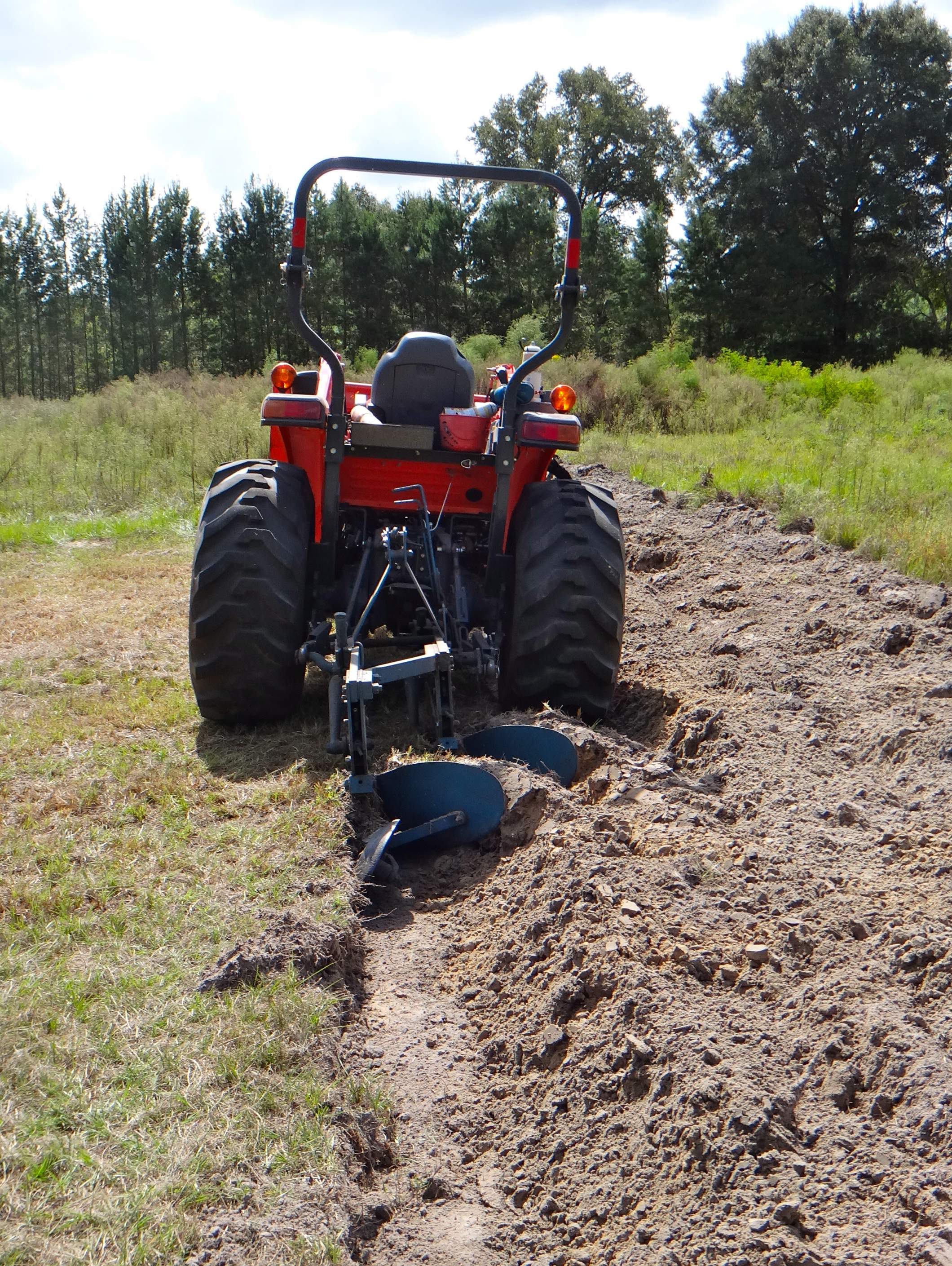

Your depth of cut is controlled by the pitch of the plow, set by the length of the Top Link.
After you have cut the first furrow, a 'throwaway' known as the Dead Furrow, put the RIGHT wheels of your tractor in the Dead Furrow, pull a few feet, then adjust the plow level, left-to-right (with the right Lifting Rod) and fore and aft, (with the Top Link) using a bubble level for reference. A bubble level is ultimately faster than trying to 'eye' level adjustment. You will have to stop tractor and adjust several times to achieve level in two planes.
(Note tilt on my tractor in photo with right wheel in furrow. Tractor tilt can be disconcerting at first.)
Once the plow is level in both planes set your plowing depth with SMALL adjustments of the Top Link. Shortening the Top Link will lower the front of the plow causing it to "suck" deeper.
A 12" plow will plow 5" to 7" deep.
A 14" plow will plow 6" to 8" deep.
A 16" plow will plow 7" to 9" deep.
PLOWS ARE NOT FLEXIBLE ABOUT TURNING SOIL PROPERLY OUTSIDE THESE 2" SPREADS.
Do NOT plow so deep that you bring up clay subsoil. Turn only top soil.
Only then adjust the gauge wheel (correctly: Rolling Landside), as final refinement. If you enter a competitive plowing contest you need the Rolling Landside to make the furrow wall perfect.
Plow adjustment takes time to learn. Do not be impatient with your early results.
PLOW ADJUSTMENT LINK: http://www.tractorbynet.com/forums/...oard-plow-wisdom-farmwithjunk.html?highlight=

Well, I read the manual, used the block under the rear left wheel to do initial setup.
after 2 acres (one small field), i score myself a 6 out of 10 on the result (ie could have looked worse), this small field is VERY uneven and in the low spots the sod rolled back (darn it).. I score myself 5 out of 10 on setup.
Setup - what i think i did wrong:
on the first 2 passes (Dead furrows) I had way too much sod roll back, I had the plow on left/right tilt/cant ready for the wheel to drop in the dead furrow, so I think I should have used the leveling lever to have the plow level with the tractor on the dead furrow passes and then off set it once i got the wheel in the dead furrow.
When I put the tractor and plow back in the shop and dropped the plow down, i noticed I was probable a bit too nose down and too aggressive (did initial setup on the driveway), I have now lengthened the top link a wee bit.
My main Question is this ---- > I did find the plow pushing to the left a lot, and subsequently I was having to compensate by steering left, coz the tractor wanted to go right. Im not sure if the plow being too canted left/right or the aggressive pitch (nose down) would have caused that ?? any ideas. I do know i shouldnt have to fight the plow. Of course with th eplow pushing left you dont always get 100% of the sod on the right.
I also think my 6.5 km/h plowing speed may be a wee bit slow ? should be up around 8km/h or 5 mp/h ?
Looking forward to the next field, it started to rain so I figured Id stop and get some more advice before round 2
let me know if you think my "fixes" for next time are on the right track , Thanks!!

What size, what brand, is your three bottom plow? Are the ground contact parts undistorted and matched?
Dave5264: I read the manual, used the block under the rear left wheel to do initial setup.
Did you use 'a' block or two (2) blocks, one under the left front wheel, one under the left rear wheel?
Use a Level to check level adjustments in both planes when you start Round II.
I doubt moving the Adjusting Lever (integral to some plows) would help. Its purpose is to adjust width of cut to space bottoms equally. (If we are comprehending the same lever.)
Or are you using incorrect/confusing nomenclature for the 3-Pt. Right Lifting Rod?
Was your 'dead' furrow the correct depth (+/-) for the width of your plow? Reasonably even depth? (If the tractor wheels are going up and down, the plow will move up and down in response.
Good. If you only used one block under the left rear wheel, rather than blocking both the rear and front wheels for pre-adjustment, too nose down highly probable.
Adjusting Lever, which sets width of plow furrows so they do not overlap, probably would help here, IF the plow is centered behind your tractor.
Is the plow directly behind your tractor or offset to one side more than the other?
Is the Top Link falling naturally to the middle beam on the plow? Stabilizers a little loose?
Experiment a bit. Often I set the desired engine power with the hand throttle, then adjust speed over the ground by moving hydraulic 3-Pt. control lever just 1/8" in one direction or the other, depending on soil draft resistance.

Thanks, its a Swedish Overum plow.
im definitely plowing too deep. plow is 12" wide and im plowing 7-8 deep , i should be plowing 6"
Draft control set too deep maybe, and too aggressive on the top link ?
I didnt have the front left wheel blocked, so thanks for that.

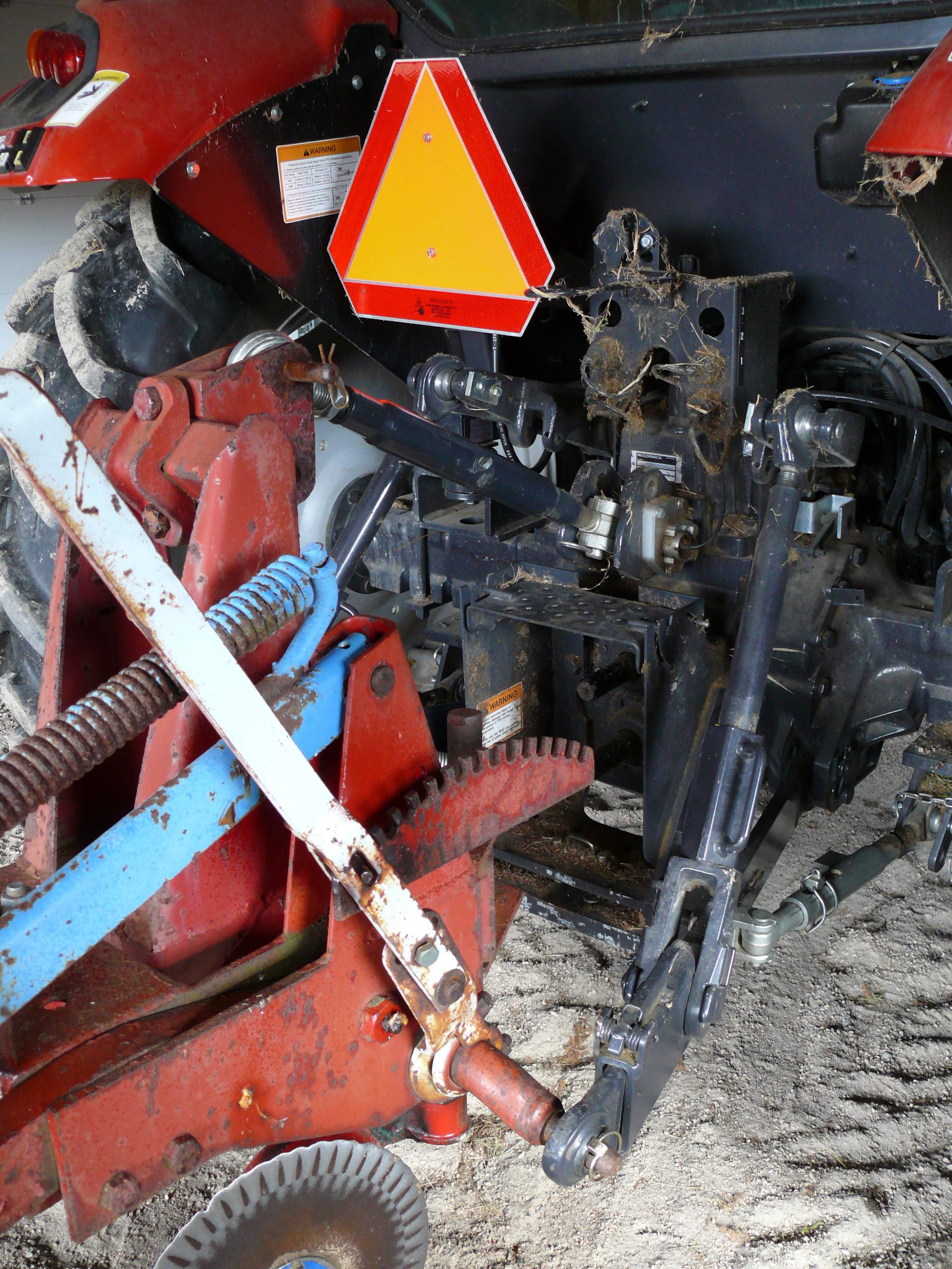

top link isnt naturally falling to the center the plow is pulling left, so the top link is going left. I have slack in the 3p arms, but that slack is taken up when the plow pulls left. plow is not centered behind the tractor like it needs to be.
the lever on the plow rotates the offset 3 pt link side arms on the plow, this allows the plow to tilt side to side --- my assumption was this was for dead furrow vs being in furrow...may be not

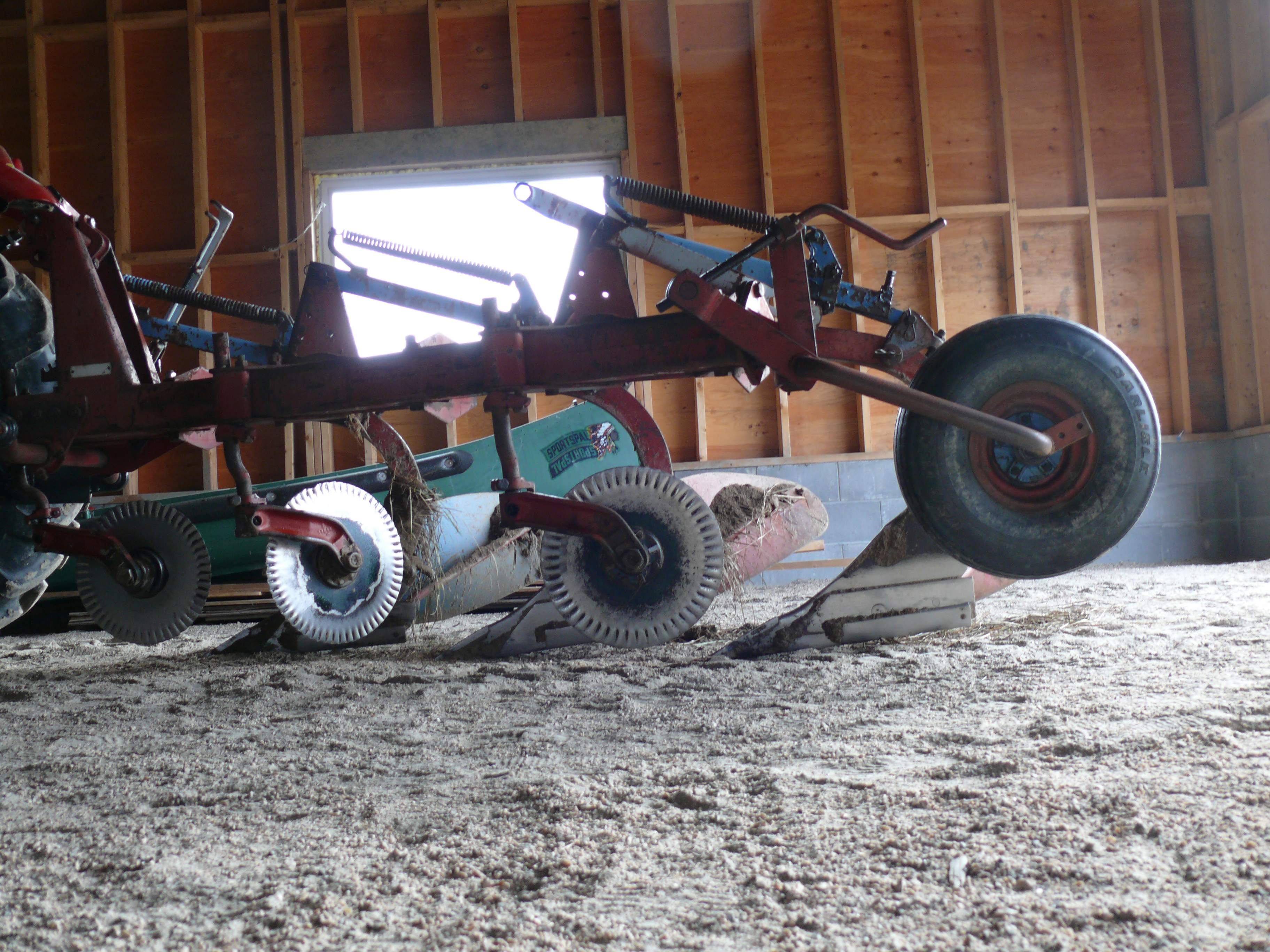

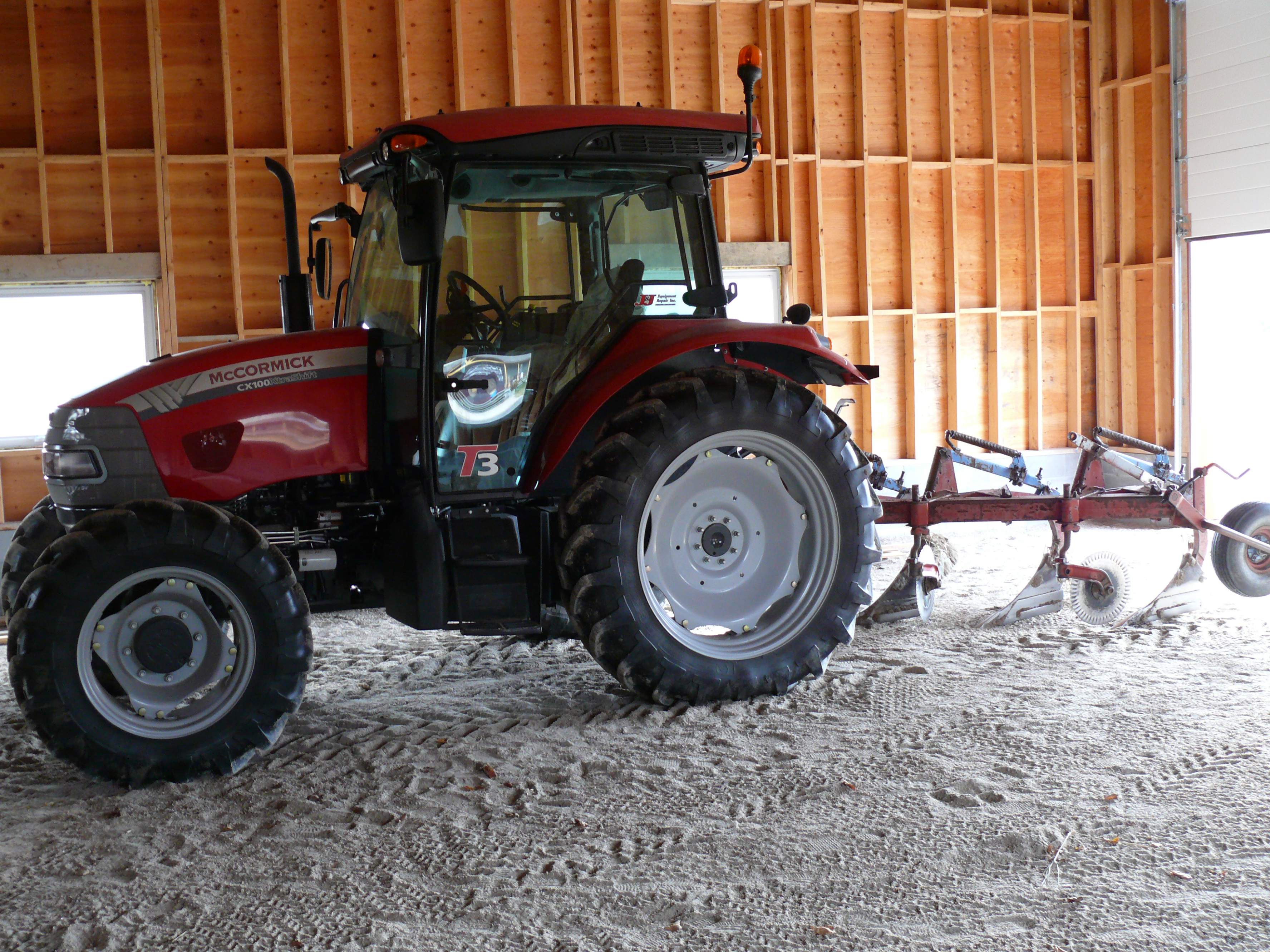

here are some pics of the rig & plow
the white lever controls the 3pt attachement pins on the plow, pull it all the way back (like pic 3 ) and th eplow is basically level side to side, push it forward and the left side drops down to allow the plow to be level when in furrow (i assume)
this is with the white lever all the way back (almost level...not quite), with it pushed forward the left side of the plow will drop
still a bit too short on top link....

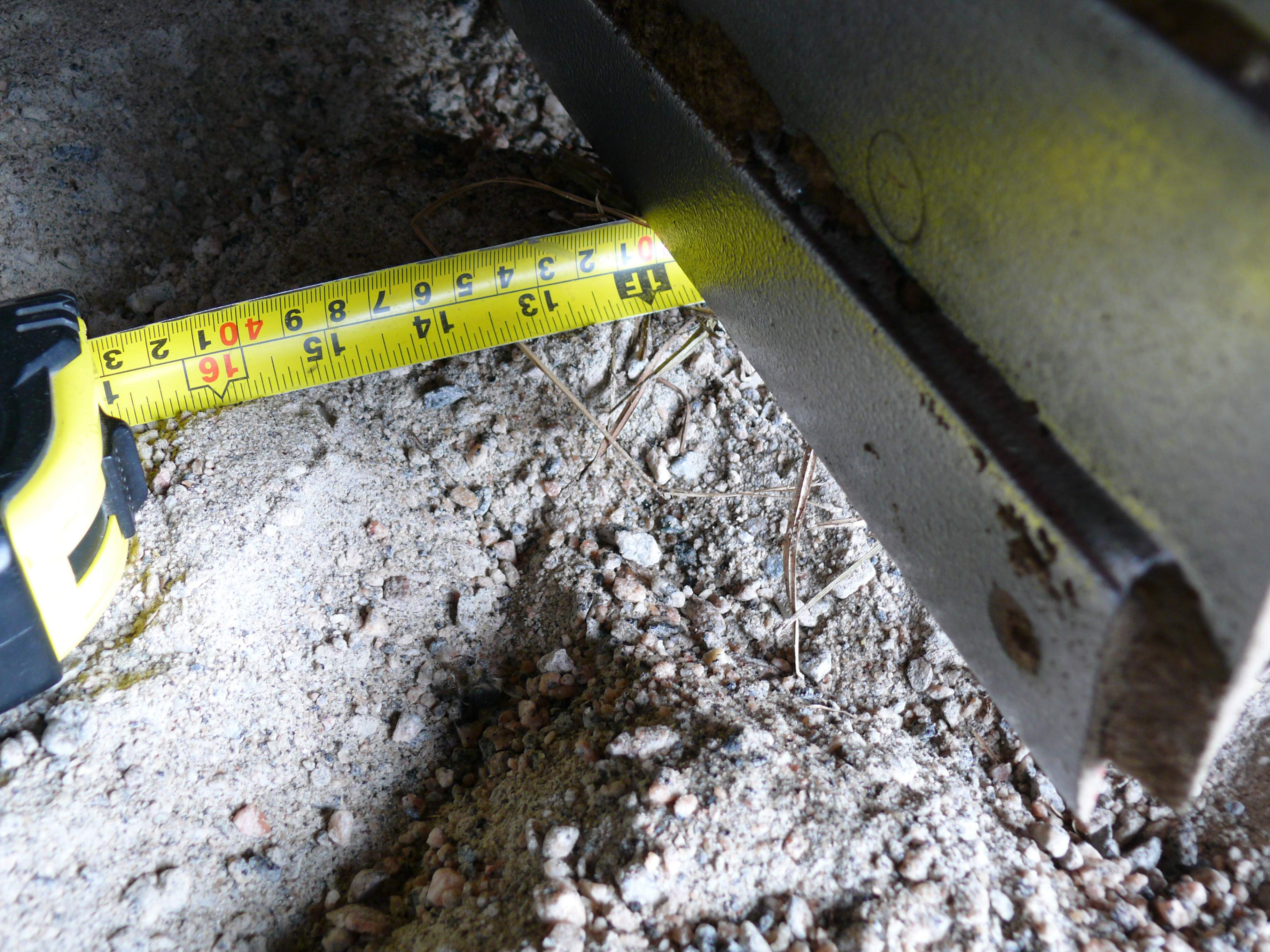

if im measuring in the right place, its a 12" plow so i should be 6" deep

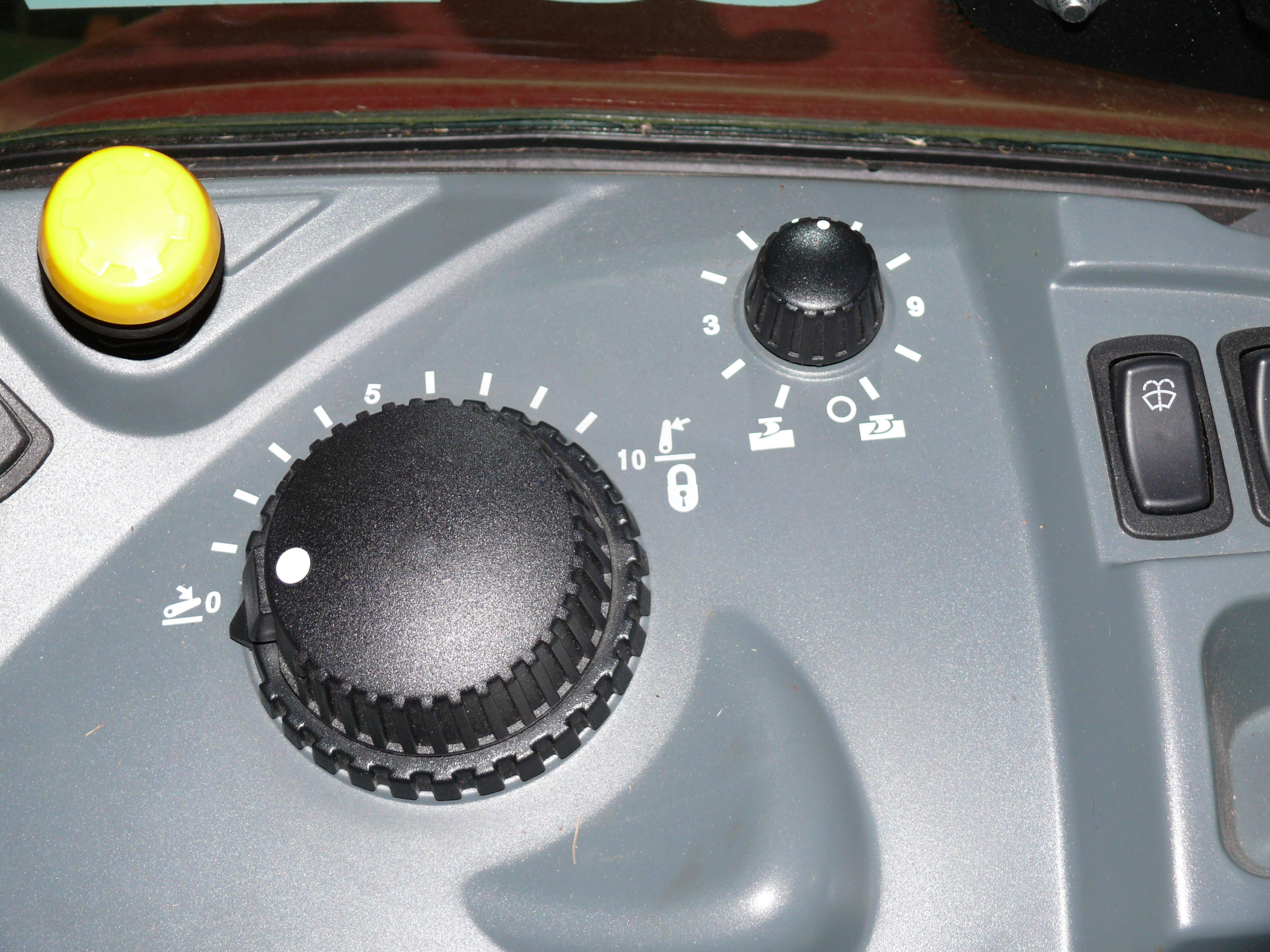

I was talking about draft control on your tractor it would be a second lever next to the one that raises your 3 pt hitch abd is usually between the fender and 3 pt lever
/ First Time PLowing - Maybe this weekend
#15

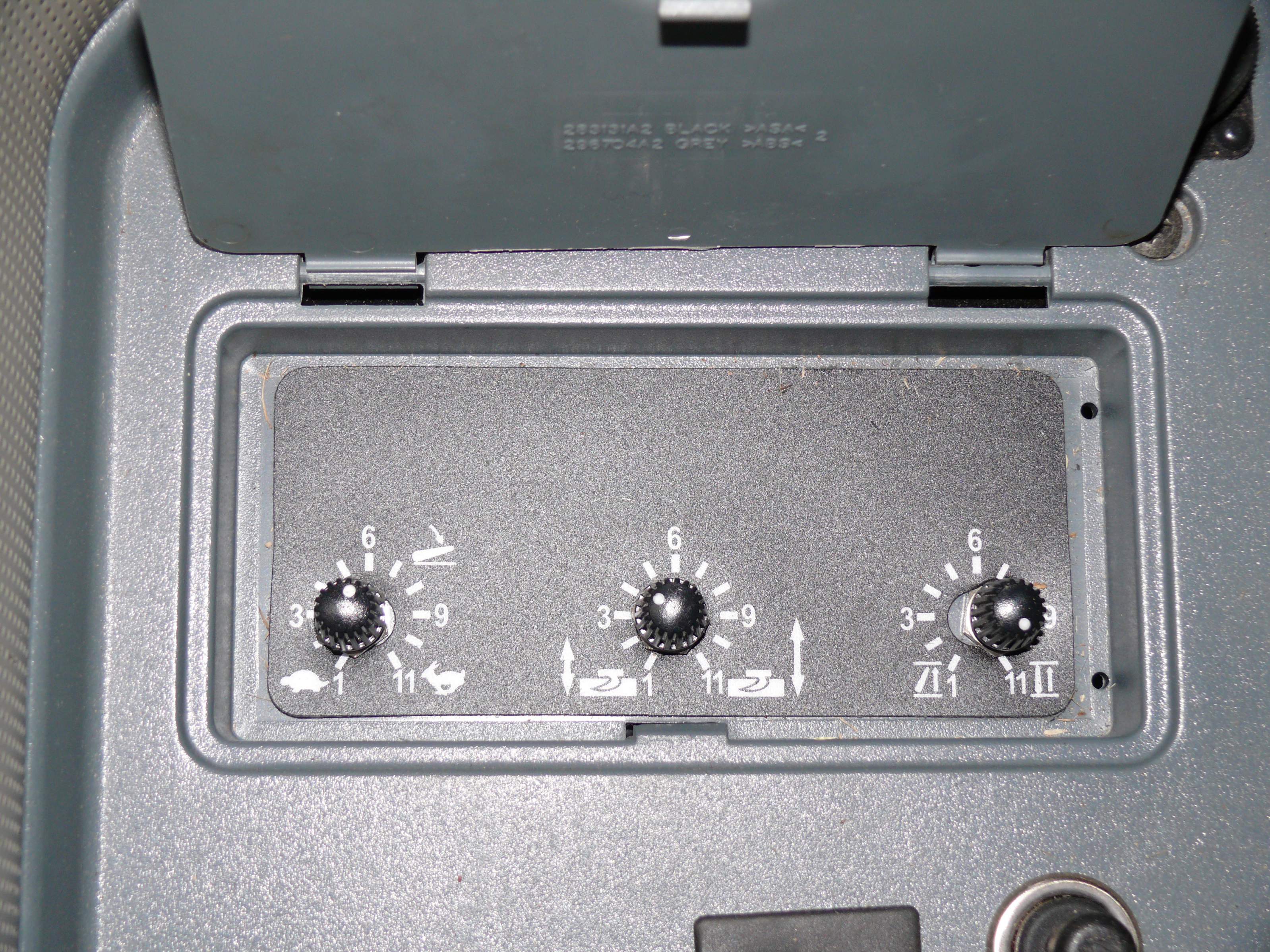

Yes, I have draft control, its a knob on my tractor console, as is position control (no levers). Draft Control knob was set a bit high, i have backed it off for the next time -- thanks
Position control on the left (bigger dial with inner and outer dials), Draft control on right, set closer to 7, should be 6
The center knob here controls how fast the pt draft control reacts to the change in the terrain, lower number means it takes longer to react :
/ First Time PLowing - Maybe this weekend #16
On mine I had it set to 5 or 6 in that range and that was with a 2 bottom 16 inch plow. On the first 2 passes if I start in the center of the field I would just leave it there. Every other year I would plow from the outside in

Your plow is a 3/12", Overum Plow
Think of a range, 5" to 7". You cannot hold steady 6" in varying soil.
If, if, IF the plow is level in two planes and you LENGTHEN the Top Link the front of the plow will run shallower. Express yourself in terms of long/short, which I can understand. Adjustment should be minor.
We will deal with the Draft Control after the plow is working well.
Most likely your plow is not level in the horizontal plane. Check it against a Bubble Level for reference. You really cannot adjust to level by 'eye'. Achieve level across plow by adjusting the 3-Pt. Right Lifting Rod.
It may require refininement by moving white adjusting lever somewhat to the rear from mid-point position, which will decrease width of cut AFTER the plow is level across.
If this does not center the plow, you may need to change the position of the adjustable cross bar to set the plow more to the center of your tractor, especially if plow was adjusted for a significantly larger or small tractor before you acquired it. This will require removing bolts from dog holes, moving the bar and tightening bolts into different dog holes.
((Or you can reposition your tractor wheels.))
On a Ford plow your white lever, attached to the "J bar" cross shaft is known as the Plow Adjustment Lever, sometimes as a Landing Lever. The Adjustment Lever sets the width of the furrow cuts, so there are no gaps between cuts and no overrun. Start with the Adjustment Lever in a center/middle position of its arc.
The cross shaft on most plows is adjustable/movable.
still a bit too short on top link….
Cannot tell, out of the ground.
Measure from the center of one plow beam to the center of the next plow beam, that is your plow width. 12" is most common width for compact tractor plows.
