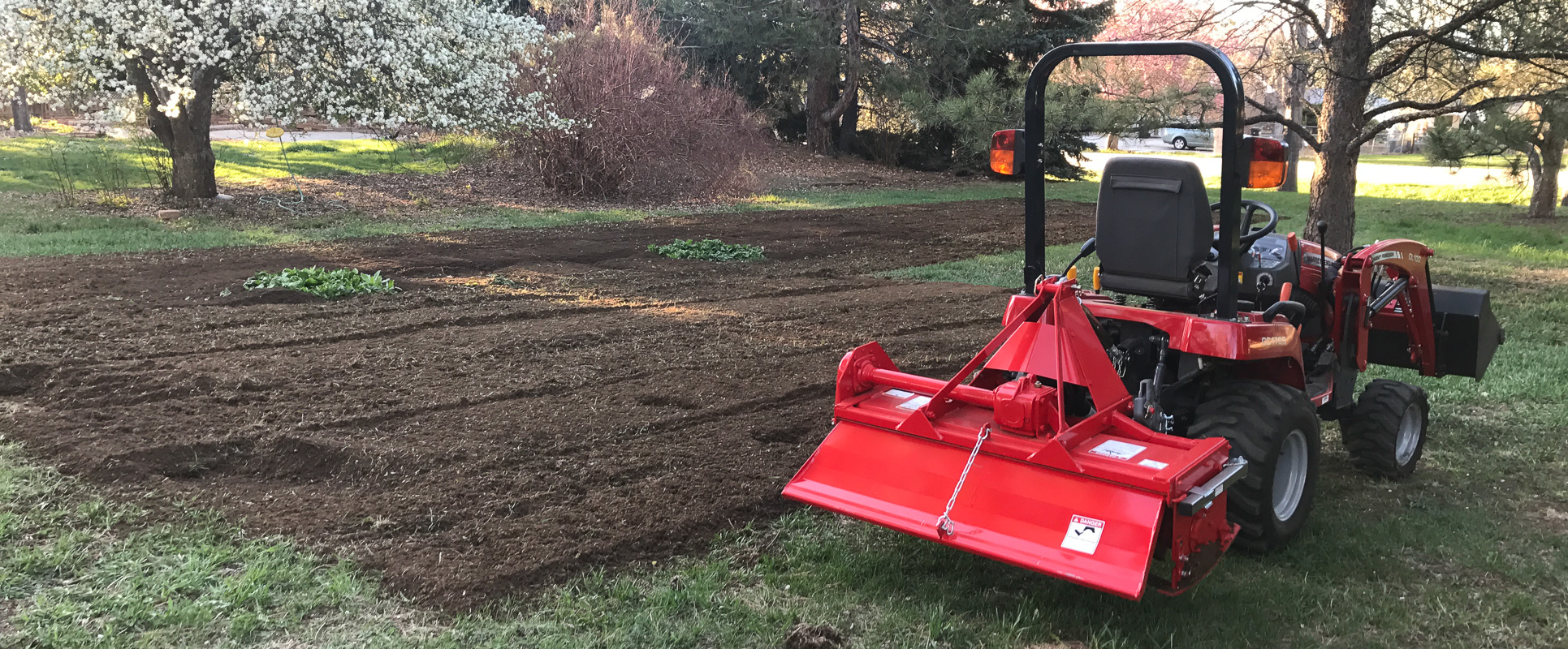

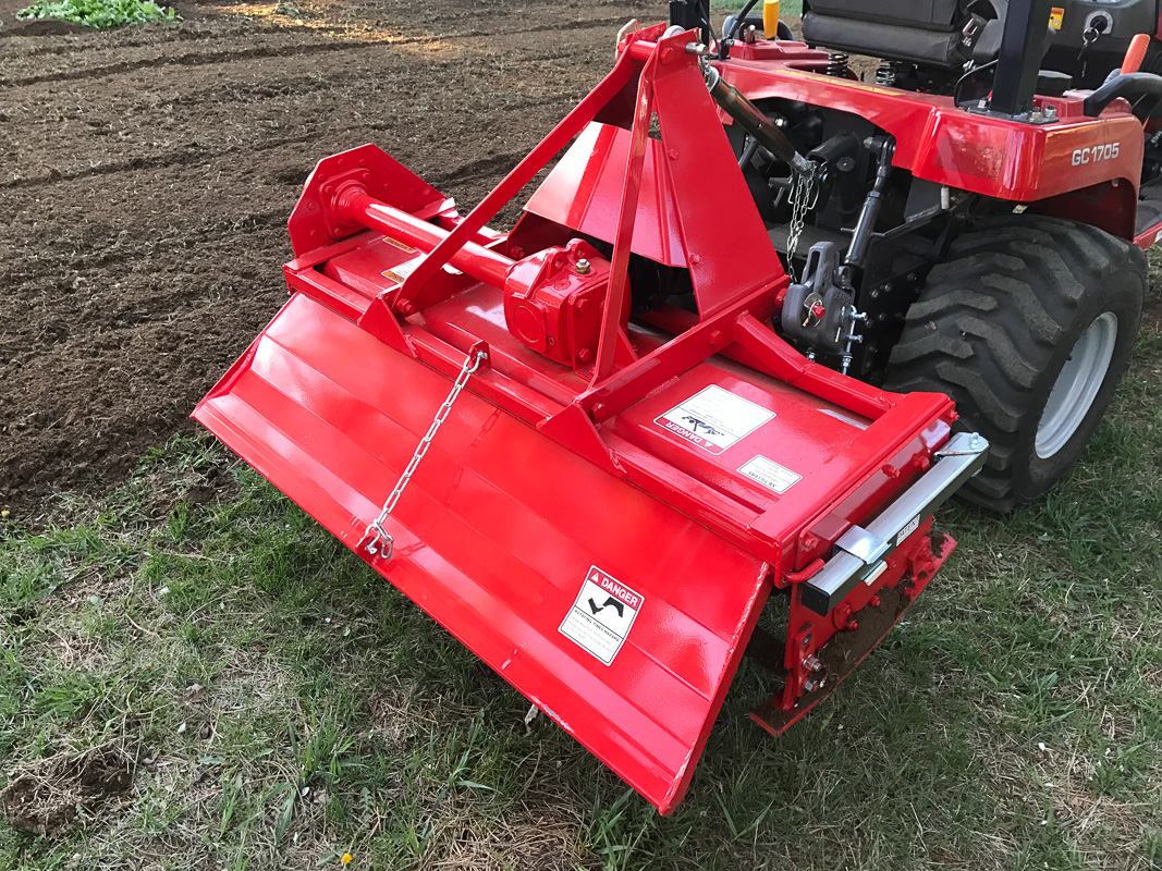

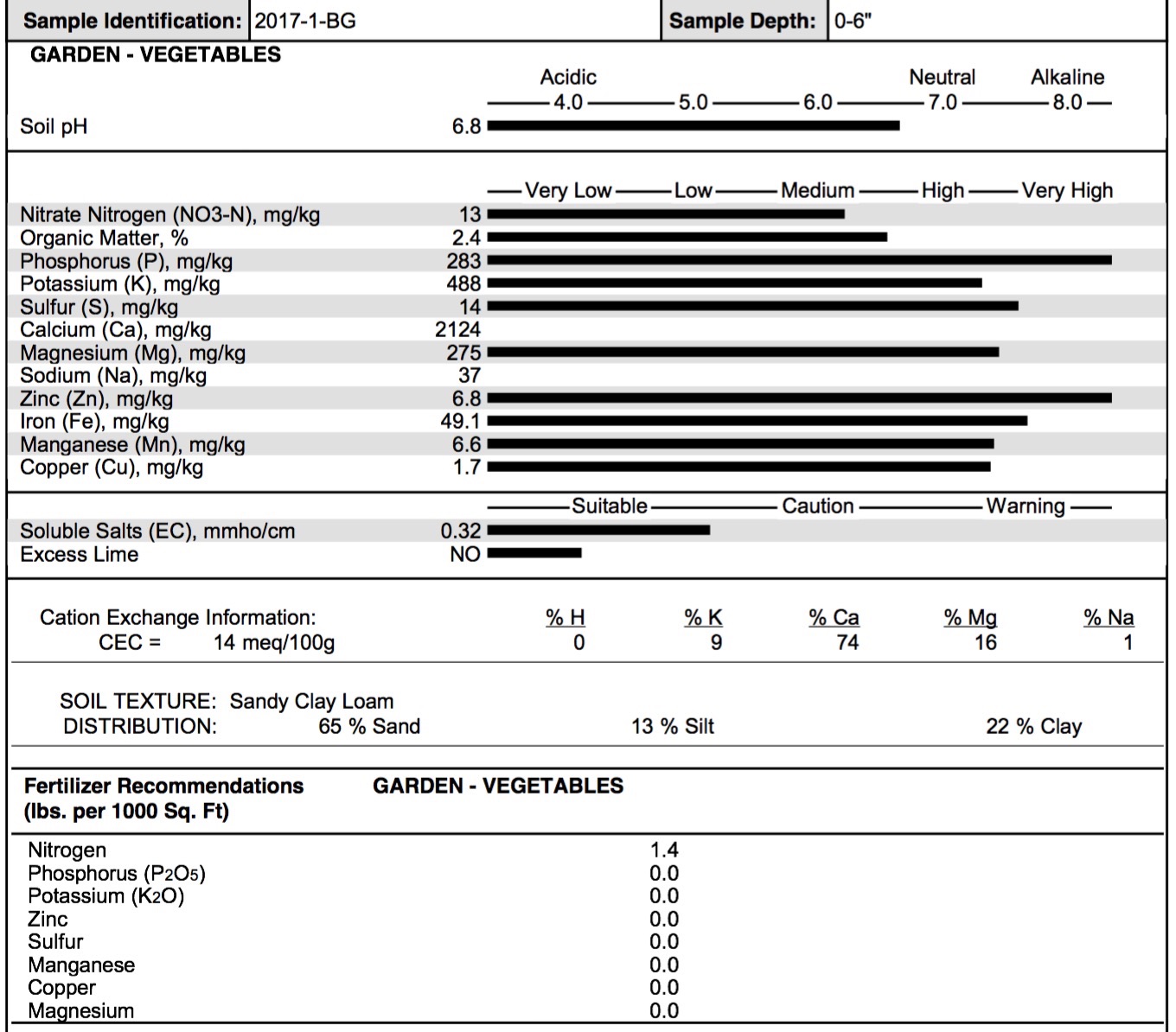

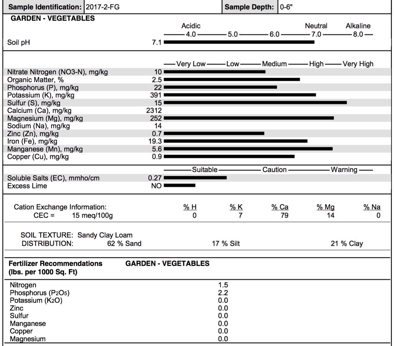

The lab did provide core recommendations for nutrients, but I don't have a sense of how much adding compost will affect that, what forms are best to add, and and for row planting, how you don't waste initial fertilization on the areas between the rows... perhaps another reason I need a walk-behind tiller. I included a couple images of the lab reports and a pic of the KK XB tiller, as requested. I ended up tilling the top 3" today, with hopes it might help with some of the grass die-off by next weekend. Yes, I have a bit of an issue with part of this given the trees, and that will have to change in future years!

The soil samples look pretty good imo. More organic matter would help and can be added each year to improve the moisture holding characteristics of the soil. Looks like nitrogen is about all you need and I would be careful not to over do it. I would consider adding some Aspen chips or saw dust to help retain some moisture, that would help. Spread a thick layer and till them in as deep as you can.

I tried tilling a test patch yesterday, and the tiller seemed to do well with the moisture in the soil. However, even with the feet all the way up, I could only get 2.5 inches deep with a single pass (pic below). Does this sound right? I wish it could go deeper on a single pass. Perhaps I'll have to make 3 passes with my tiller.

Thanks for the tilling speed info... I'll have to figure out what 1 or 1.5mph feels like! I did notice my XB tiller turns at 250RPM, vs the regular KK tillers turning at 210MPH, so maybe I'll have to move slightly (20%) faster.
I did have a soil test done, though think I need to find someone who can review my soil tests and advise what type amendments (other than compost) are best for my results. I am planning on rows, and need to figure out the fertilization approach with that. I probably will make a garden bedder next year, and may try plastic mulch then. leonz -- are your raised sections 18" wide or the space between them? Trying to figure out the best distance between and for the rows themselves, though I have heard 18" is typically good, with drip tape.
You can take off those 'feet' to till deeper if you want. Here is a video of me doing just that with the same XB tiller you have.
John Deere 1025R Deep Tilling with King Kutter XB (Who needs a plow?) - YouTube
I leave the skids on most of the time, but sometimes take them off when I want to till deeper.

Tim -- thanks for sharing that video. I had wondered if that would work out ok, without damage to the tiller. Looks like especially for previously cut ground, it works just fine.
