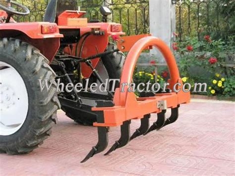

Our temps have gotten down to single digits. This past Friday we had a weird 53F as the high. The only thing to break the ground were the rippers late in the afternoon, and that was after several passes.
You got to have BEEFY shanks, else the cheap ones will snap apart.
- 1st pass 1-inch deep, don't let them sink, else you will have trouble getting un-stuck.
- 2nd pass might be the same.
- 3rd pass, you might be able to go a little deeper.
- 4th ....
- 5th .......

You might try it with box blade shanks. However; it will probably take many passes at shallow dept.
I had the great idea of digging up fire ant mounds in the winter and freeze the little critters to death.
As others said it was like trying to break up concrete.
