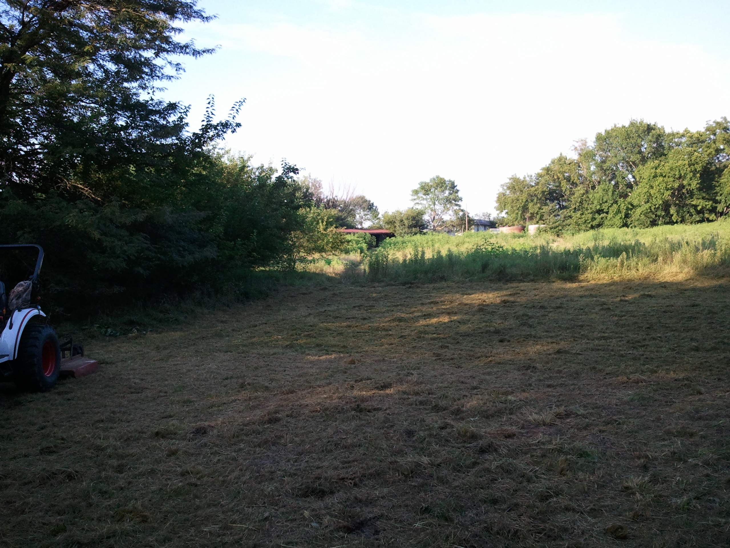

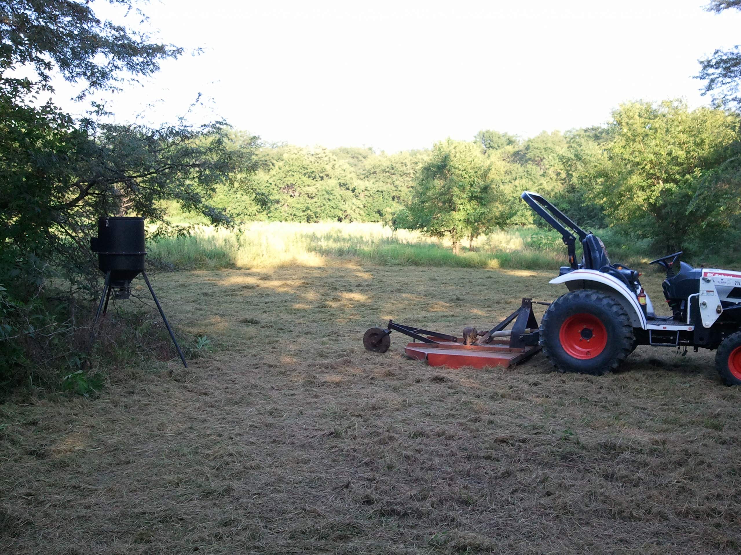

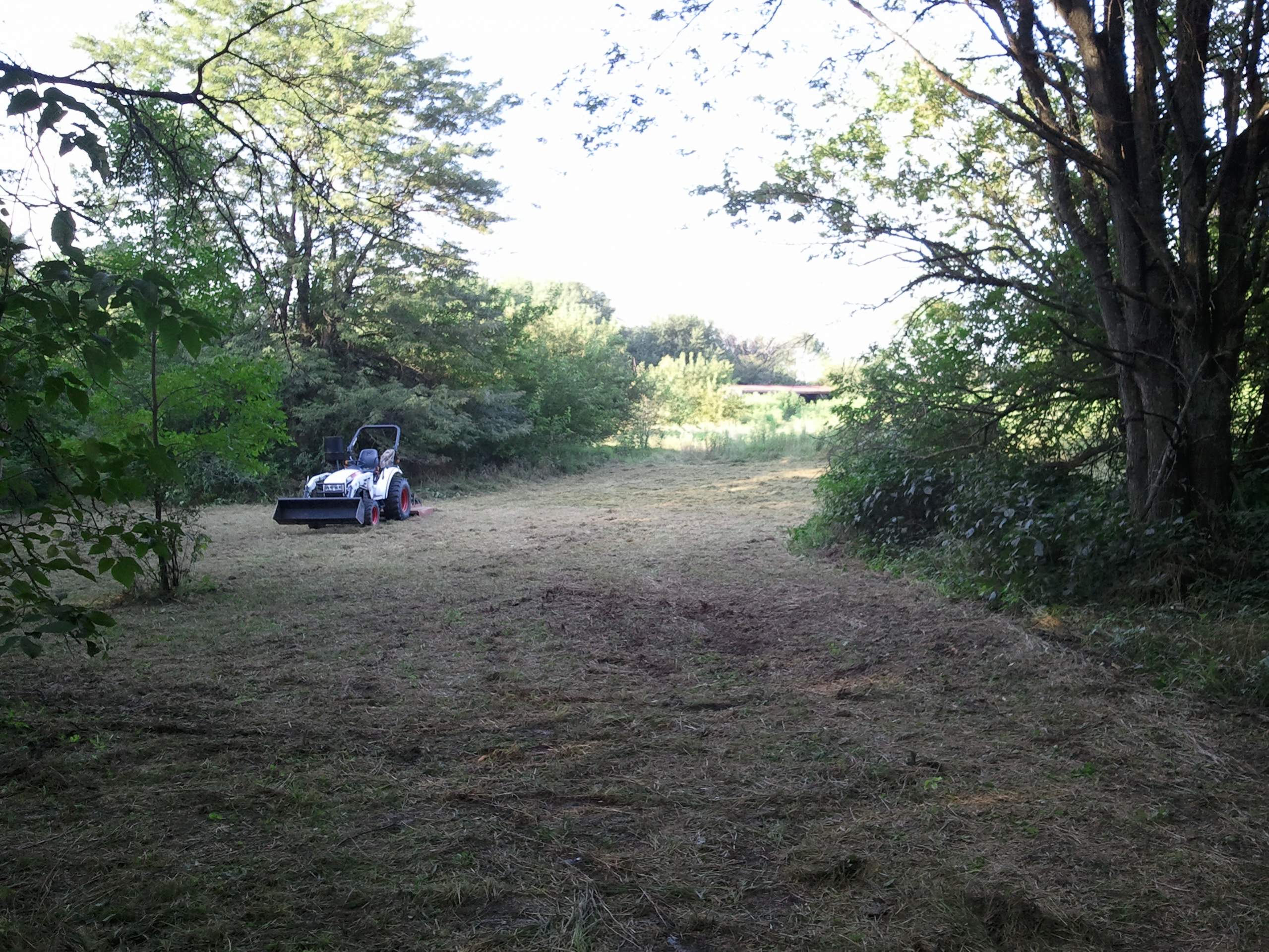

This is the first year that I am attempting to put in a food plot for deer hunting. I have selected an area that is a little over 1/4th of an acre, and am planning on putting in Evolved harvest Mega Plot seed, and maybe a couple strips of Whitetail Institutes Tall Tine Tubers. I have cleared and brush hogged the area down. Things that I have read say I should spray now with Roundup or equivelant, before I till it up. Do you think that is necessary? Or could I till, wait a week or so for the growth to start, then come in and spray to kill everything. I know I need to wait a week or so after I till to spray no matter what, I just am not sure about the first spraying if I am tilling the ground.
It is recommended to use a cultipacker after I till. I don't have access to one of these, nor do I have a lawn roller. Do you have any suggestions as to how I can prepare the seed bed? Would pulling a piece of telephone pole behind the tractor work, or piece of chain link fence?
My soil is at about a 6-6.5 Ph, so I'm not going to lime or fertilize it this year due to time restraints, and the fact that I am getting a late start. I plan on starting from scratch next year and going through all the proper steps, but this year is a bit of a trial run.
Here are a couple pics of the area I have selected.

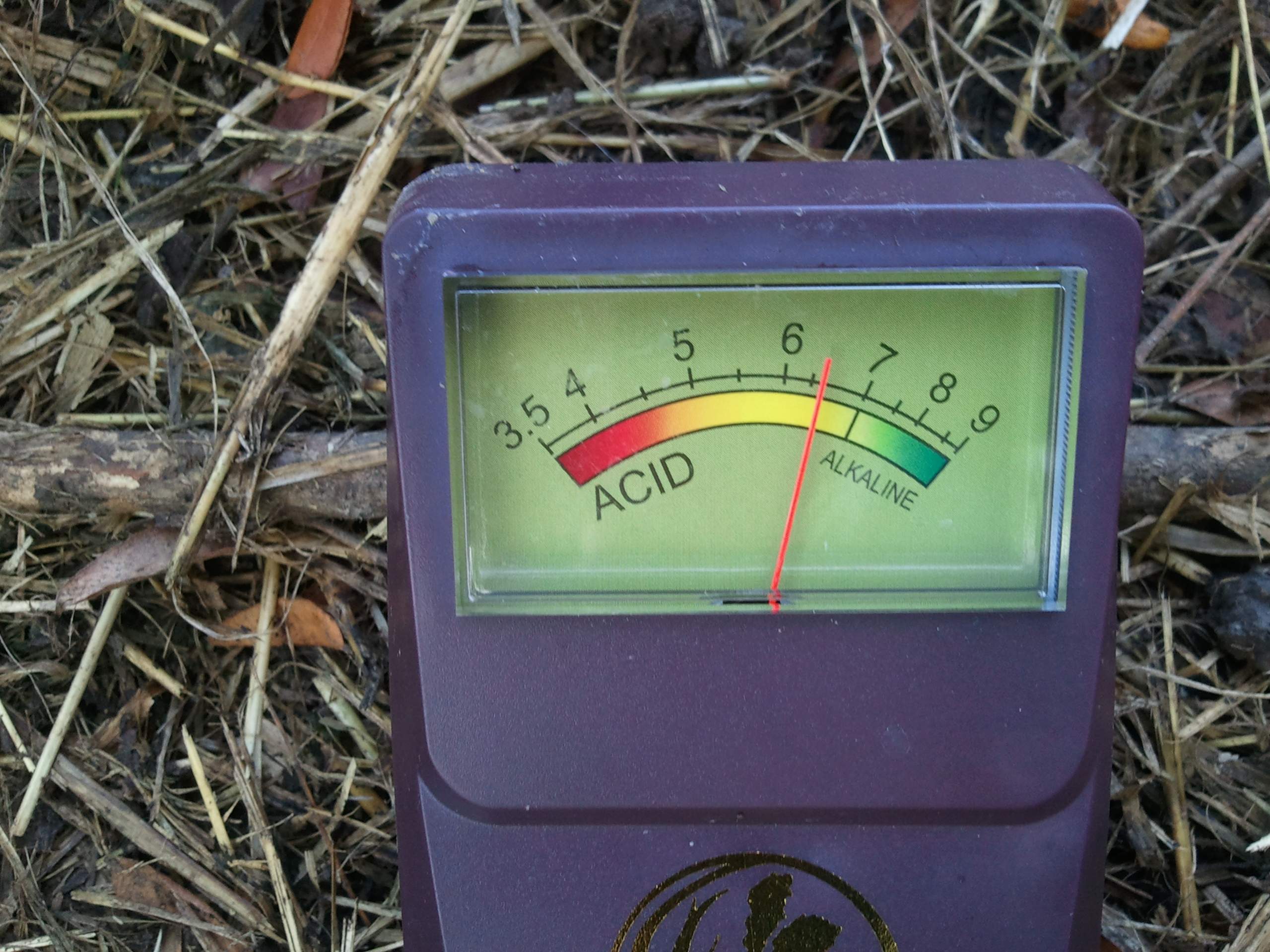

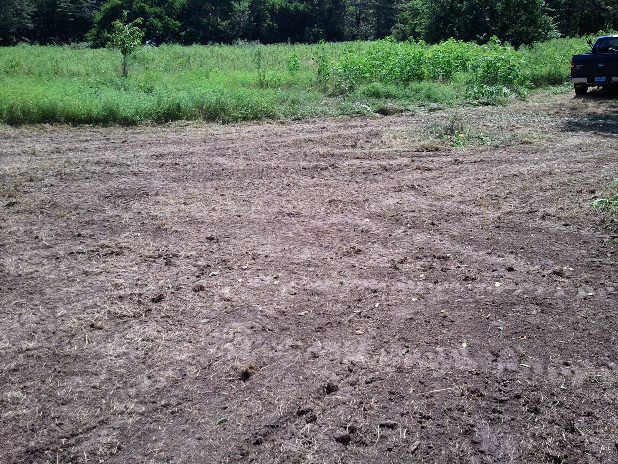

Ok, got some work done this weekend. I decided to take my box blade and scrape off all the cut grass from when I brush hogged. by lowering the scariffs down, it also helped bring up a lot of the root mass. I also took a Ph reading w. my ph meter. Looks like I am within tolerance for the seed I am planting.

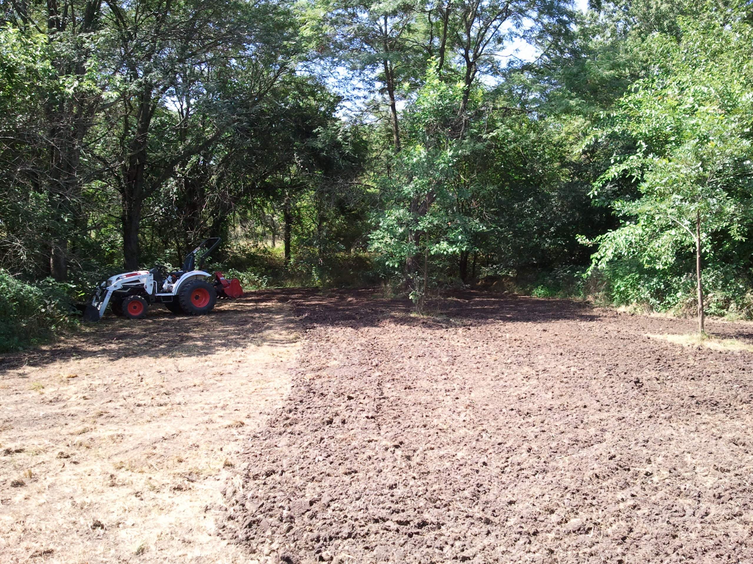

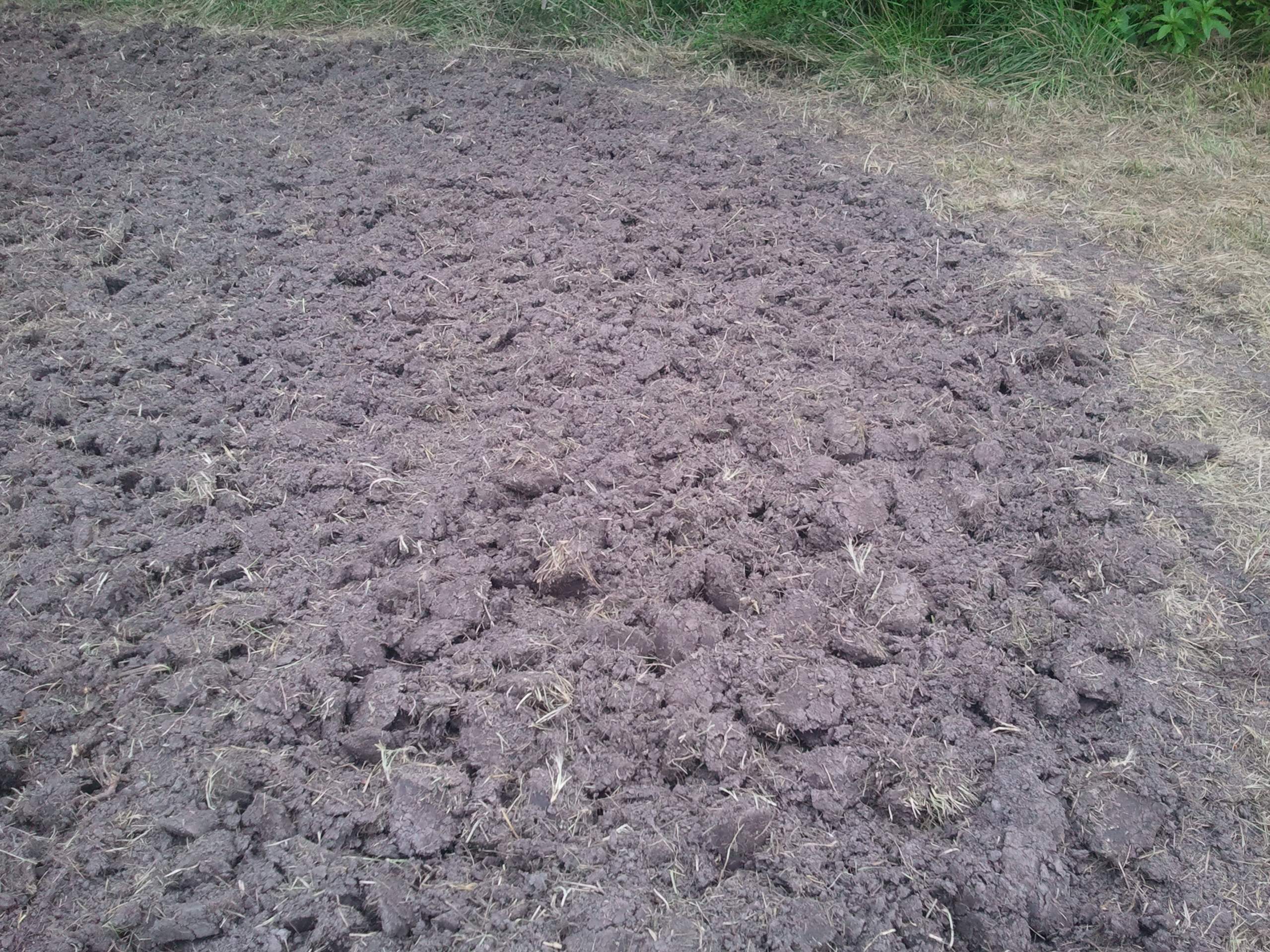

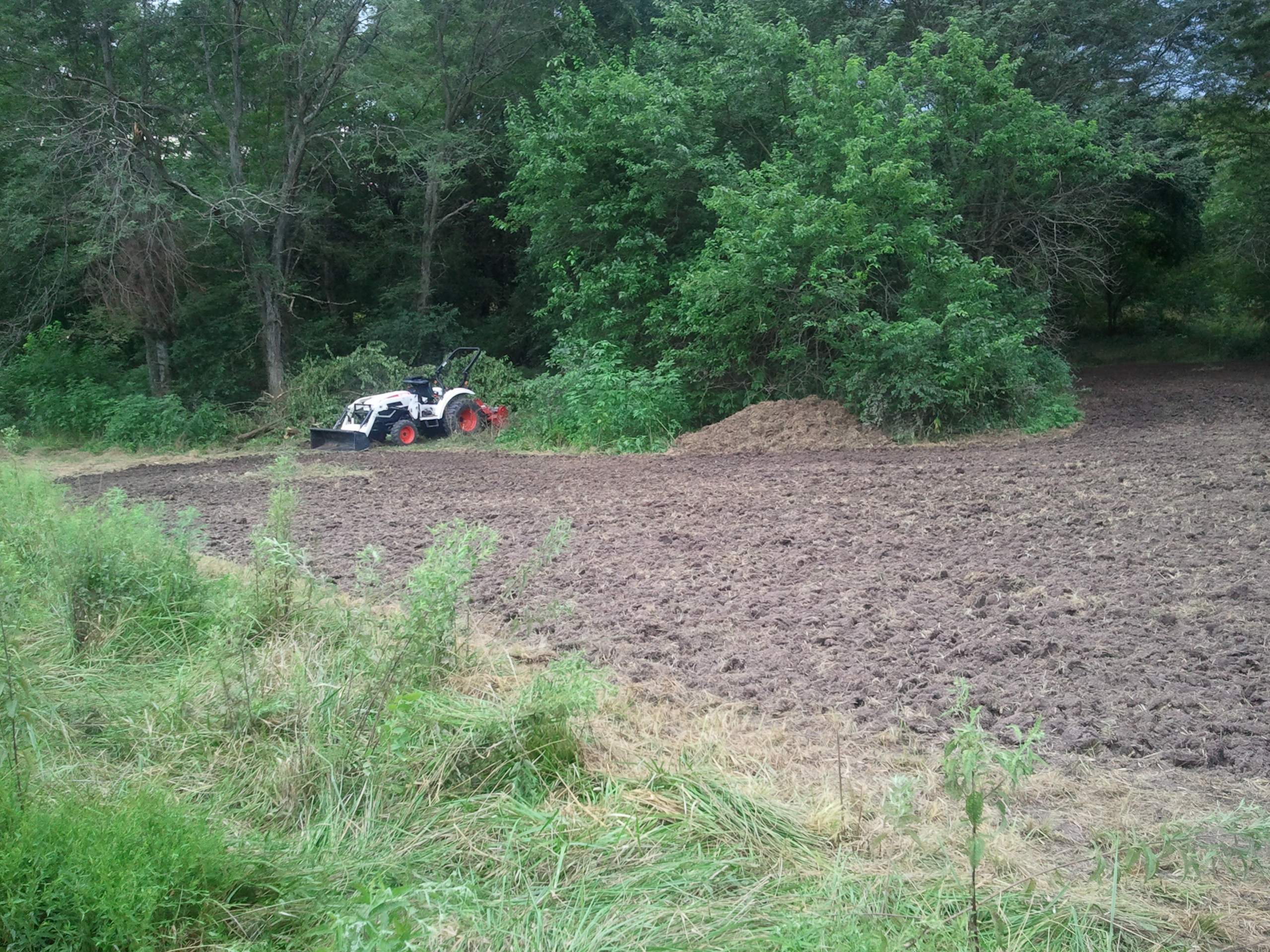

I let the ground dry out the rest of the day, then came back on Sunday and tilled the entire plot.

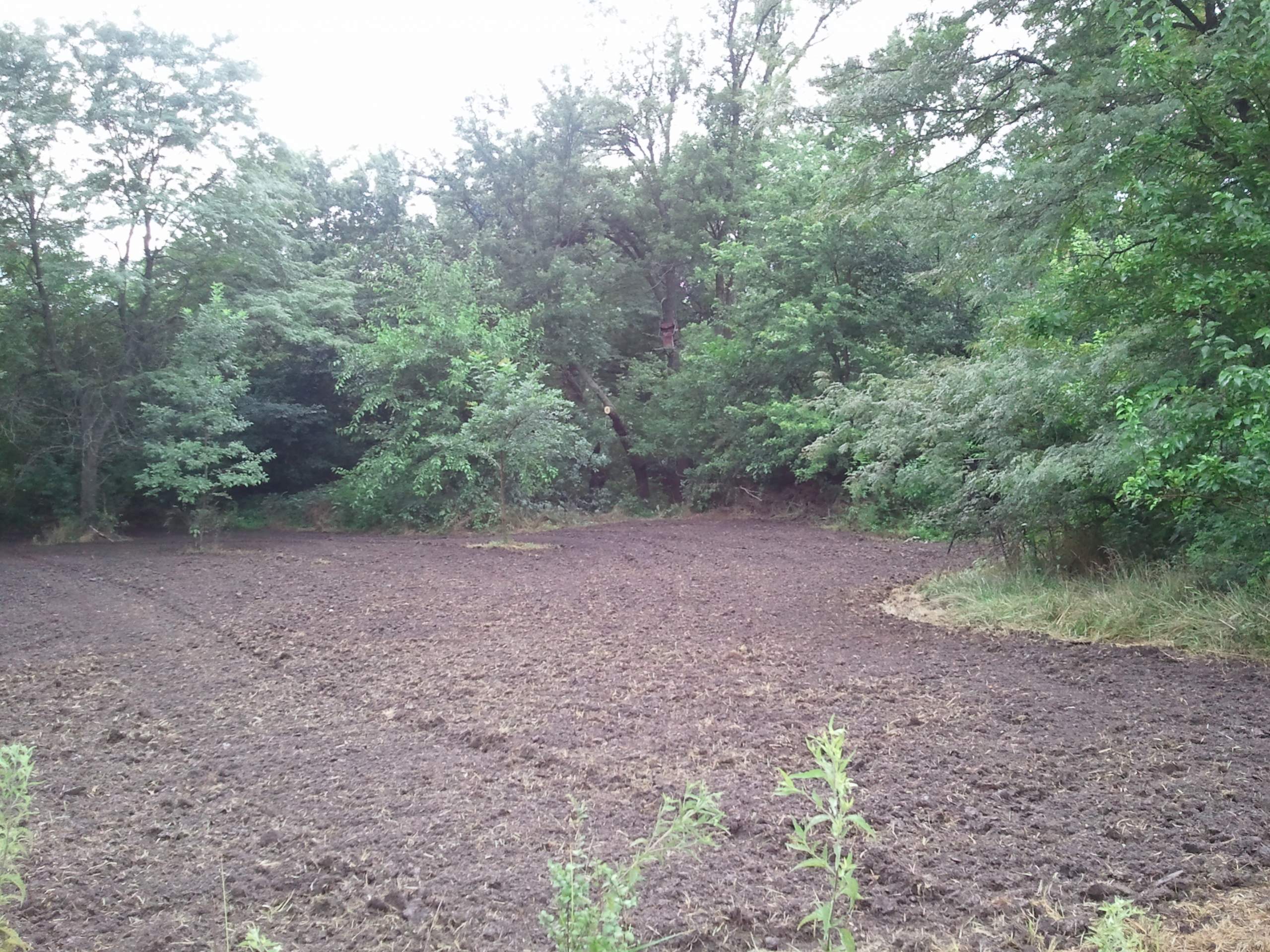

We took lunch, then came back, did some tree work, then got back to the tilling. Tilled it for the second time, and here is the food plot after the second tilling.
