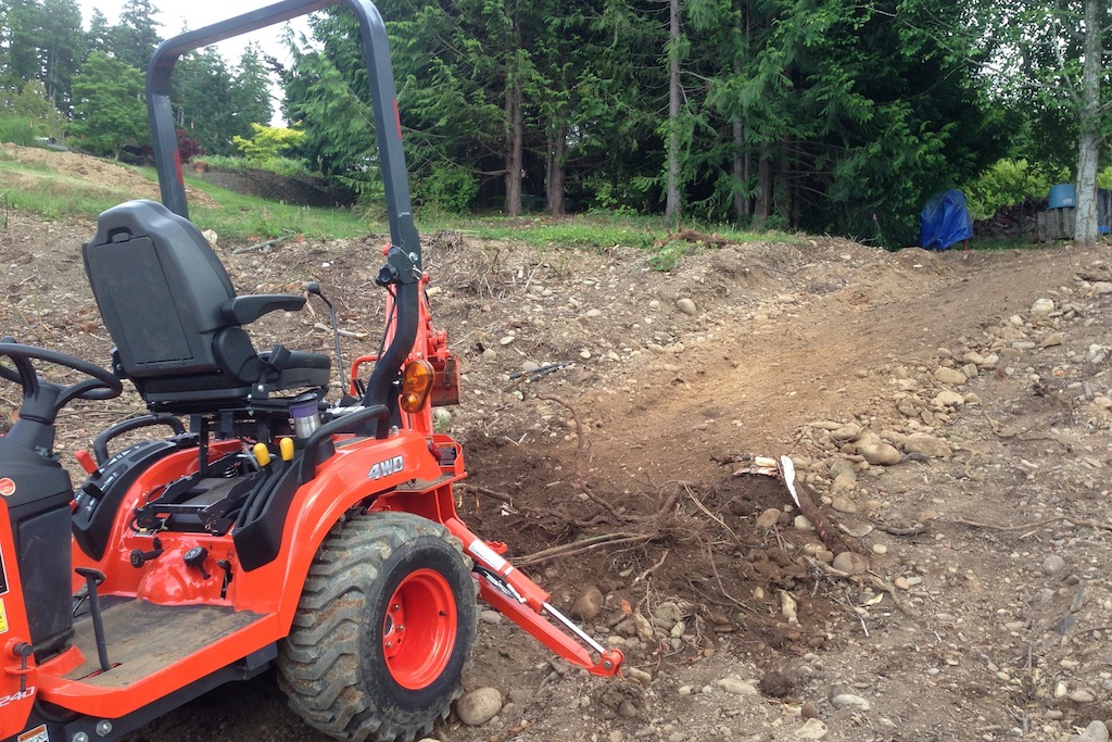

Hi Ryan, raining today so I am sadly idle, but I did finish roughing in my tractor path down the hill last night. I haven't measured yet, but guessing about 200ft long. Gotta love daylight at 10pm here in the Northwest! Here are a couple of my latest progress pics.
