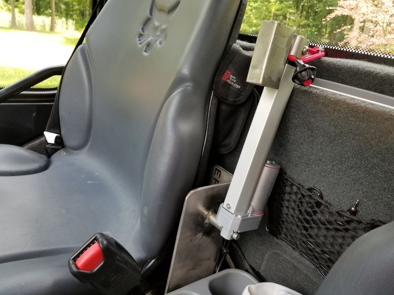

Thanks and welcome to the world of Toolcats.

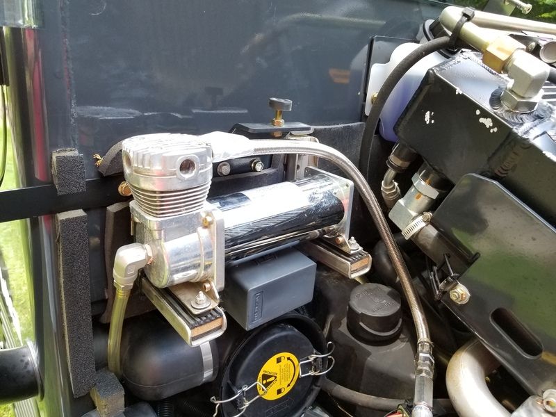

I looked at your pictures on Photobucket, first Toolcat I've seen with a onboard air compressor :thumbsup:.
Like the cup holder too.

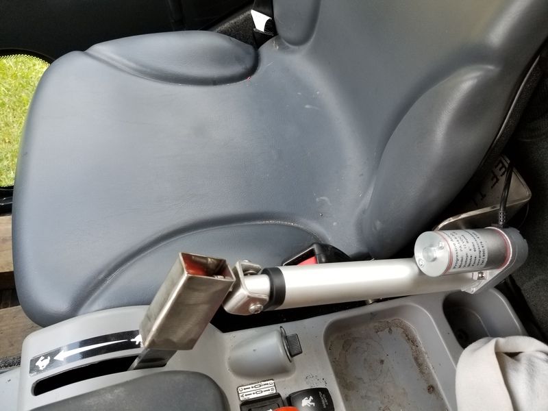

What is the story on the electric actuator controlled throttle?
You should start your own Toolcat Pictures thread :D.
Thanks a lot.

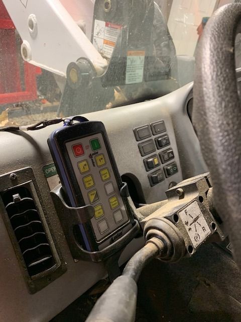

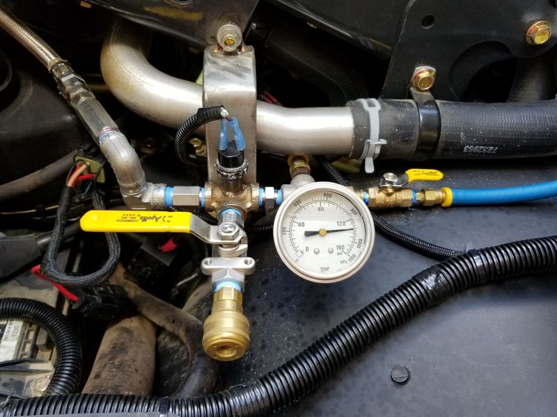

I needed air to operate the winch clutch remotely and seem to occasionally run across situations where onboard air is a wonderful convenience so I mounted the VIAir in a safe place and mounted a small tank under the floor board.

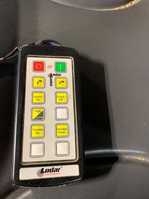

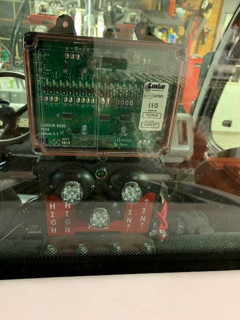

As for the 12 volt actuator on the throttle it is also part of the winch control. I purchased a Lodar 12volt remote control system and adapted it to run all the winch functions remotely. I can free the clutch, change from high to low speed, accelerate the engine, and of course spool in or out, all at up to 200' away from the TC.
Here a pic of it:
This pic is the control box (brains), through the rear window it didn't turn out well.

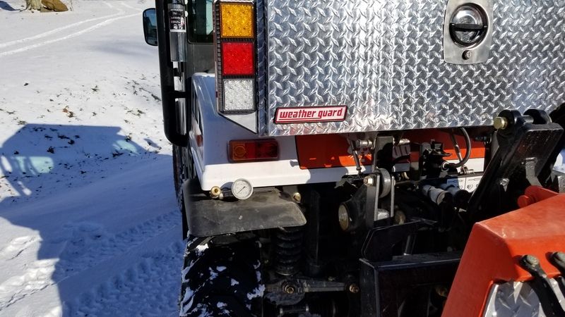

Thank you. The lights are all Rigid Industries, they are not cheap but I have done a lot of off road projects and they are built well. The rear one is branded Polaris but I really think it was also built by Rigid.
Thanks for the information. Also, your pics and description of the air system are really nice. You are a talented fabricator. Best of luck to you.
