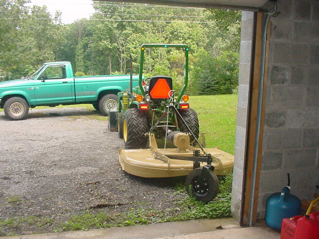

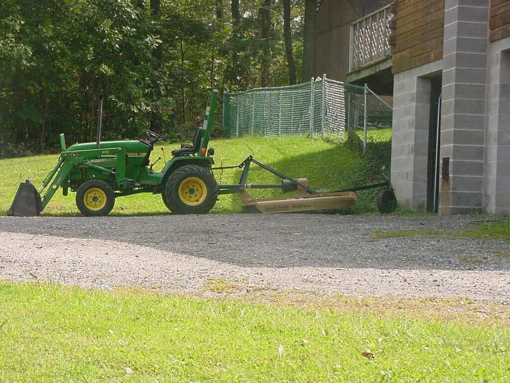

A Kubota B7510.
I bought my 5' cutter from a Kubota dealer who also sold Land Pride. I had a 16.5 HP Deere 670 based upon the dealer's assertion that they sold these 60" standard duty cutters to B7500 owners. Powerwise, the B7500 and 670 were very close.
Land Pride recommended 20 PTO HP minimum (4 HP per foot) and I was running it with 16.5 HP which is about 3½ HP per foot (the B7500 was about the same PTO HP).
The 670 did a fine job, so I think it's safe to assume the B7500 (now B7510) would do well too...at least as far as brush cutting.
The hindrance with the B7500 or B7510 might be the weight of the cutter if you wanted to transport with it raised. I could with my 670 (as long as the FEL was installed), but the 670 weighed a few hundred pounds more then the B7500. However, even with the 670 (and my current 790), I towed the cutter more often then transported it raised. This isn't something you'd want to do any great distance though.
Anyway...the question was what is the smallest tractor that can run a 5' cutter. Well, the Kubota B7500 is the machine.
That's if we're talking new tractors. Used Deeres would be the 755, 855, 670 and 770. The pictures attached show the 5' Land Pride rigged to the 670.

Roy,
Are the tires on your 790 what are called bar turfs?
/ First post, smallest tractor for 5' brush hog? #13
Iowachild said:
Roy,
Yes they are, and they worked quite well.
BTW, that's a Deere 670 which shares many components and sheet metal with the 790. The 790 is about 6-8 inches taller (mostly due to taller tires).

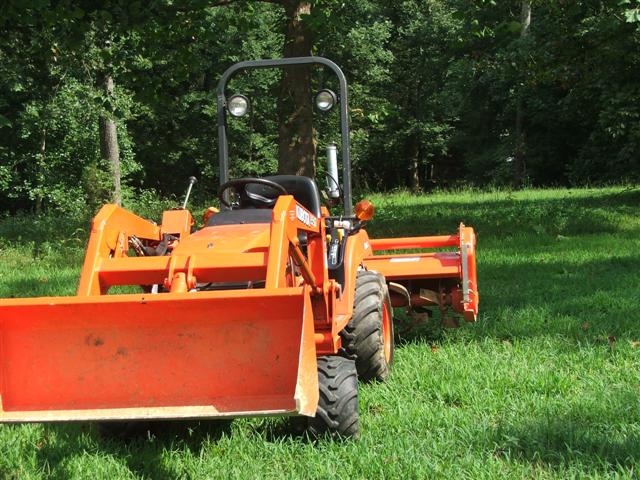

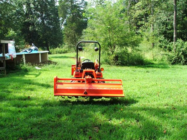

Jay, I don't think I'll try the 8' cutter, but I like the looks of the 6' tiller.:D

That book states 7 to 15 PTO HP per foot of tiller depending on the tilling depth. I do not believe this factoid at all as my 23.6 PTO HP drives my 58" tiller through some heavy and rocky NE sod/soil (I do make two passes, 3 with virgin sod.) without difficulty and I can get down 8" in my garden. Theoretically that works out to to a 3' tiller. I believe someone (was it you?) tried this set up and said it worked. I bet a foward rotation tiller that size on your tractor would give an interesting bouncy, teeth chattering, rear end pounding ride. Who knows what a reverse rotation tiller would do? I would love to hear your tilling experiences with that setup :D! Jay

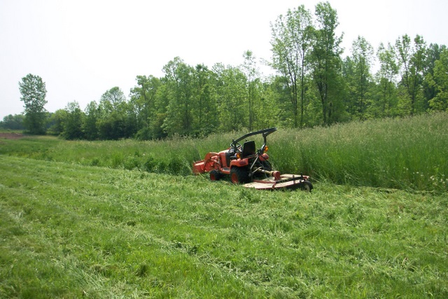

I run a 5' light duty cutter on my BX24 with no problems. usually cut weed fields at a height of 3-6 foot. Many times grass is very thick in the spring and never had a problem with power. 17.7 PTO hp, by the way.
Thanks for posting that photo, that looks just like the mower that I use, it belongs to my brother, I think it is International Machine something out of Ohio.
