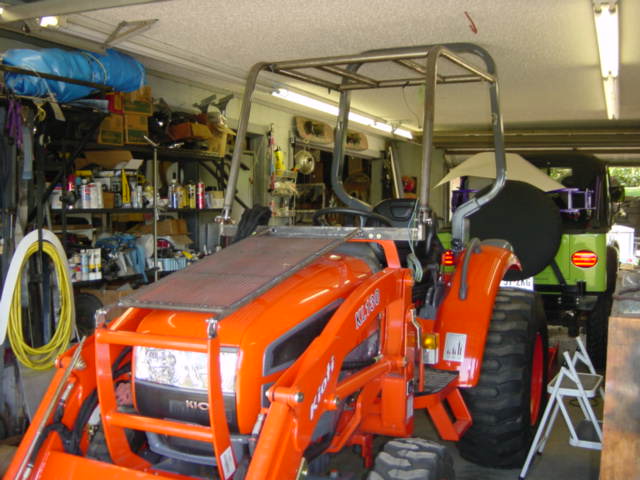

With all the brush I have been clearing I have been carefully to watch for the loose branches and limbs. Today I was showing SWMBO how to operate the new tractor and FEL when I noticed a nice stick protruding from my grill :eek: No damage to the fan or anything else, just a nice hole in the grill, actually right where I would have had to drill a hole to put a medallion on the grill anyway ;) Does anyone have a suggestion as to the best screening material to put over the grill guard to prevent this from happening again or worse damage to the engine. I was thinking of a metal mesh screen cut to size and bolted on to the grill guard.

Metal mesh would work.
I prefer expanded metal screen like I use as a safety shield on my ROPS.
It's stouter than fine-mesh metal screening. If the holes are too large you can use two pieces of expanded metal back-to-back with an offset to make the hole openings smaller.

Flusher, that is just what I had in mind! That should provide some protection to the plastic on the grill when I manage to get into the brush when clearing. Two pieces connected on the front and back of the grill guard should do it.

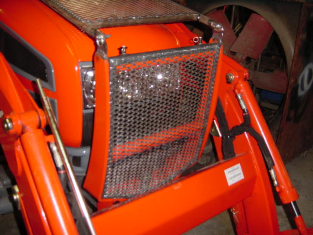

Here's what I did.
/ First Damage to New Tractor
#17
That looks great Red, I wll try and make somethng like that, how did you attach it to the grill guard?
