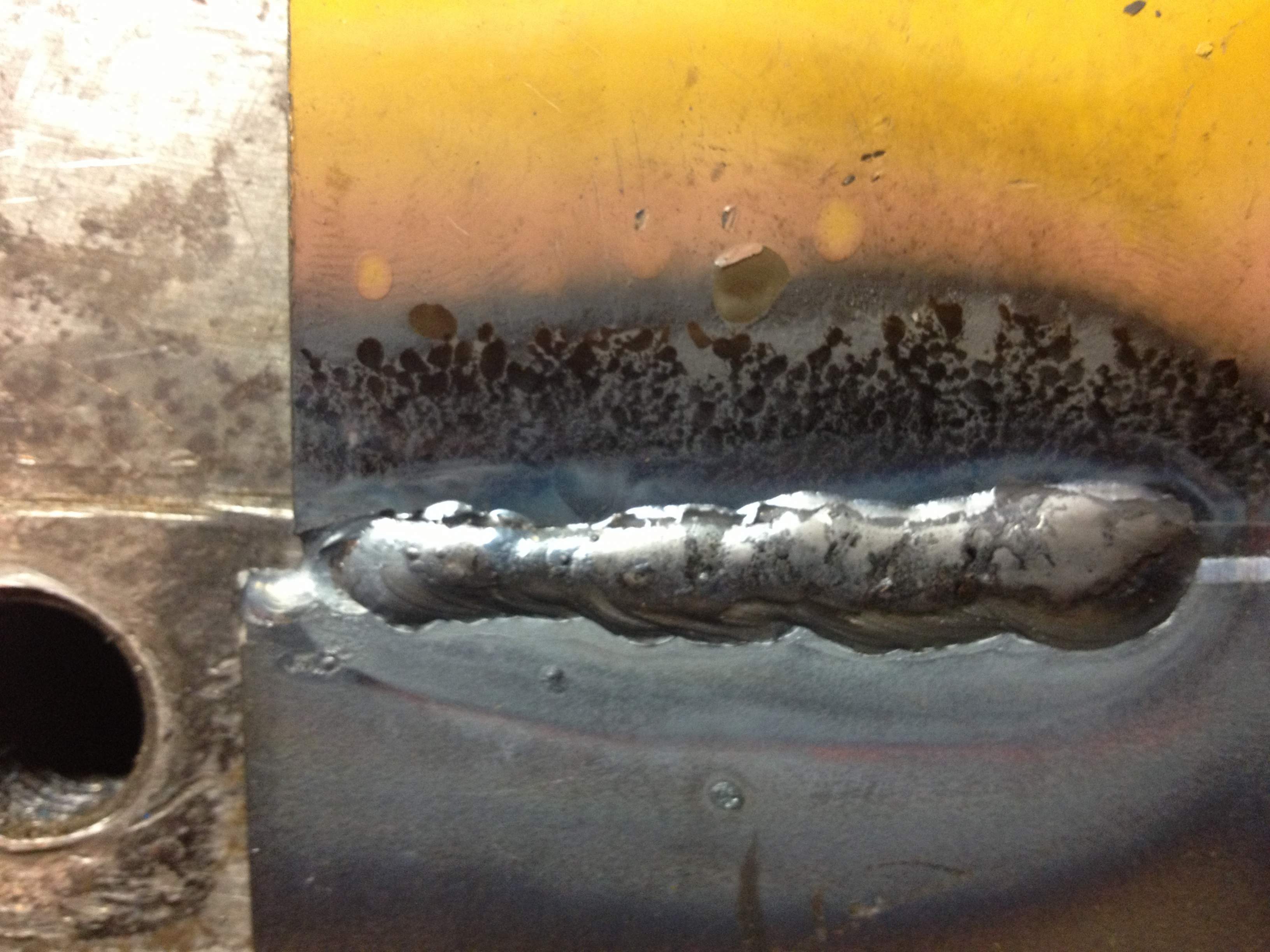

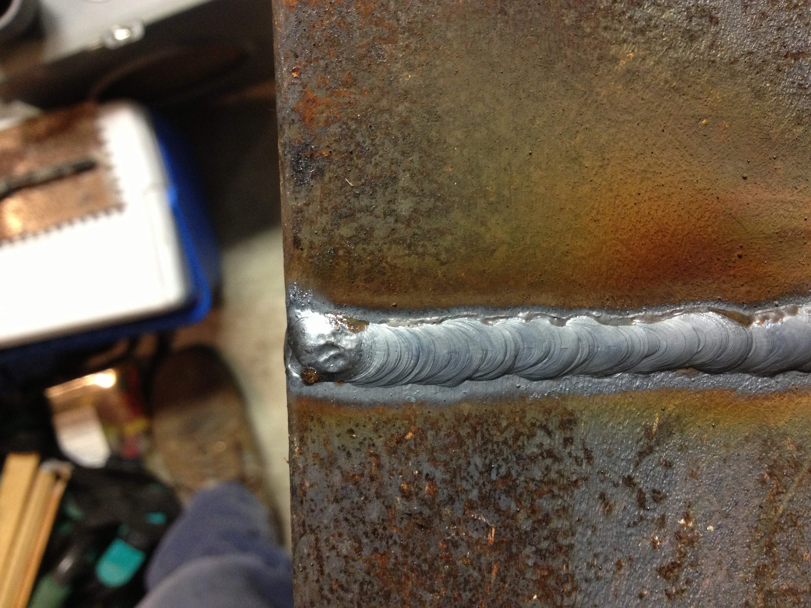

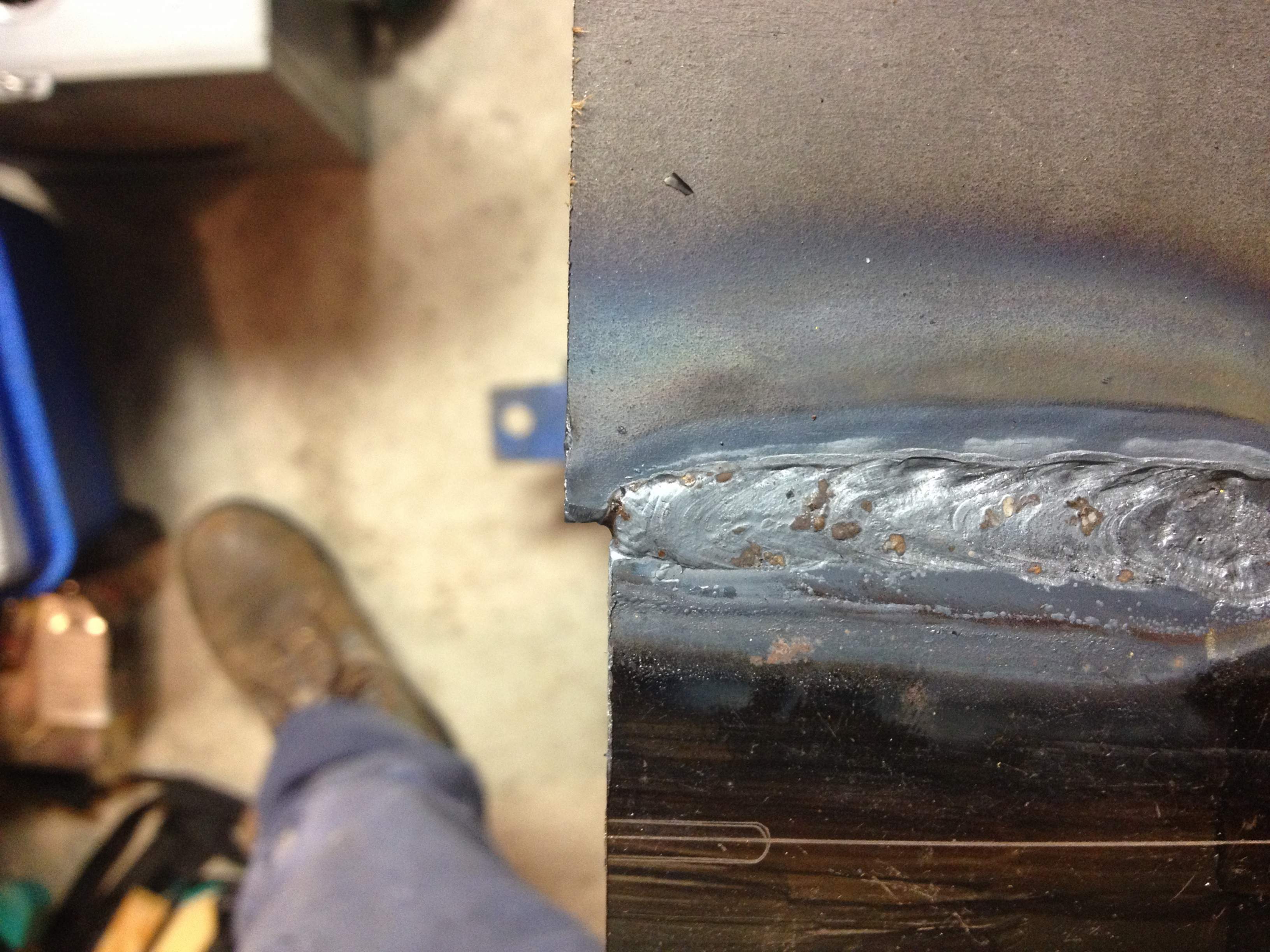

I put together a scratch start tig for my Miller thunderbolt ac/dc stick welder today. These are my first and second beads with a tig torch. I'm using 100% argon set at 15. It seems to run ok once it gets hot but the tungsten gets worn out really quick. Any tips for that? Here's a couple pictures. Any tips or recommendations would be appreciated. The second & third picture are the front and back of the same weld, I never welded the back side. I think there was to much heat to make it blow through like that.

Might be hot.. What size tungsten, what kind of tungsten, (what color of band) and what amperage? I use lanthanated, and they last well, as long as I don't dip it in the puddle,, (which I still do more than I care to admit):)
Oh, also did you have the metal perfectly clean? no rust or scale in the welding zone?

Oh, you have to clean the metal better before welding!

I'll give it another try tomorrow on some new pieces that are all cleaned up and repost.

TIG doesn't fill as much as other welding processes. It looks like you're trying to fill too much at a time. TIG is usually used for small really neat welds on thin material. Using it on thick material is a waste of argon. If you're burning the tungsten up are you on straight polarity?

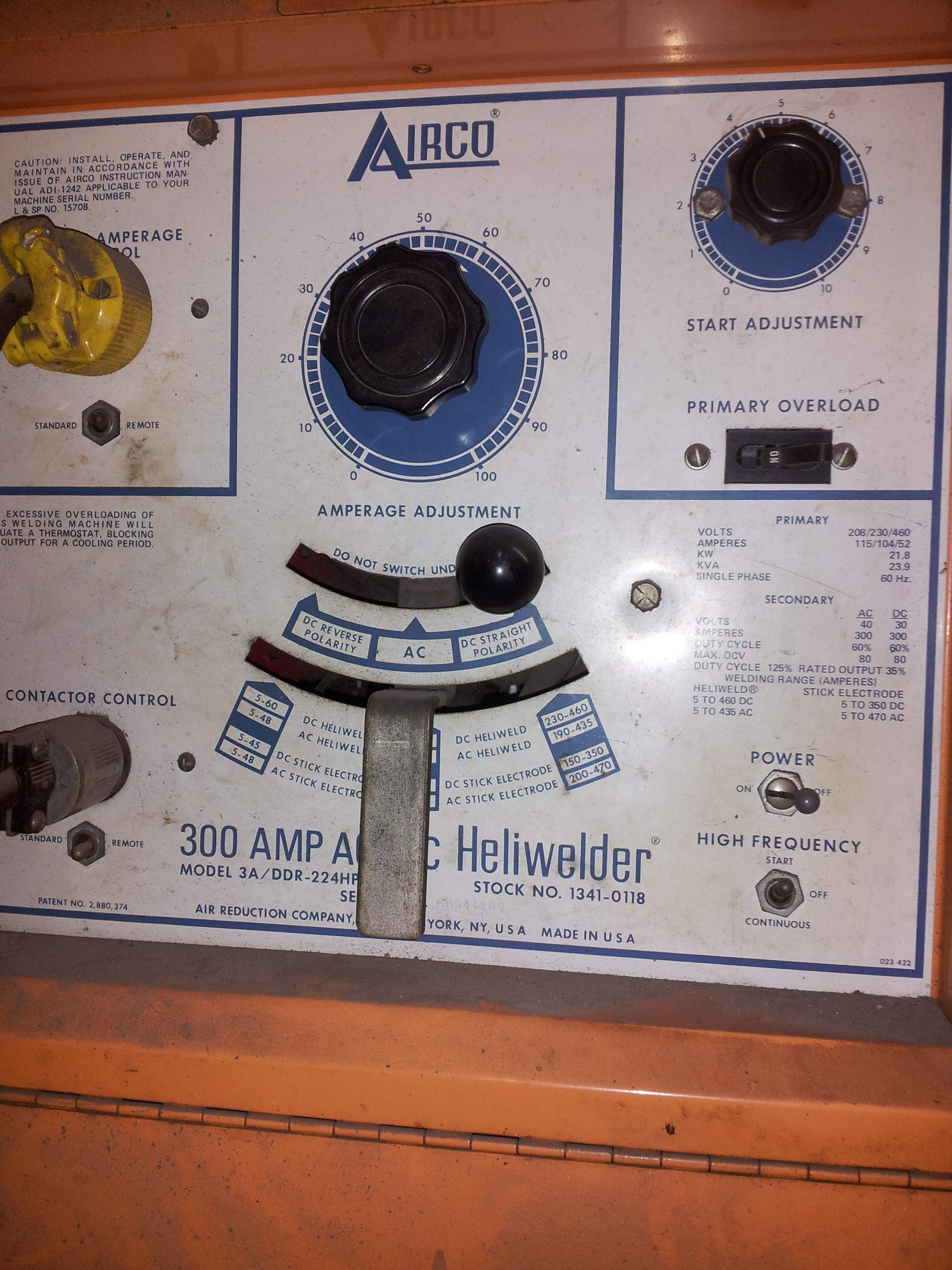

Here's a picture so you can see the machine.
Well there it is is blue and white. right on the face of the machine. But don't you agree that saying Electrode positive or electrode negative makes so much more sense? I guess it is an old' timey machine thing, because all the machine's I have ever seen are marked + and -

Electrode Positive is Reverse Polarity. Electrode Negative is Straight Polarity. :)
