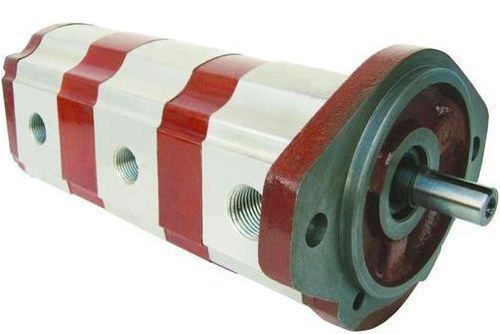

You havent explained your plans very well, but I will throw in my .02cents anyways. My first suggestion is forget the priority flow controls and divider valves. get yourself a double or even a tripple pump and mount it on a gear box to run off your pto. I will guess you plan on having a conveyor to feed the logs, as well as maybe a conveyor to move the split wood. You can run both off a smaller pump. Depending on what motor you plan on using for your saw, it will need a good amount of flow and pressure to have any real cutting power. This can be ran off the second pump, and the third pump can run the splitter portion. Use a unloader valve to connect the oil supply thru a powerbeyond on the saw CV to feed oil to the splitter cyl to speed up cycle times. This will not effect saw function, but will speed up the splitting cyl. You can set the unloading pressure to where if you need highpressure for splitting, the saw fluid will dump to tank and only the splitting pump is supplying oil to the splitting cyl to reduce hp requirements of your tractor. The control valve for the saw can be connected to a sequence valve so that when the saw is activated, the log clamp will close and the saw lift cyl will extend, lowering the saw into the wood and the saw will start running. One lever working all three functions.

The pump is not an easy question. My plan is to use 2 pto pumps on the same shaft. because I can't find a tandem pump that is big enough.
Or is very expensive.
Surplus center don't have many pump with tandem option. they only have two pump option with a too small second pump.
Do you have a website that sell triple or double pump like you discribe?
I think that you can mount this kind of pump if you have a long shaft.

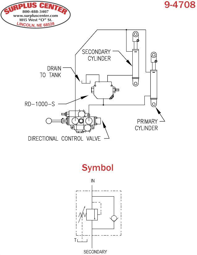

Like How can I have 3 actuator with one sequence valve?
Or maybe the valve of the motor saw have a "button" that, when the saw is lowering the motor start? like in this video at 1min 05sec:
Processeur a bois RR 2�T - YouTube
  • DR9-4708.pdf

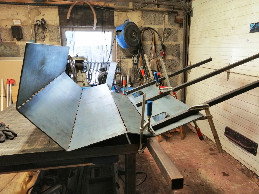

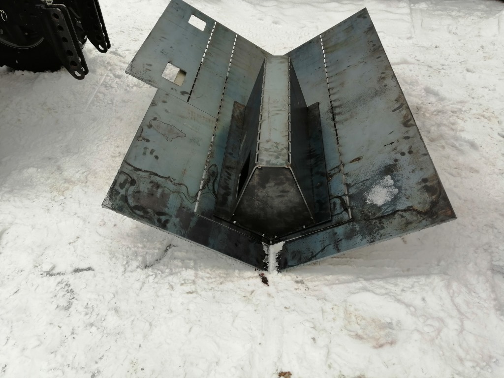

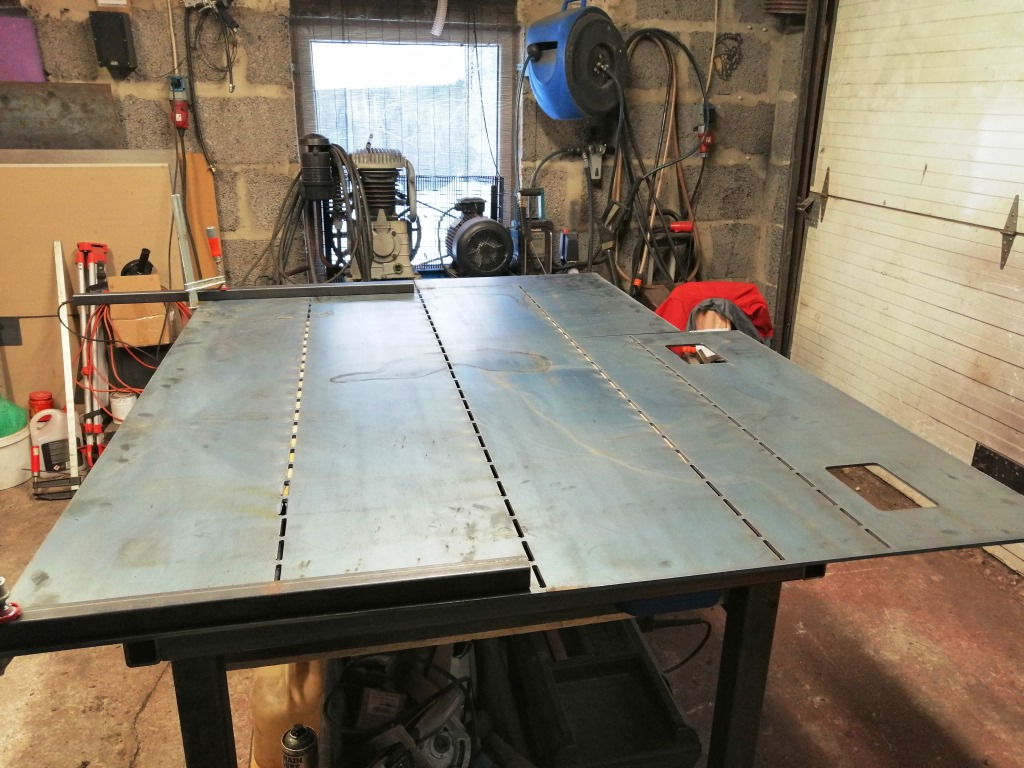

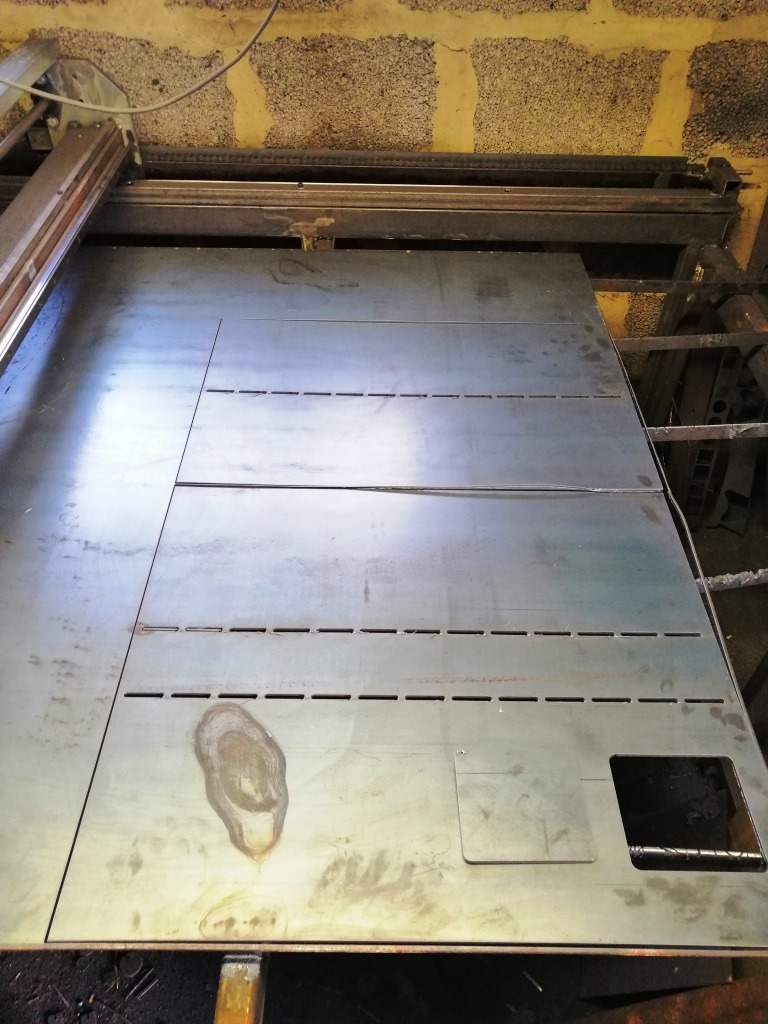

Hello
Greetings to all self-builders.
I also put some pictures of building my own firewood processor.
I hope that will work :).IMG_20190126_102351.jpgIMG_20190127_130332.jpgIMG_20190126_113409.jpgIMG_20190126_111501.jpgIMG_20190126_102411.jpg

Also is someone know what kind of hydraulic symbol is this? :
