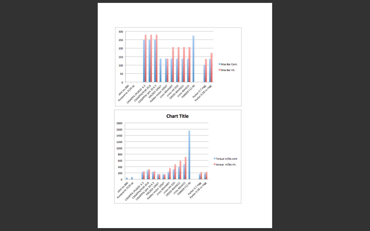

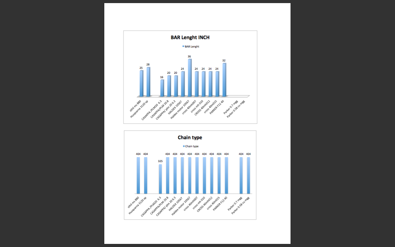

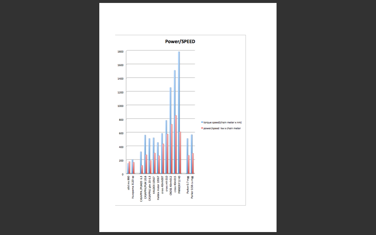

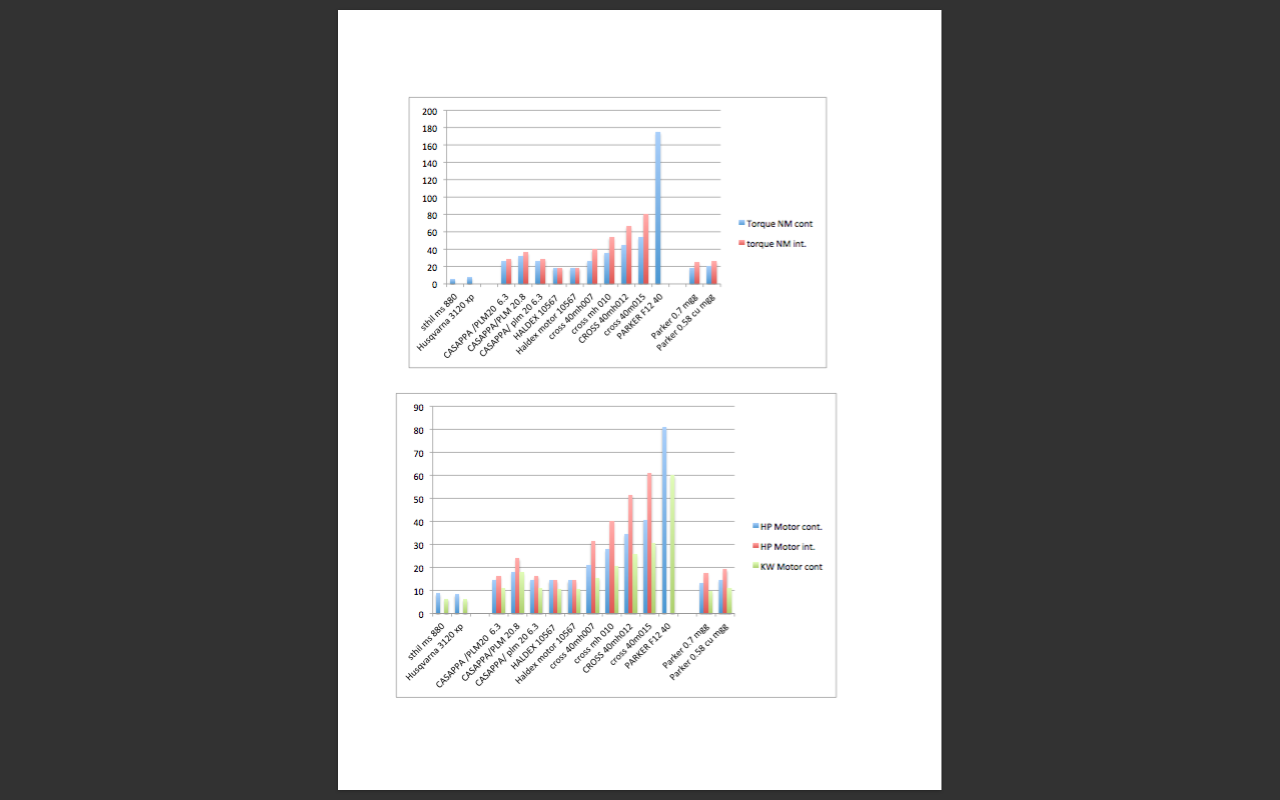

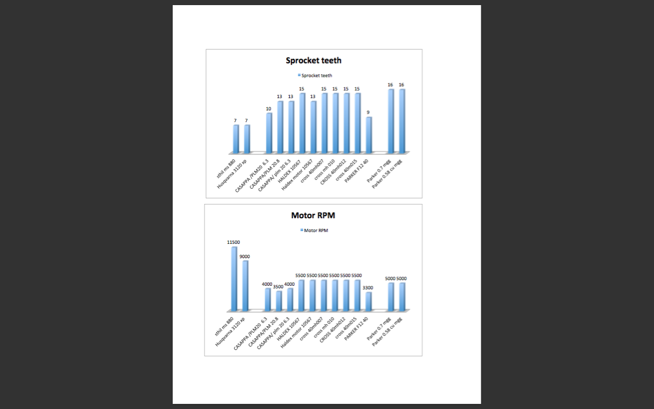

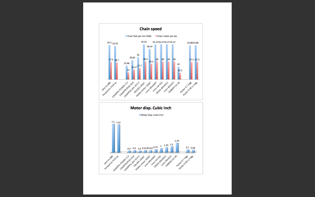

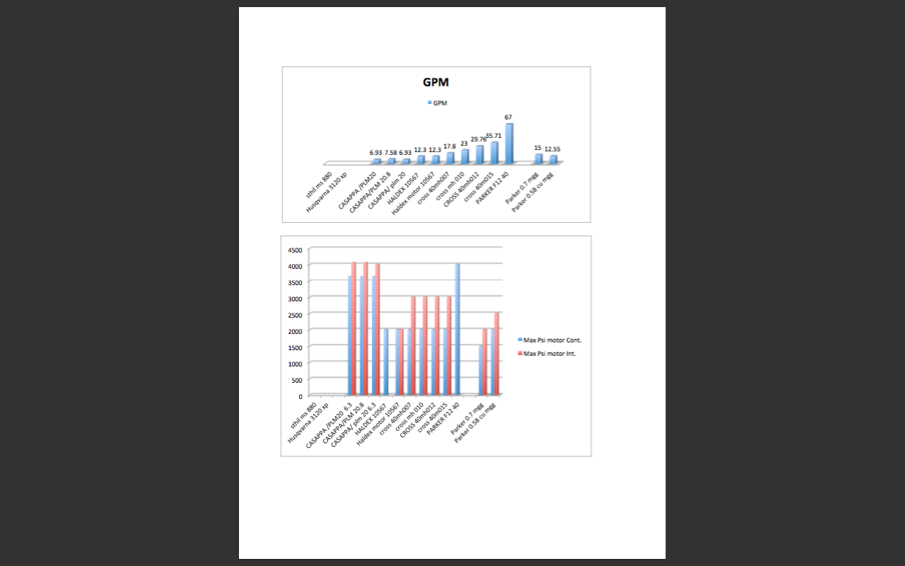

I study some specs on several large chainsaw too. In the following graphic I put 2 gas chainsaw, 3120hp husqvarna and ms 880 Shtil.
The other chainsaw are popular hydraulic motor found on many processor and 1 motor specs from a harvester. I calculated with the max RPM
and PSI from the manufacturer specs. After working on that I realize that the best motor would be a smaller cu-in but faster rpm and higher PSI
So I "study" two motor for my project. PARKER 0.58 cu and PARKER 0.7 cu. You can see them at the far right of the charts.
I also calculated what I called the Power/SPEED which is the Nm x chain meter per second. Because like you said all is related.

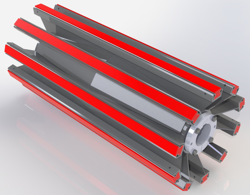

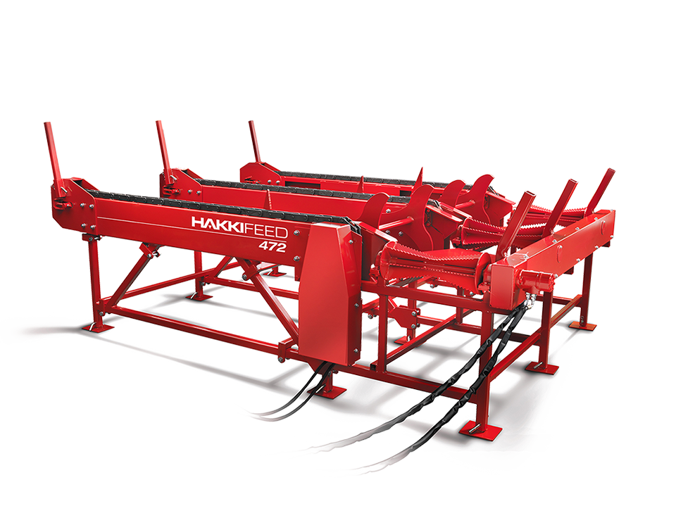

Also maybe some of you can help me. Do you know where I can buy a conveyor belt drive pulley? something like this:
Or an alternative to drive a belt?

Lot of good information in one place, but you failed to compare torque in relation to sprocket size. The torque numbers of the chainsaw as well as the hyd motor are rated at the shaft. The 3120 and 088 gas powered chainsaws are running 7pin sprockets and your .07cuin parker motor is running a 16pin sprocket. You will need over twice the torque with the .7 motor as the gas saws to equal the cutting power. The .7 motor I think I already said is the minimum size motor I would consider. Trying to go over the recommended psi could end pretty badly. There are also other type motors you havent considered. The f12-40 is a bent axis and takes 5000psi and over 60gpm to produce the speeds and torque advertised. Take a lot of engine hp to get that kind of flow and pressure. In the middle are the axial piston motors. Generally high speeds and decent torque. There isnt any substitution for cuin's

I did not compare torque/sprocket size but compare torque/chain per second,
which is related to the rpm and teeth number. is not the same thing?
If you watch the fourth page you can see that the parker
motor have at least twice the torque compare to the 3120xp and 880 ms.
What I note is the longer the bar the higher the Torque and lower the RPM.
Example: With the same motor/rpm/torque they use
15 sprocket teeth for 24"bar and 13 teeth for 36"bar.
/ Firewood processor project. #68
I am not exactly sure what or how you are compareing torque to chainspeed. From experience I know going to a longer bar will effect cutting speed. As will changing out chain pitch. It simply takes more power to pull the extra chain lenght. With a gas powered saw you will see a drop in rpms as cutting load increases, because the saw is already maxing out its available power. With hyd, as the power requirement increases so does the pressure, as long as you have the pump and engine combo to build the required pressure. For this reason the hyd saw will maintain chain speed better than the gas powered saw. Now if you are cuting 12in dia wood, you probably wont be able to tell any difference in cut speed between using a 24in or 36in bar because you wont be maxing out available power.
