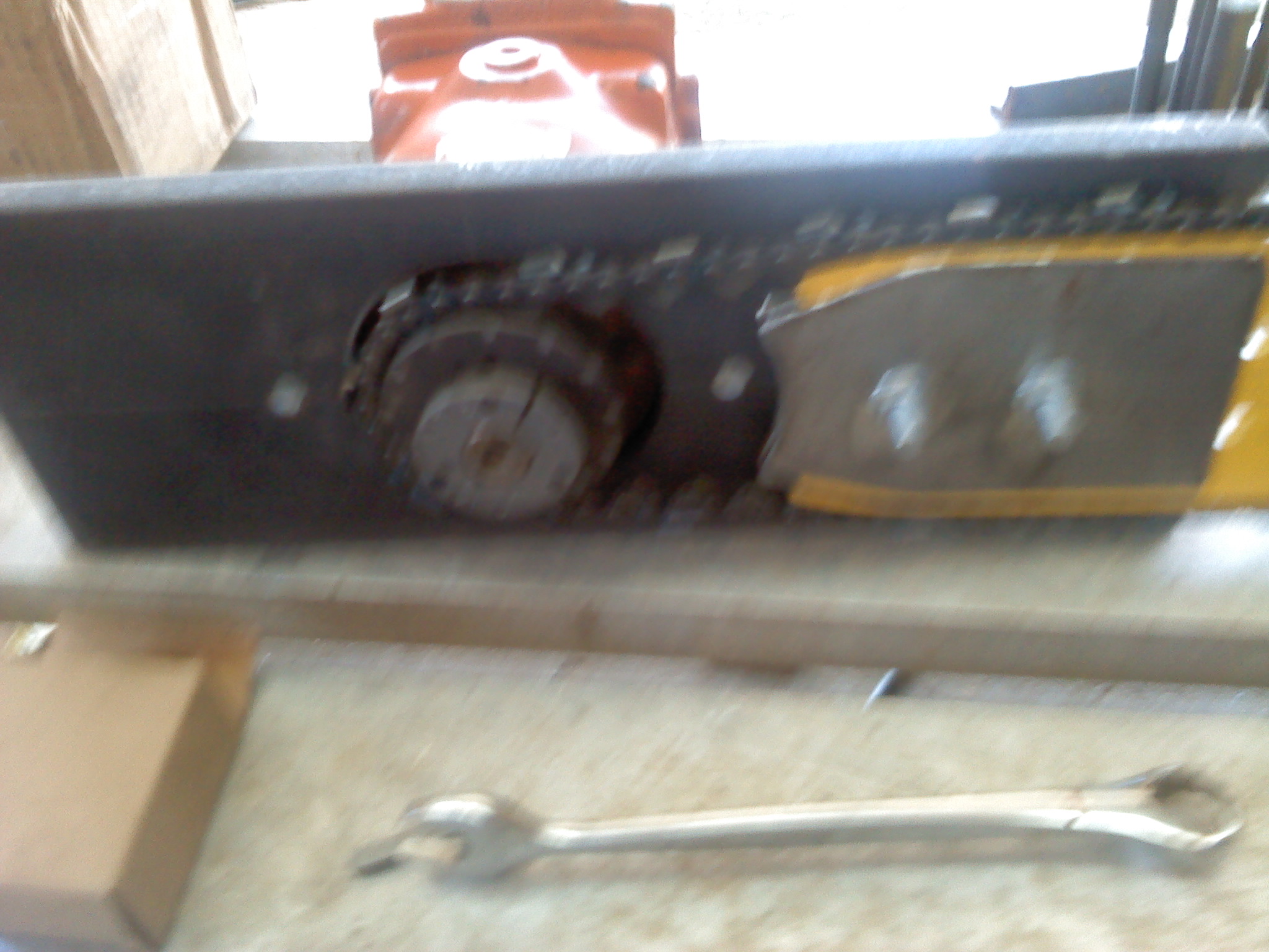

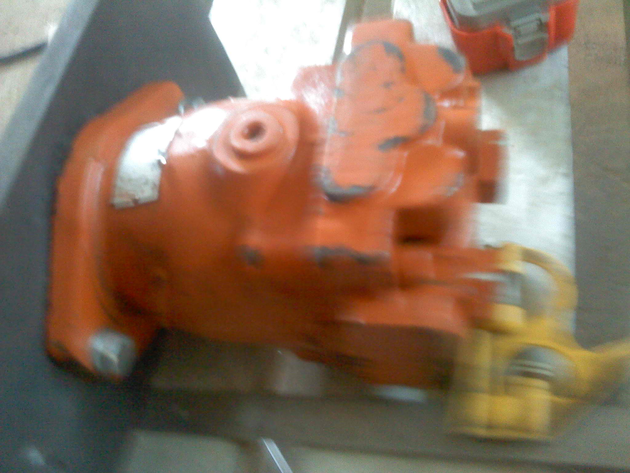

0310131322 (1).jpg My hydraulic saw. Using a 1.3 cuin axial piston motor/ with case drain and bearings on shaft, and 13 tooth sprocket and .404 chain.0315131401.jpg 30gpm@ 5331 rpm (motor rated for 4600rpm) chain speed of 4660ftmin at 17.25ftlbs torque and 17.5hp@1000psi

I think you can control the "amount of bite" in processor saws..if your saw cylinder work with very low pressure (think harvesters work somewhere between 40 and 80 PSI depending on systems specs and chain), it will be the saw that "decides" the bite that is going to be taken of the wood..adjusting flow for saw cylinder will change saw down and up velocity..you even could have high down into the wood velocity, but if the pressure is rated for that low PSI, is the torque or HP output that is going to "decide" the velocity of the cut when chain get into the wood..obviously, the saw is going to slow down in the midlle of the log, and speed up at the end, depending if it have "more or less wood" at time to cut..
as mudstopper say, if you haven't start building that saw, i think you should listen is calculations, you should be able to have a decent cut without lots and lots of source HP..
What is your limits in this source HP?

View attachment 433487 My hydraulic saw. Using a 1.3 cuin axial piston motor/ with case drain and bearings on shaft, and 13 tooth sprocket and .404 chain.View attachment 433491 30gpm@ 5331 rpm (motor rated for 4600rpm) chain speed of 4660ftmin at 17.25ftlbs torque and 17.5hp@1000psi
Don´t you have some video of that configuration working? (in what type of wood, and at what chain deep gauges settings?)
