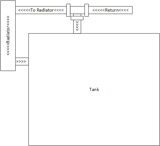

Wow, you're full of really good ideas, thanks. I have the word out to a friend who farms in my area. I figure he knows all the farmers for miles and may be able to help me find something good to use. I know somebody's got an old belt or chain, if not an entire elevator, sitting around that would work for me. I'll update the thread when I finally find a solution.
I love your idea of a rad plumbed to its own port. I would still have a problem running a pump, but its a great idea that I'm going to give more thought to.
   / Firewood processor build thread #404
What if you teed into the return as shown below and had it exhaust into its own port on the tank? As long as your radiator is larger than the return (ie: 1.25" vs 3/4") any excess flow/pressure over what the radiator can easily take will go straight into the tank. No circ pump needed that way.
Aaron Z
Another good idea. How much of a benefit do you think using a rad with no fan would give? I'd still have the issue of not being able to power the fan.

I am going to go against the car radiator as a oil cooler suggestion. Automotve radiators are not rated for anywhere near the possible pressures that a real hydraulic oil cooler is. Even a cheap cooler has a 250psi pressure rating. A oil cooler is subject to pressure spikes as the returning oil passes thru them. I really dont think a car radiator is going to hold up for this application. Consider a radiator cap is generally around 14psi to prevent the radiator from blowing up, It would be very easy to exceed 14psi with a fast moving hydraulic fluid moving thru a radiator. You can buy a real oil cooler for less than $200. You will probably spend a pretty penny trying to fit hoses to a automotive radiator
