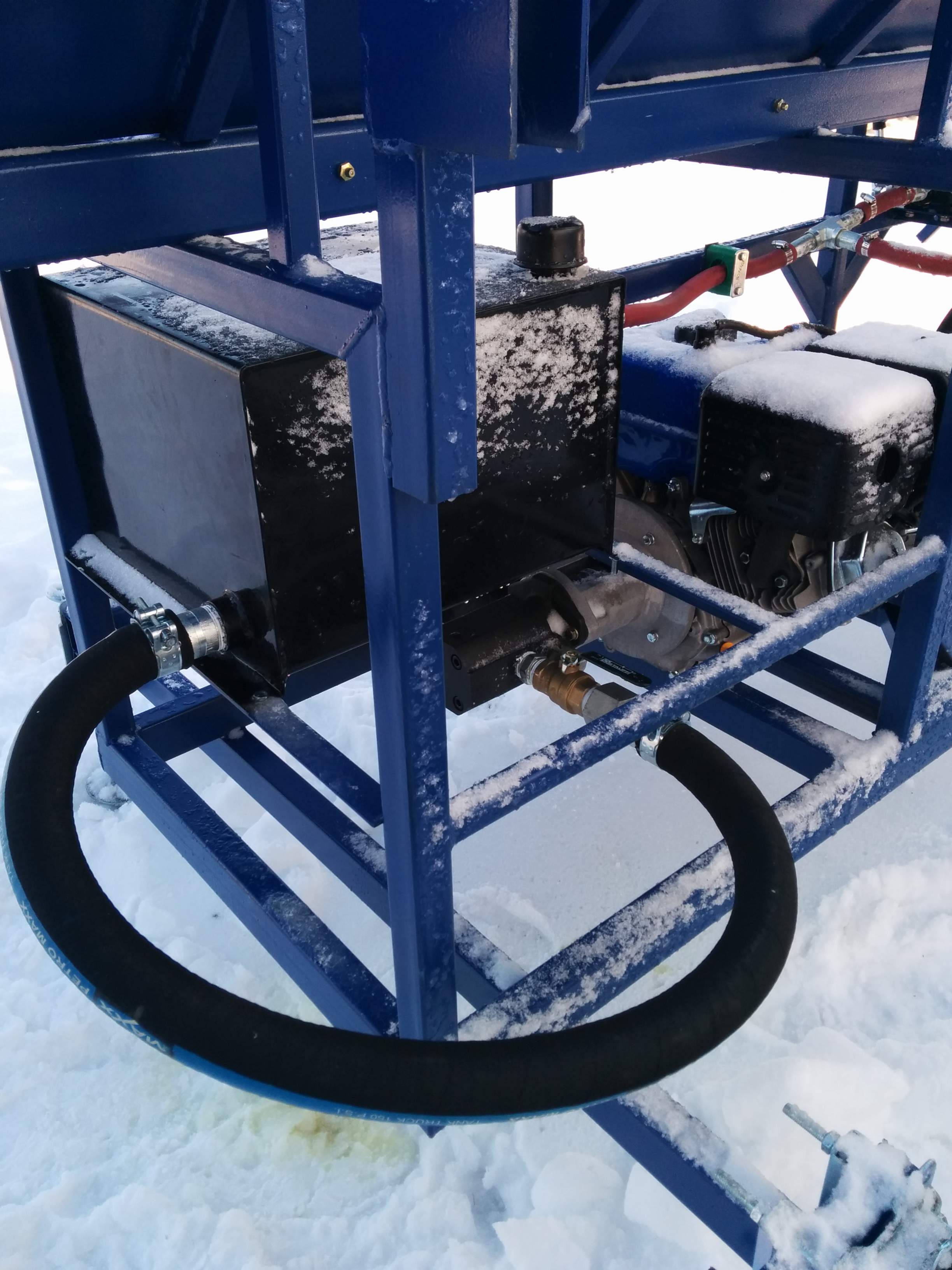

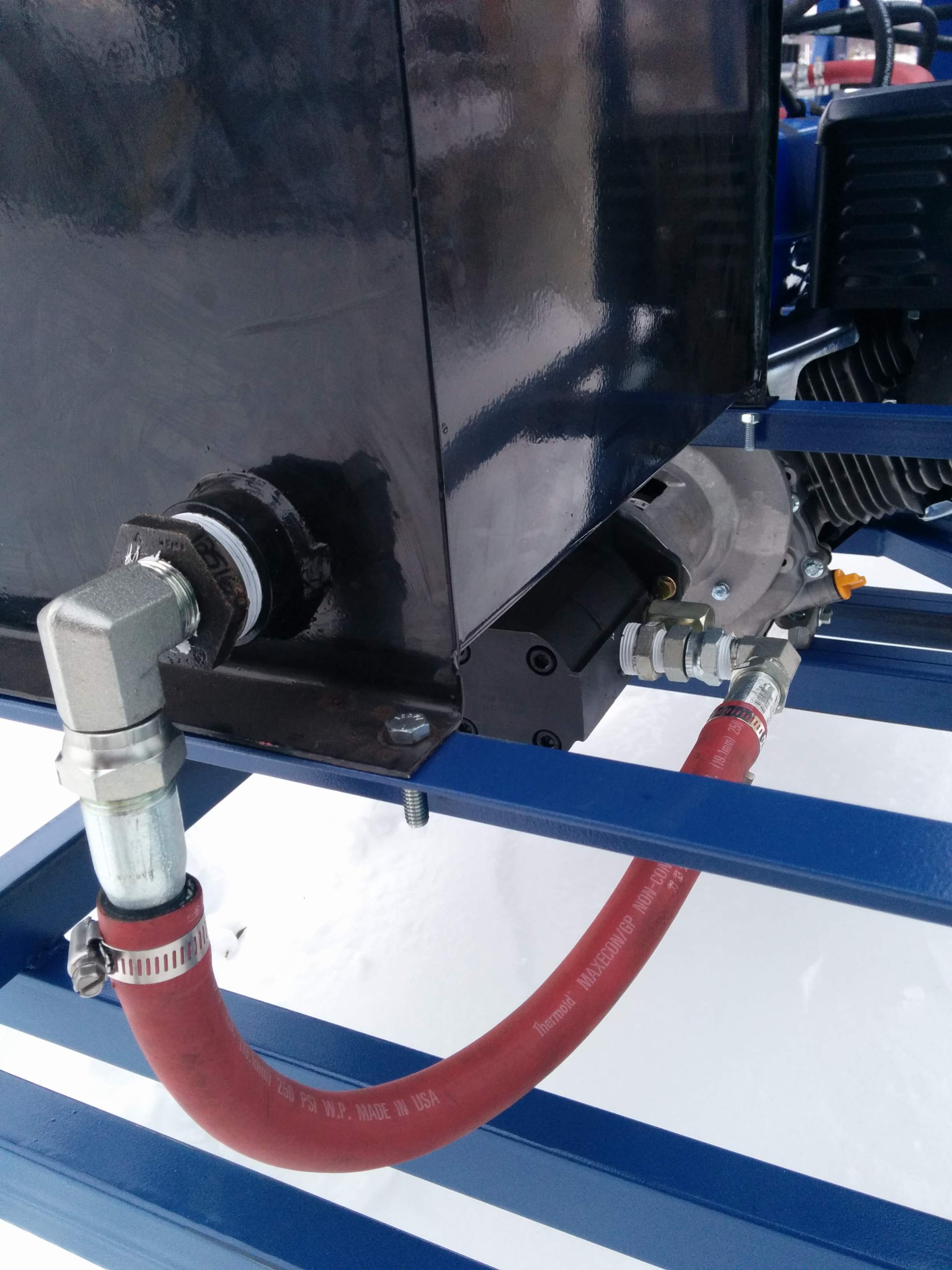

PA reduced the hose to 3/4", not really suction hose. It's now 1 1/2" Parker suction hose. Hydraulic shop says they would have used 1" return, but it should work.
I vote for the new larger hydraulic tank.
I would also change the return to 1'' as the Hydraulic Shop said. The smaller return line could add to the friction -- (more heat for the hydraulic oil and slower cycle time).
I agree with changing the lines to 1", and it may eventually happen, but for now, I'm going to go with more oil and see what happens. I just don't want to buy all new fittings throwing yet more money out the window for the old fittings. If more oil doesn't fix it and I'm forced to add a rad/fan, the lines will be changed as well.

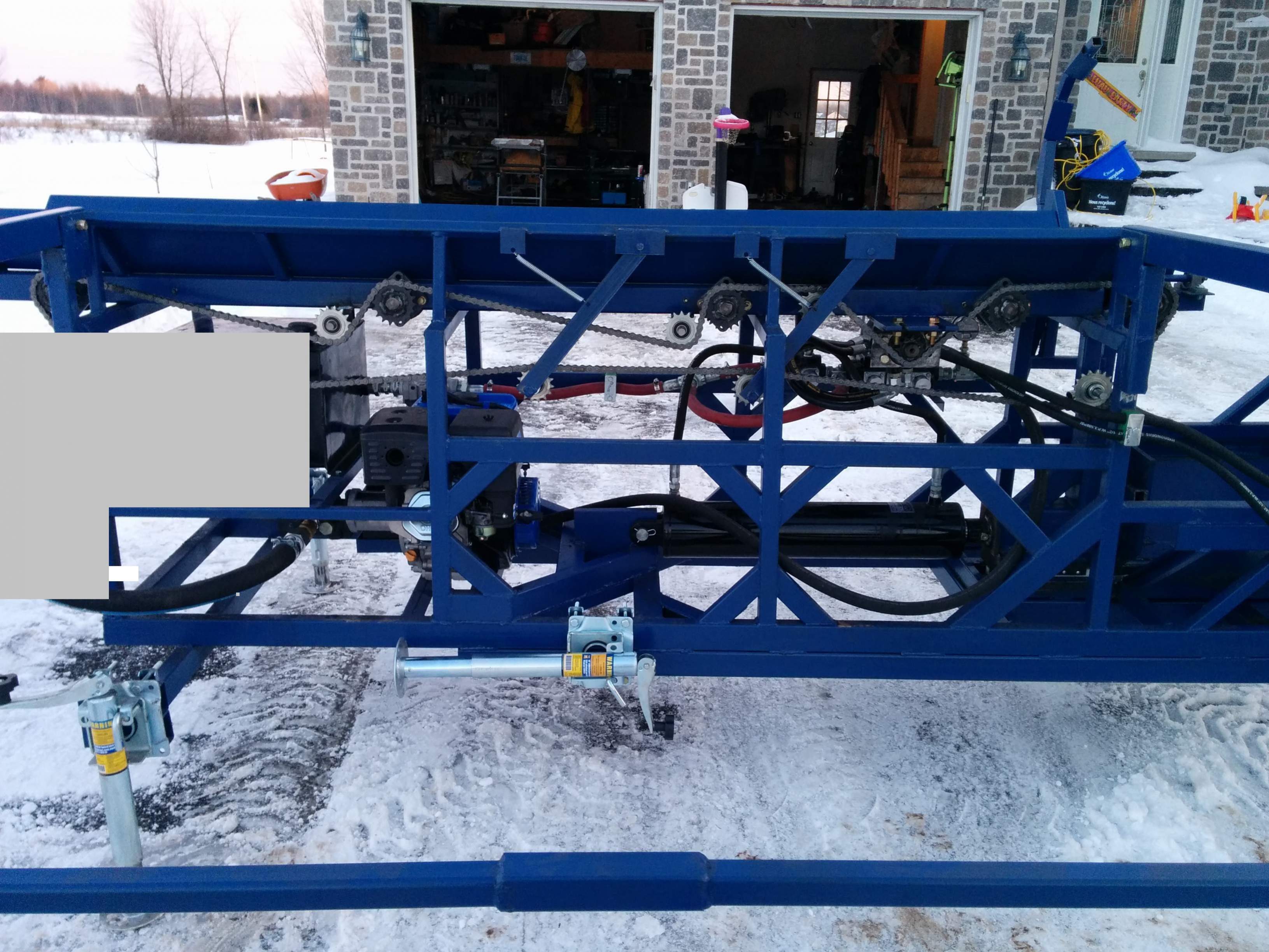

Well, you can see from the picture, I don't have enough room to built a large tank in the current space without running into the pump. My new tank will hang on the side of the frame so I'll either just remove the existing tank and have a space there, or keep it in place.
Yes, I'm talking about a suction strainer. I would have a union to disconnect the tanks. This will also make it easier to install them in the first place, I won't have to spin on my new tank, getting it just right to be able to bolt in into place.
