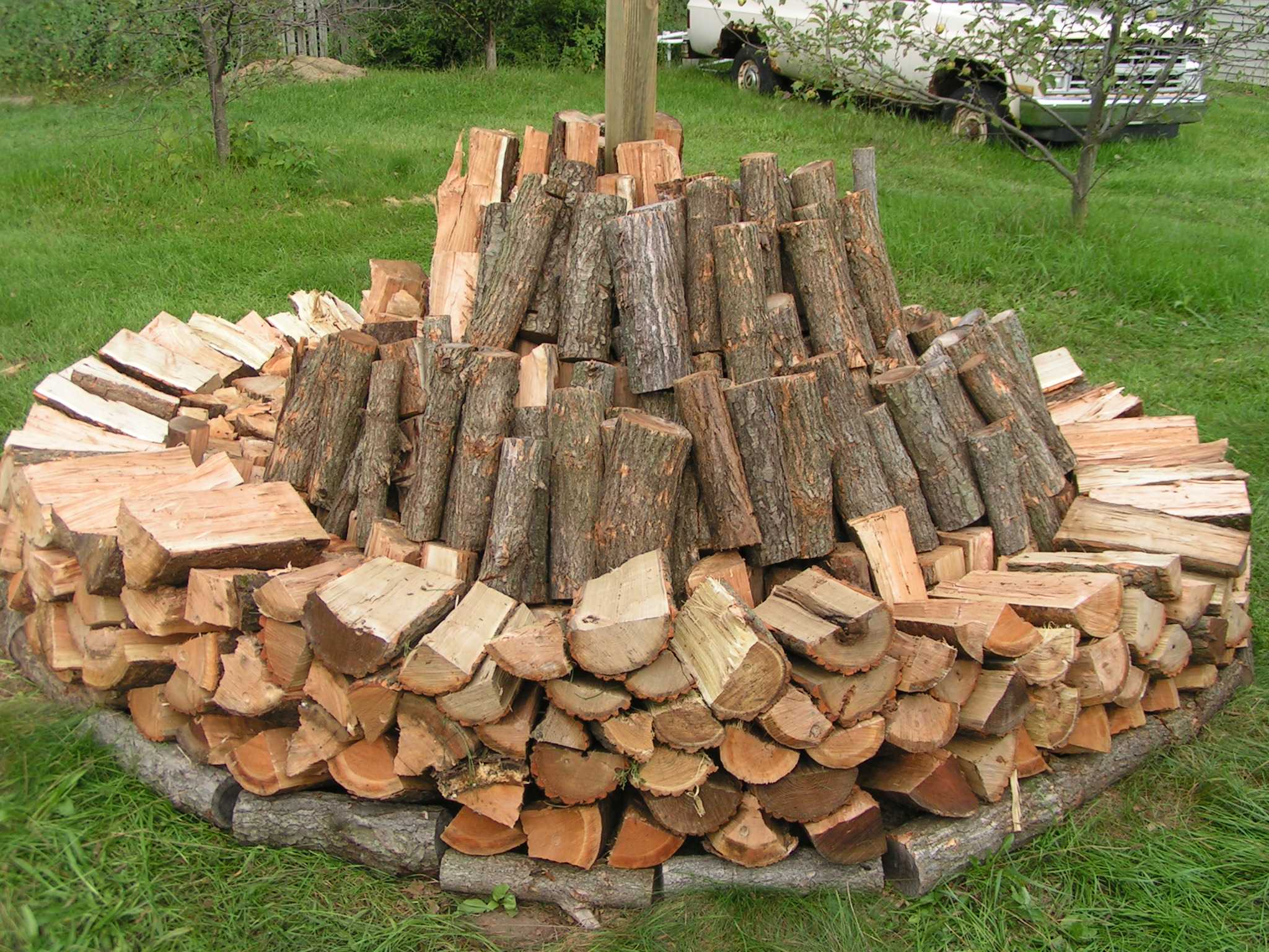

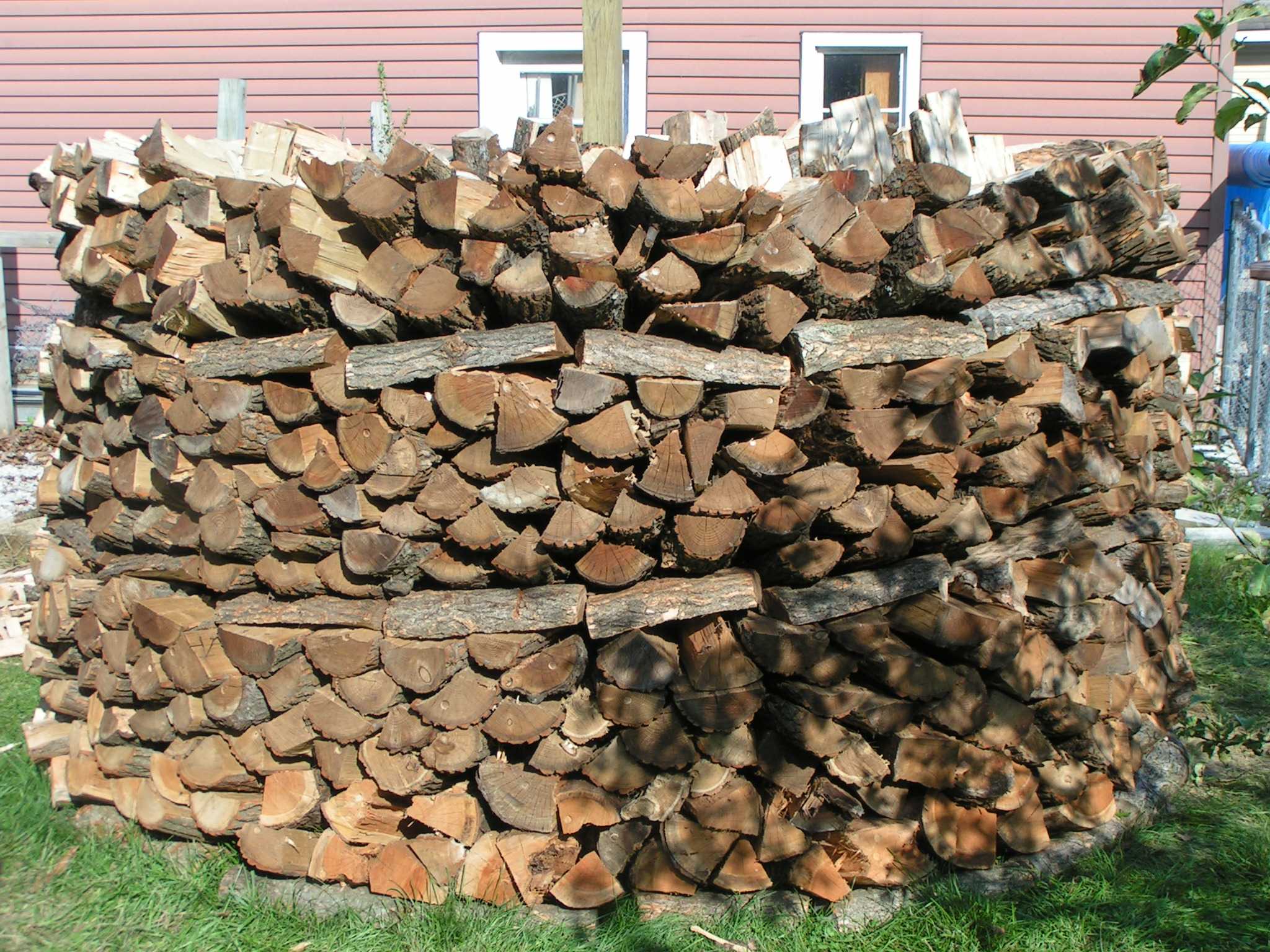

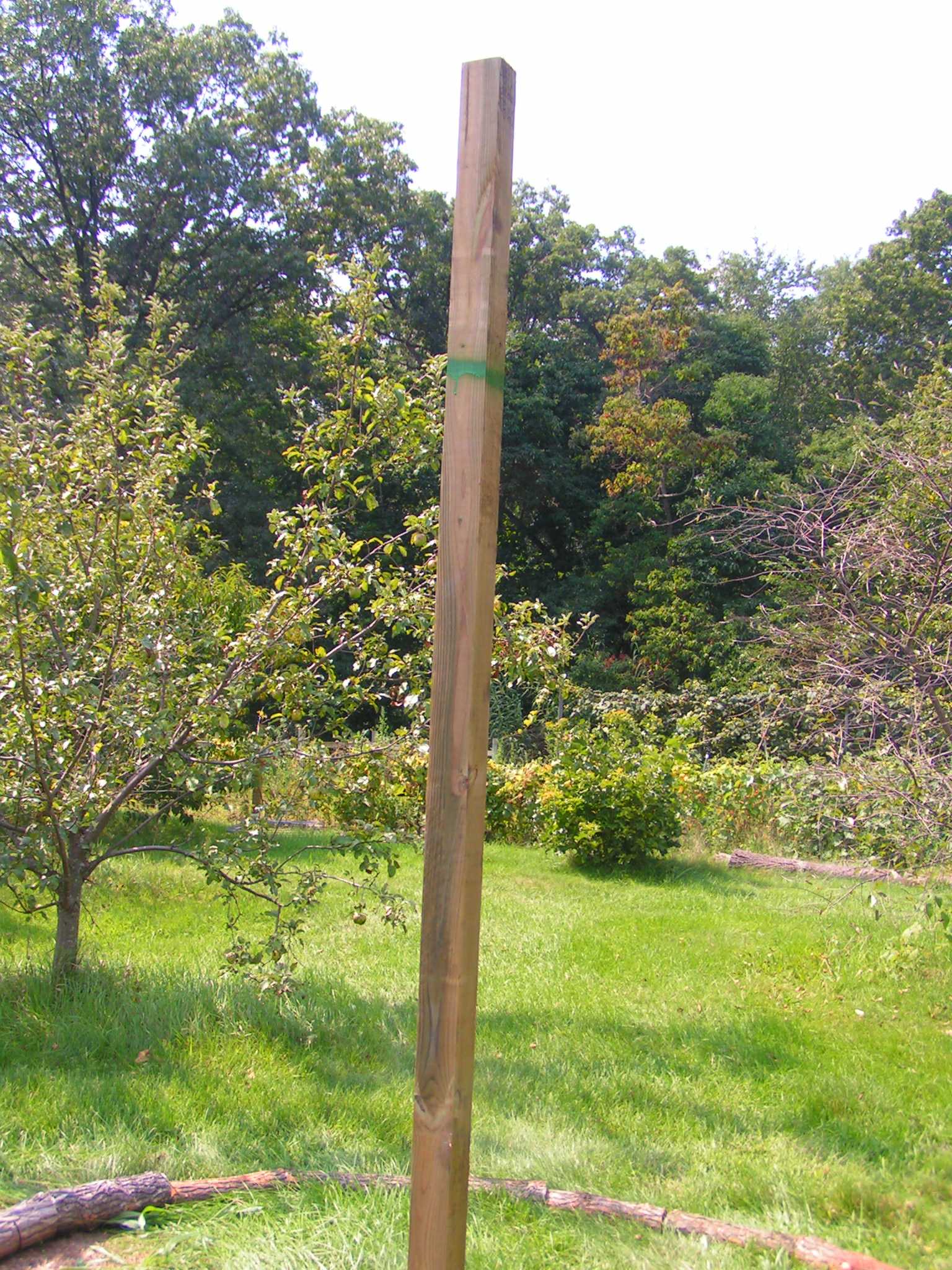

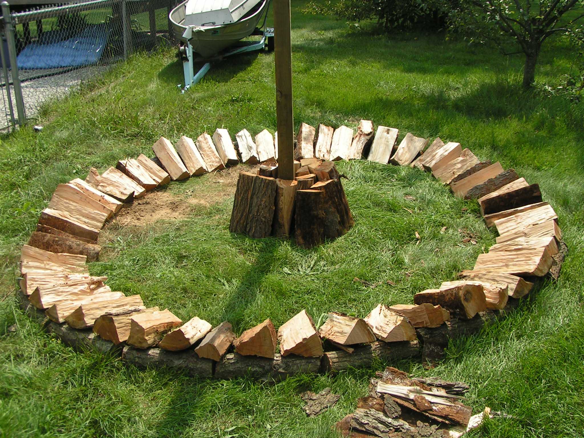

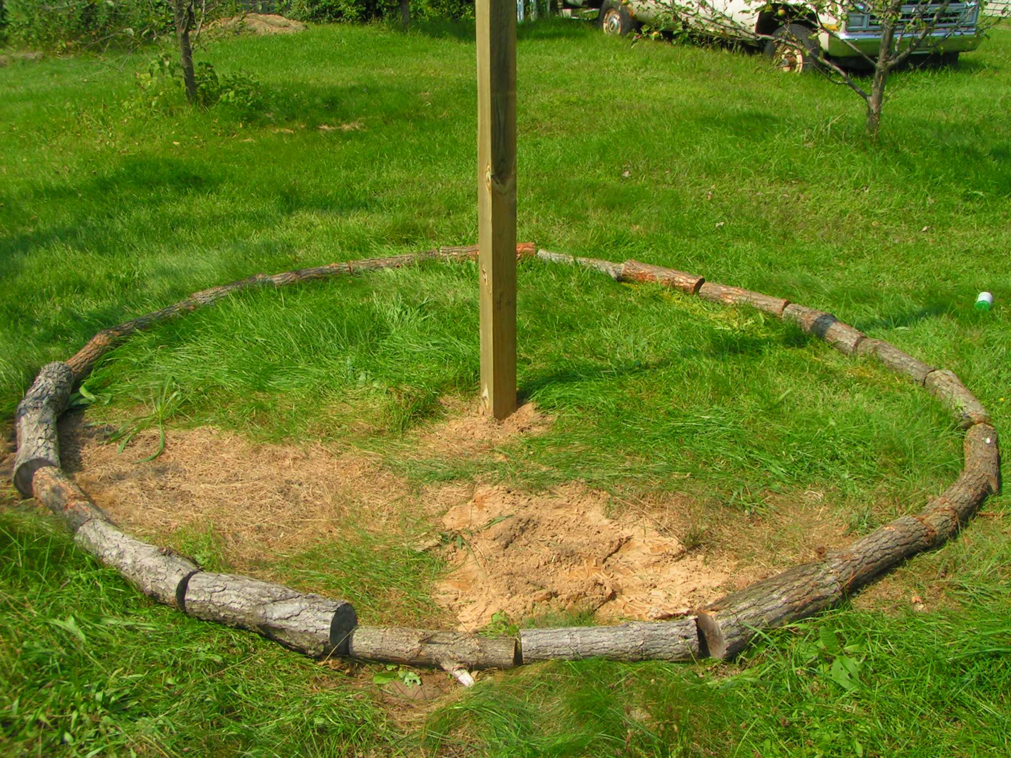

My Holz Hausen! :)
First pic is the ring 10' in diameter.
Second pic is paint mark at 8'.
Third pic is first course of split wood at an angle inward.
Fourth pic is several courses of split wood angled inward and internal area of circle with wood both split and small unsplit pieces stacked vertically.
After it was about 3' high I put another course of shims around the outside ring to keep the wood angled in and continued. I am up to about 5' high now. I split a 10' diameter by 5' high in about 10 hours. That's about 3 cords, according to the Holz Hausen instructions. :)

I was going to build a Holz Hausen this Spring but decided not to after seeing peoples' comments on the web. Basically, they said more work and most said it did not dry any better. I also thought 10' high? I would need to use a ladder. On the plus side, you get a lot of wood in a small area.
Ken
   / Firewood Gathering With A Power Trac
#28
I don't see how it can be any more work. In fact, I think it is easier as you don't have any ends to brace up and don't have to worry about it falling over. And it does seem to take up a lot less room. 6 cords stacked conventionally would be 4'x4'x48' and take up 192 square feet of ground. This method takes less than 80 square feet. You don't have to haul the wood as far, either.
However, you are correct about the height. I am currently at 5 feet. I can toss it to 8'. But after that will require a ladder.
Perhaps I should have taken the author's advice and made a few 7 footers. :)

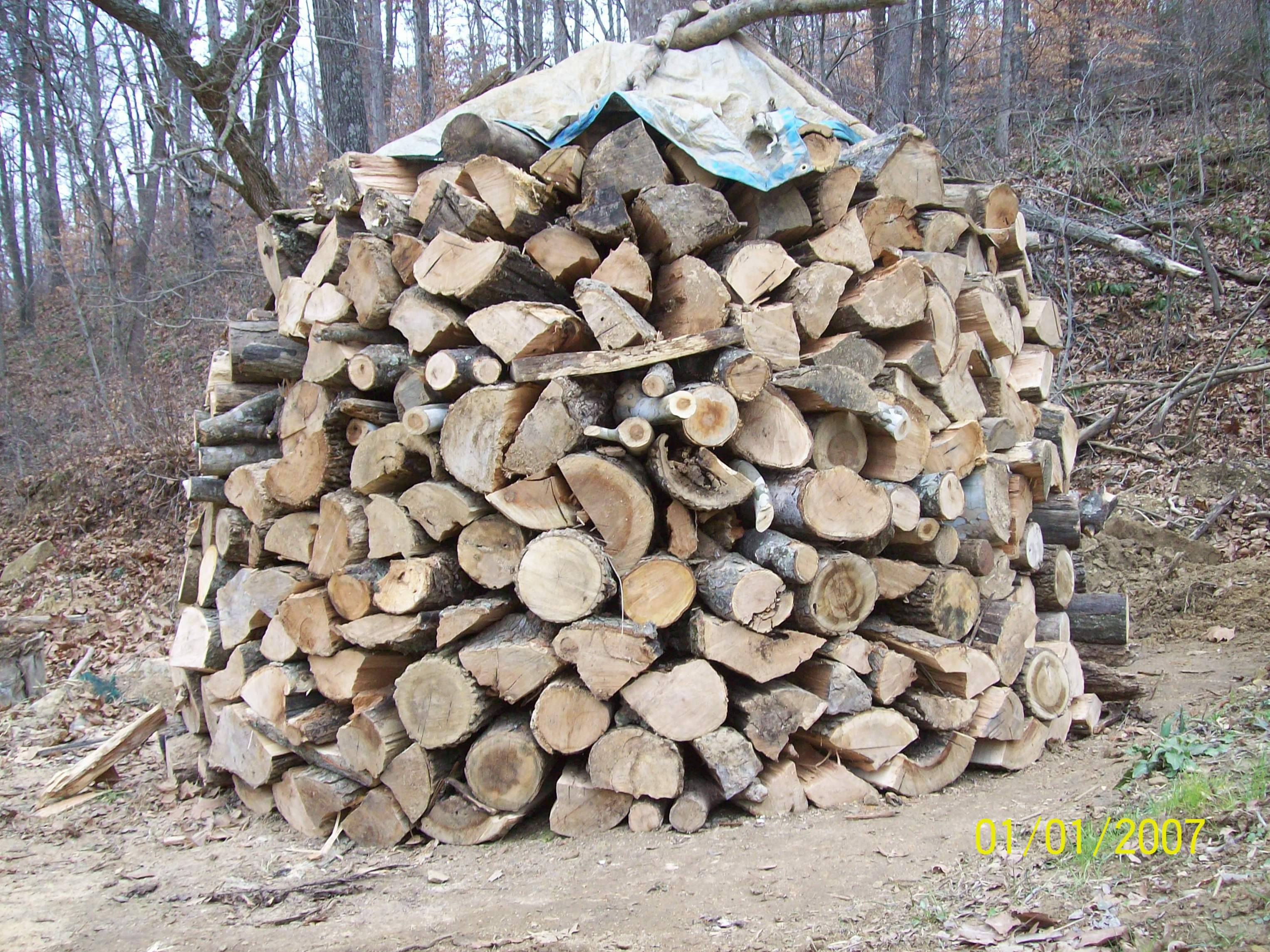

I'm trying to keep mine fairly level and tapering slightly in. I'm also putting the shims in every few layers to keep the outside ring of wood tapered inwards. It's 6' high right now. :)
It is kind of weird how as you build up the outside ring how fast it becomes level again. You'd think it would stay tapered inwards from the first row of shims, but it does not.
