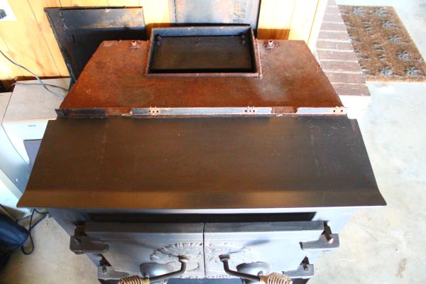

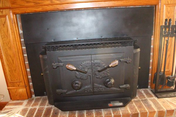

We bought a Oak Ridge fireplace insert that is from the 1980s that we are going to install it in our masonary fireplace.
The outlet of the insert is 12" x 8.125" which is about 96 square inches. Our chimney is lined with tile that is 11" x 10.25" which is about 110 square inches, but it looks it's not lined all the way down.
Since we are in South Carolina do we need to line our chimney all the way up or just up to the tile lining?
How can I make an adapter to connect the insert to chimney pipe?

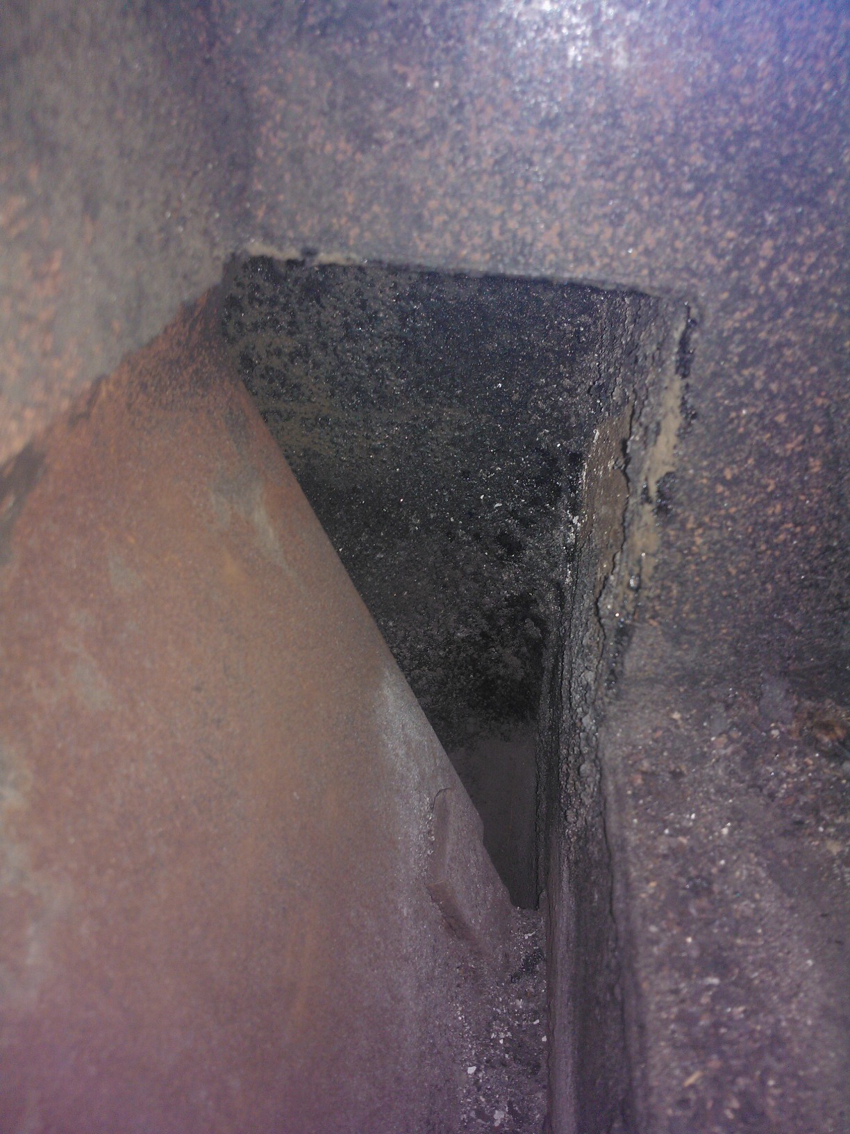

I think I'm going to go with 6" for this reason. The exit of the insert is larger, but the opening to the exit is blocked by a plate that is mounted to back wall of the chamber at a 45ー to the top of the chamber (closer to the front of the chamber on the top). This plate prevents looking straight out the top of the insert and creates two opening to the exit that are triangular shaped 4"x7", so the two openings when combined equal a 4"x7" rectangle with a area of 28square inch just like six inch round pipe.

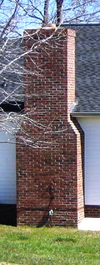

Would you insulate a liner in South Carolina note the existing masonry chimney is an exterior chimney see attached pic.
/ Fireplace Insert #13
No need to insulate the inner pipe or run double wall pipe. I've seen some flexible stainless steel stuff that can be snaked down the existing masonry chimney and past the damper assembly/smoke shelf. Then an adapter sits on top of the fire box to adapt the new pipe to the square opening. This can be crude, but must not interfere with the insert's damper.
At the top there is another plate the closes off the opening around the new liner and has a rigid pipe extending up a ways to accept the new cap. This can telescope over the flexible pipe. Finally a top goes on. You might need to seal around the top plate with concrete. The top can be round with a spark screen or it can turn in the wind to help the draft. The simple round ones are better if there is no draft issue, and I don't think you'll have any trouble with yours.

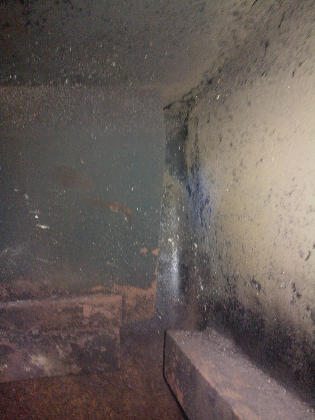

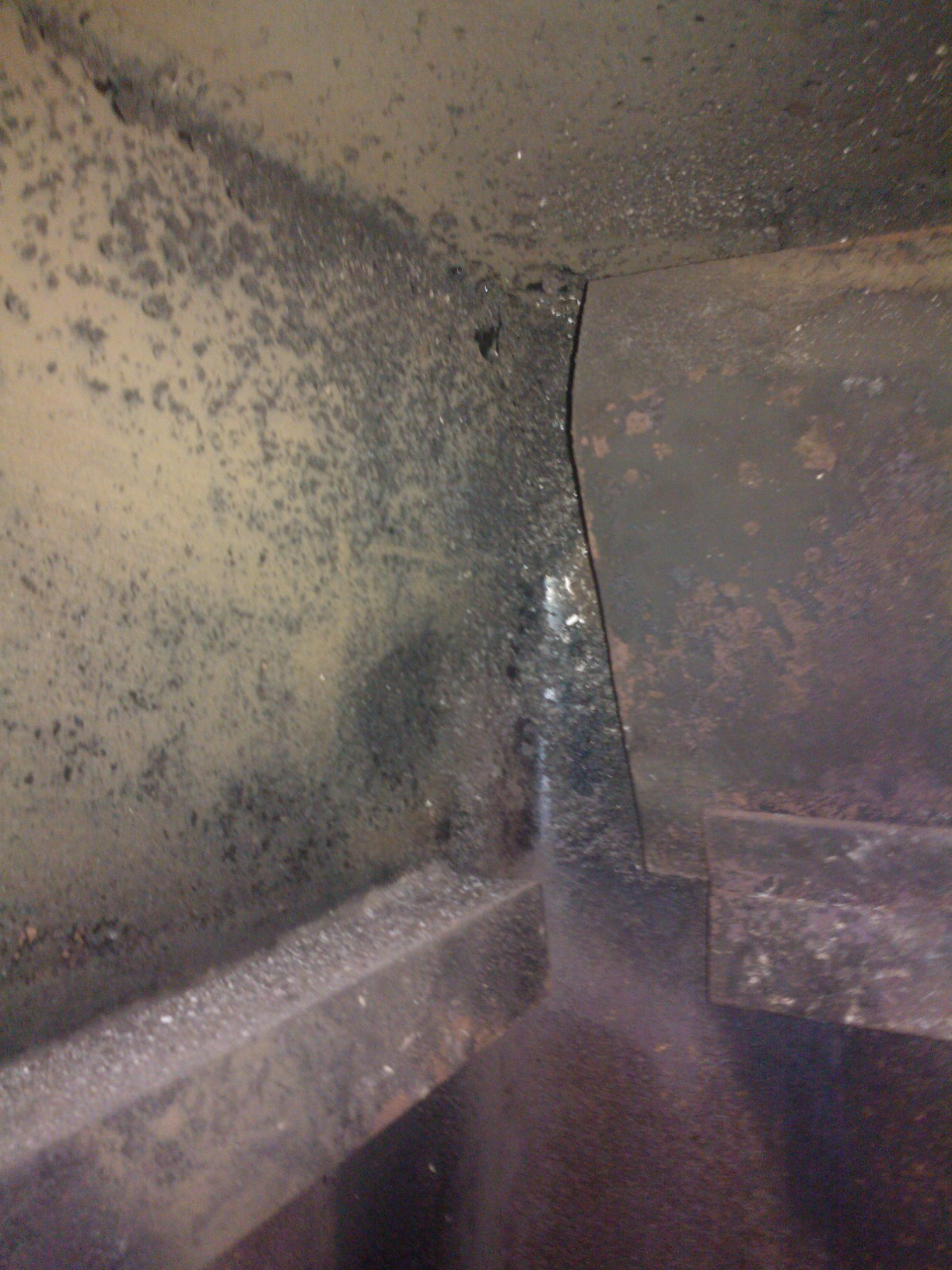

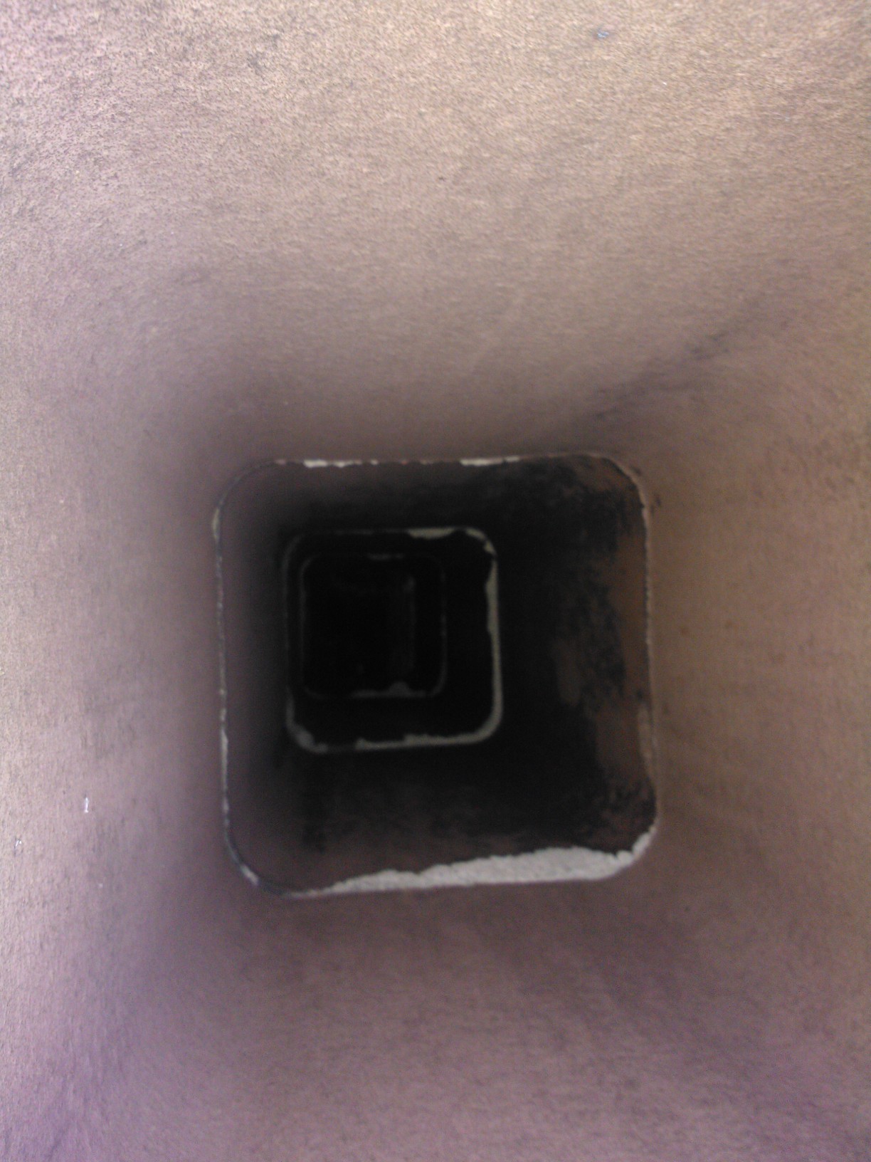

Here is some measurements of the insert and pics.
Door opening 13"x20"
Firebox width 23" minus firebrick
Firebox height 20.5" minus firebrick
Firebox depth 18" (front to back) minus firebrick
Firebrick thickness 1.25"
First pic is looking down through the insert's flue opening.

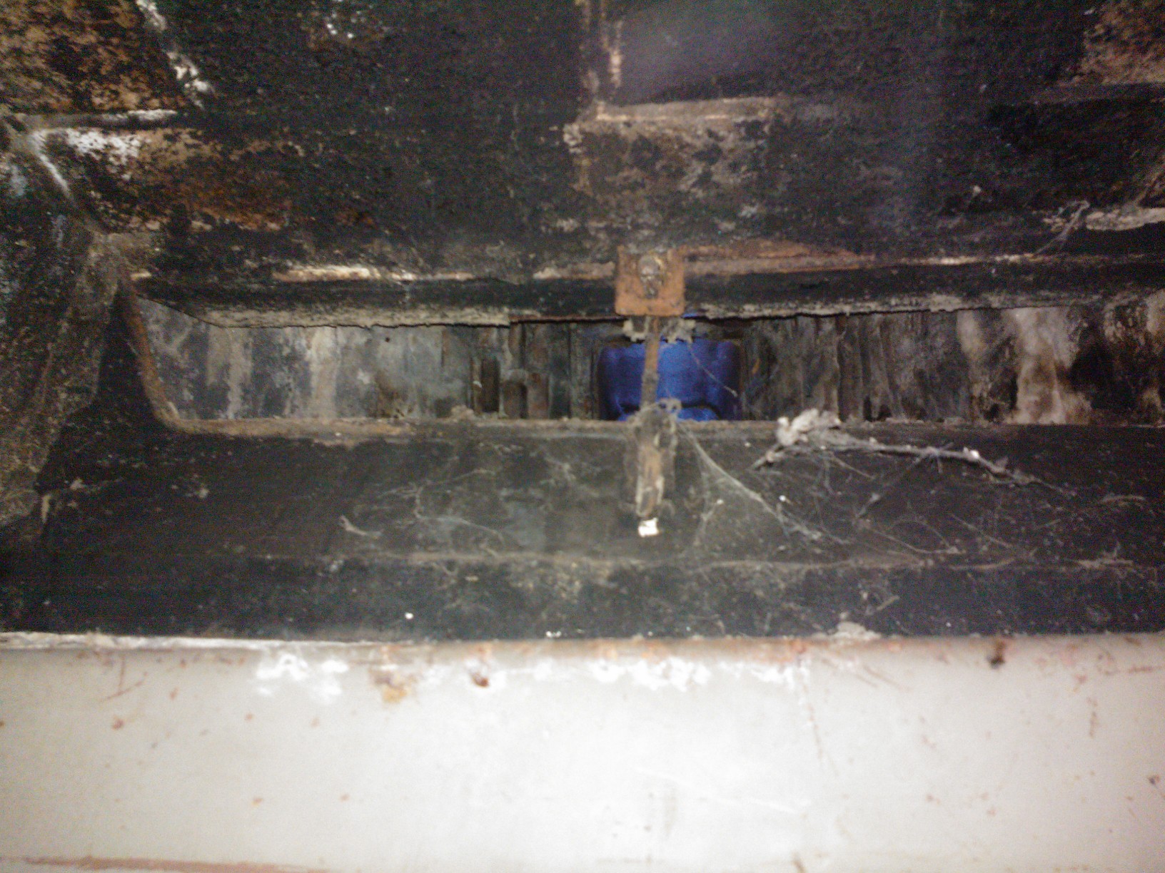

Here are a couple of pics of the inside of the chimney from top looking down and up through the damper.
