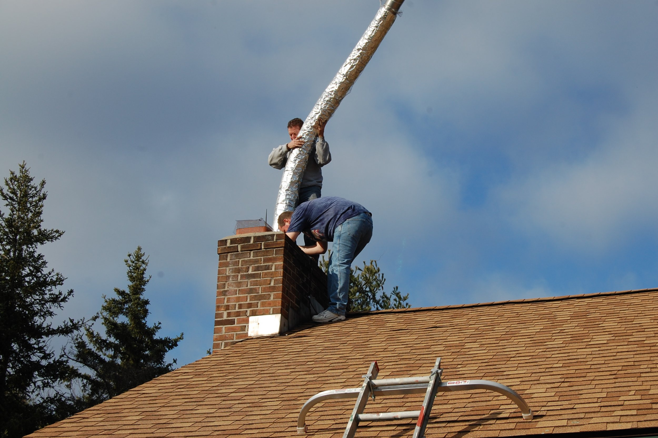

I installed my stainless steel insulated liner when we bought our fireplace insert. House is a ranch and chimney is about 18' tall. Was not difficult. Hardest part was feeding it down the chimney from the roof as it does not bend easily. If you have easy access to the top of the chimney it is not too bad. Make sure you have clearance at the flue damper opening for the diameter insert you have. I had to use a grinder to cut away the damper frame. Removing the damper door was easy, but that only gave us 5" clearance for a 6" liner.

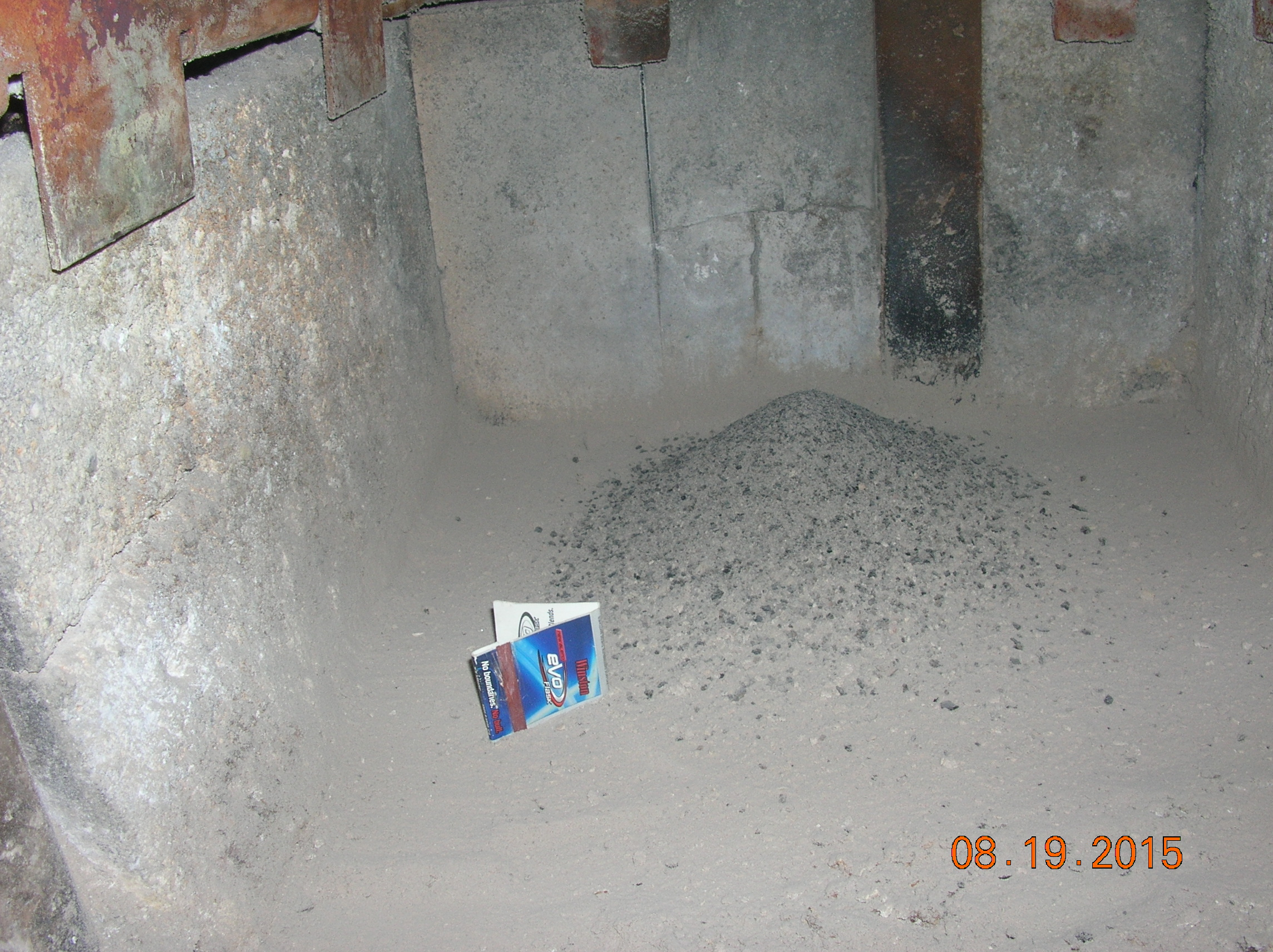

I installed a DIY chimney liner. Installed a 6 inch insulated SS liner into a 8 inch square tile. The old insert was just sealed to the bottom of the smoke shelf. The insert / liner draws better and the liner eliminates sharp turns that accumulate ash. I did and recommend installing SS flex liner with aluminum clad ceramic insulation, covered with SS wire mesh. The mesh protects and holds the insulation to the liner. Also, make sure to have a rain cap to complete the install.
With 20 years of use, burning about 4-5 cords annually , I only clean it every three years. Use a nylon brush. A steel bristle brush will poke holes in the SS liner.
Here's 3 years of ash
