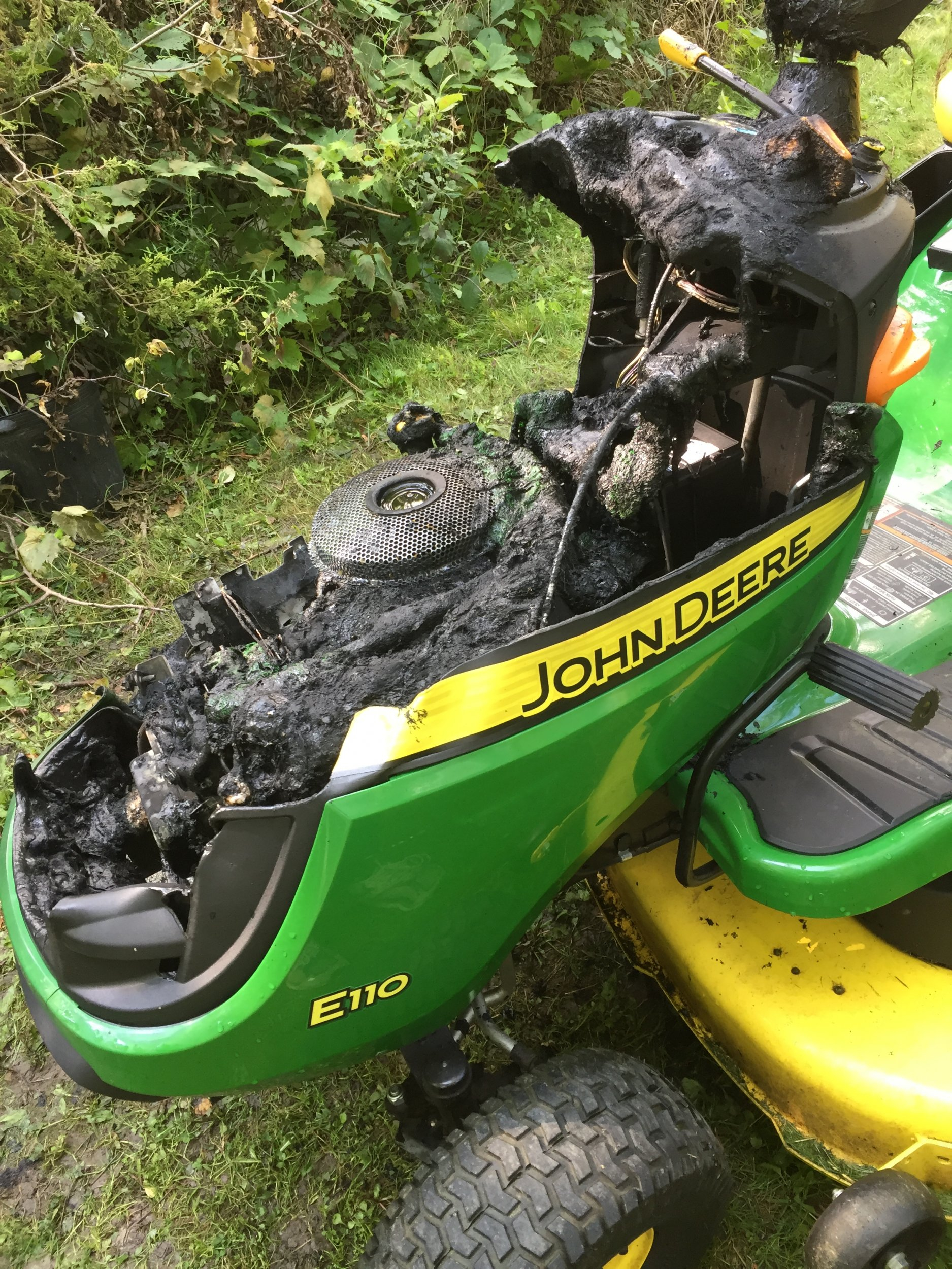

Well it happened to me too.
Still don’t know the reason why. It started in the front near the exhaust. But it didn’t have any electrical issues or gas leaks. It was the first time we mowed my daughters backyard. It wasn’t that big a yard 60x45 feet. The grass wasn’t that long. It only took about 1/2 hour to complete the lawn. Put the mower in the shed, then 10 minutes later smoke coming out of the shed. I ran to find 7 inches of flame coming out of both sides of the front hood. I pulled it out of the shed. Was too far from the water hose. Couldn’t find the fire extinguisher. So buckets of water finally put it out
More pictures here: John Deere E110 on Fire
